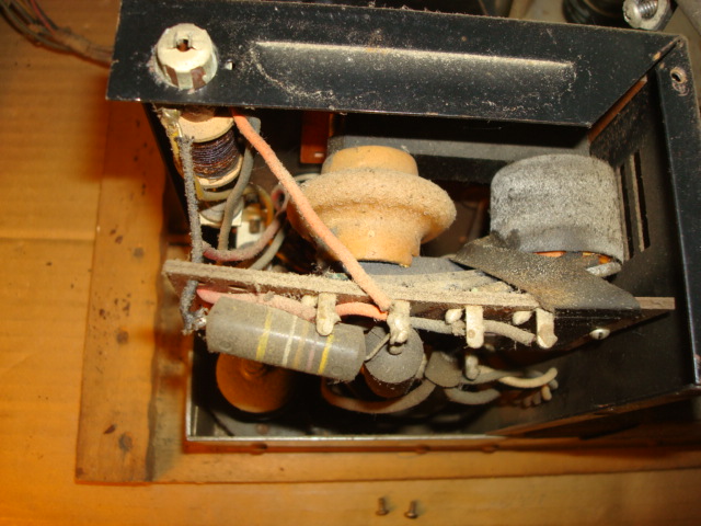

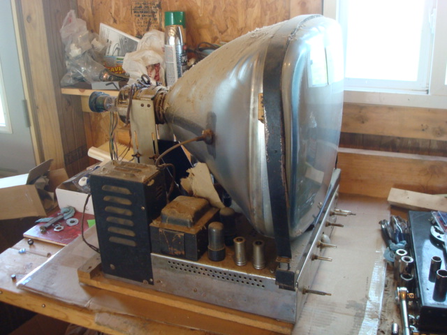

Here is the selected project, the Craftsmen. I need to check to see if I have the Sams on it. Looks like the correct tubes in the correct sockets exc a 6SL7 in place of a 6SN7 vertical osc. From the looks of the dust, nothing has been disturbed. Under chassis about the only thing I see that has been worked on is the power switch and rectifiers. The rest looks original. Lots of "bee's" underneath. I can see a couple of the electrolytics have leaked a little. Good thing is that it looks like I can get to about everything pretty easy for a recap. Picture tube checked good, gun looks shiny.
I did a few quick checks. The cord was deteriorated so bad I doubt it was even plugged in in the last 30 years. The fuse checked ok and get 2-3 ohms at the cord plug with the switch on. I don't see any obvious signs of a power transformer meltdown. The flyback looks to be in good shape as everything else in the HV box. This was a "junk store" find, way back in a corner, $10. Figured it was worth that for parts, esp if the big tube was good. Sadly, the cabinet got sold and the knobs were no where to be found. I am sure was 'repurposed', probably a dumb aquarium. They said it was a beauty. A day late and a dollar short. Well, at least I was able to save the chassis. It would only have been a matter of time until the neck got knocked off the tube. So, here begins the project. If I wreck it, it's just a chassis. If it lives, then it would be a pretty interesting piece of history.

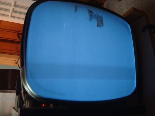

I did a slow power up without the bulb in the circuit. It was dropping the current enough that nothing would work. I monitored the current and it was in the 1.5 amp range. I could get some static in the sound, hear the vertical running and the horizontal, but it seemed a little upset over something and I only had about 2kv on the high voltage. I did some checks around the horizontal and damper and found the voltages close enough. So I did a test on the HV tube and found it dead. I found one in a junk box and it at least moved the meter on the tube tester so I put it in and this is what I got:
I have about 14kv on the meter now. No video or sound. Flashes when I change channels. I think this is a split carrier set, so I'm betting something in the tuner. Typical vertical sweep issues. That's as far as I got.

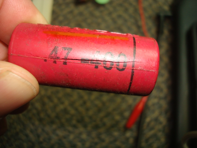

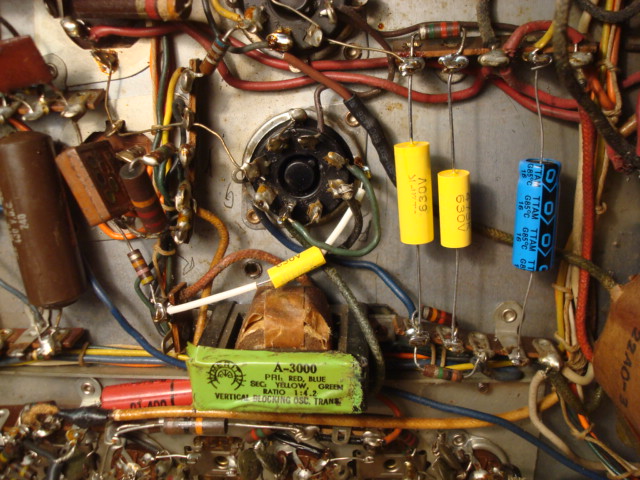

I recapped the vertical section and found one cracked. Now I have full vertical sweep. My B+ is still a little low. I haven't gotten to the power supply recap or rectifiers yet. I did the horizontal and video sections, but didn't get any change. Still no video/sound. So, I need to get more caps ordered.

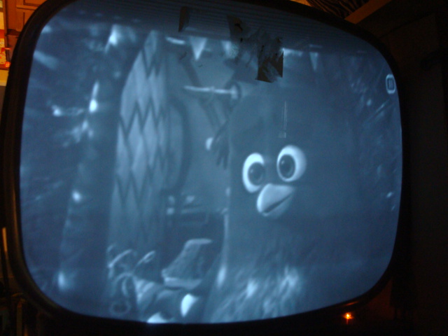

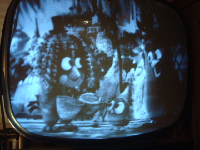

I have made "some" progress. I am in an area where things are not listed in the schematic. It looks like these TV's had had some changes that aren't documented very well. The vertical section has been upgraded and follows the RC201. The rest is kind of a mix, so I have to follow 2 schematics, which of course, component ID numbers are all different. I changed a big electrolytic and small paper cap and the B+ came up some. I still don't have any video or sound from the antenna input, so as a test, I injected a video signal into the 1st video amp 6AU6. I was able to lock the vertical, but the horizontal was a little more difficult. I did manage by turning up the "drive" , but the hold control is at the extreme end of travel. Here is what I got:
I wouldn't be surprised if this is the 1st picture that has been on this screen in over 50 years!

It's been some time, but I have finally felt like getting back into the radio room and have been working on this TV some more. I got the E caps restuffed and back in. I'm looking at the old rectifiers now. I should replace those with some diodes. Any thoughts of dropping resistor(s) or just solder in some good heavy diodes? I'm open to suggestions on this. I'd like to get that done, then gonna power up and see where I am before moving on to the next section. I have a heavy bridge, but don't know if that will work either.
