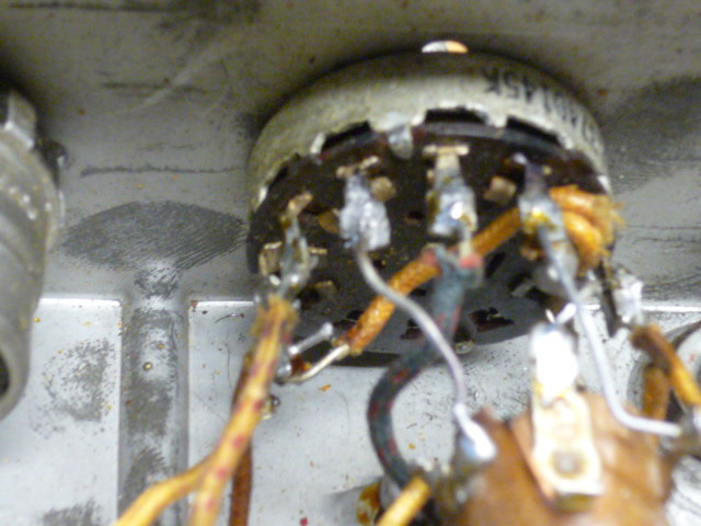

I have Vol VIII but can not find the info in my volume but I took a closer look at the band switch and the phenolic wafer looked warped so I pressed against it and started receiving. It looks like a tone control except for the back which is phenolic but they do not have enough tabs to keep it straight. I will have to figure a way to compress it slightly and permanently. Thanks for the help.

Ugh, I dislike that type of band-switch, very, very fragile. The solder tabs are hardened, any flexing and the tab will break off. Look carefully at the wafer and the metal housing. There should be three or four tabs from the housing that clinch the phenolic. The phenolic is accurately notched to accept the tab if it has been properly aligned. It looks like the one visible is slightly offset... I would not try to correct that as the phenolic could crack or the tab break.
To make a permanent fix and YMMV, cut off all the wires, attempting to de-solder in place will either cook the phenolic or break the tab. Take copious notes, of connections, take a couple of pix in addition to the one posted. Remove the switch, find a small clamp or large jaw pliers, back up the front of the switch so not to mar it and distribute the force, gently close the all tabs tighter on the wafer. De-solder all the solder tabs, remove all the wire bits. Rinse, even soak, the switch in 91% alcohol, that will remove all rosin that has crept over the phenolic. If you have some De-Oxit, spritz a bit inside the contacts and use a light machine oil on the bushing. Manipulate the switch at least 50 times, even 100. Check the continuity of all contacts in both positions. Set the meter for high resistance and check for dis-continuity on all switch positions as well as between poles.
Reconnect the switch...
If the switch is ruined, the schematic seems to say it is a multi-pole two position, these are easy finds, question is is it non-shorting or shorting. A meter will say.

What I did was to bend the tabs in slightly and that seems to add enough pressure be make good contact. It took very little pressure on the phenolic to make contact after I focused on it from your post.
