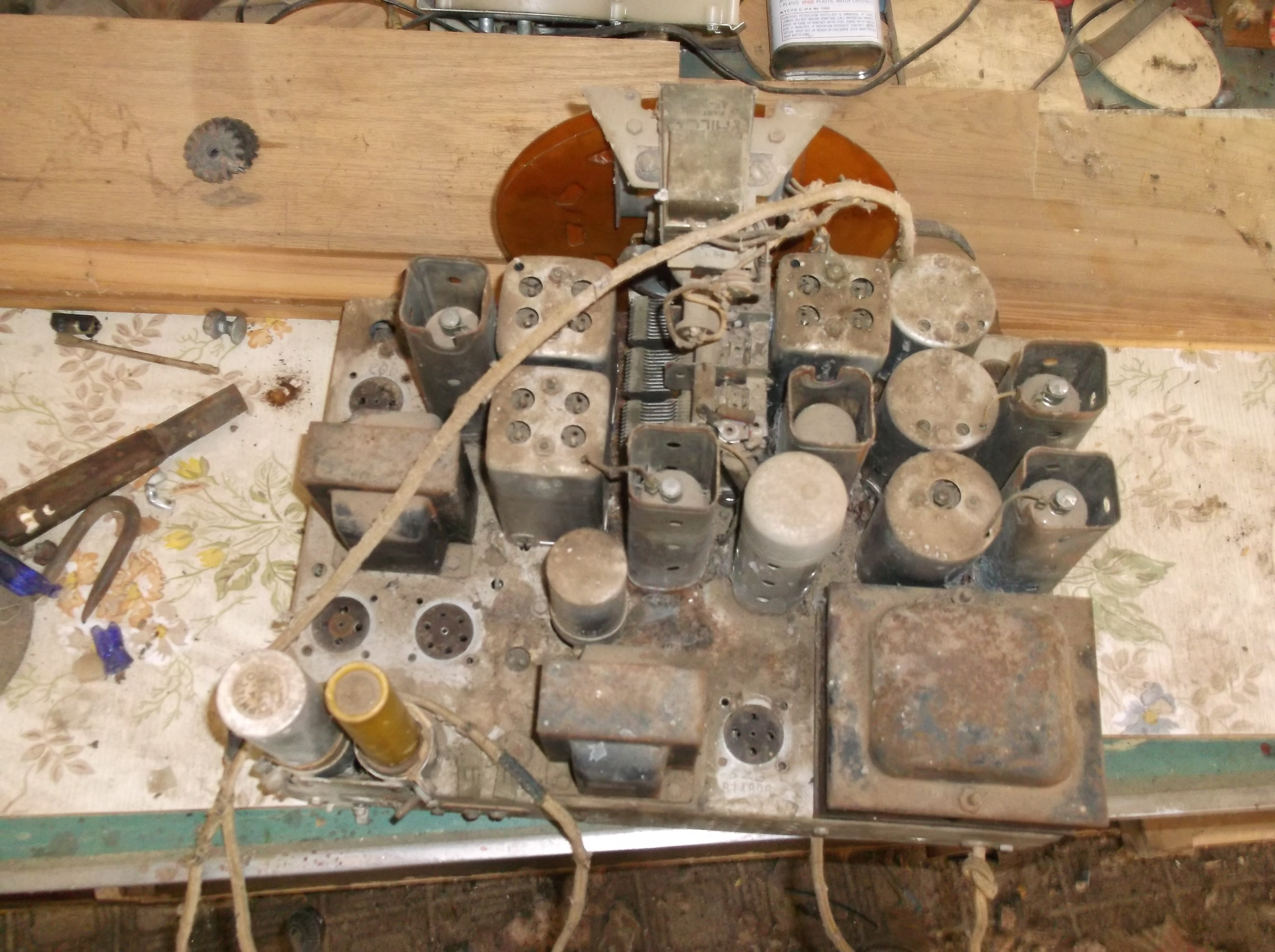

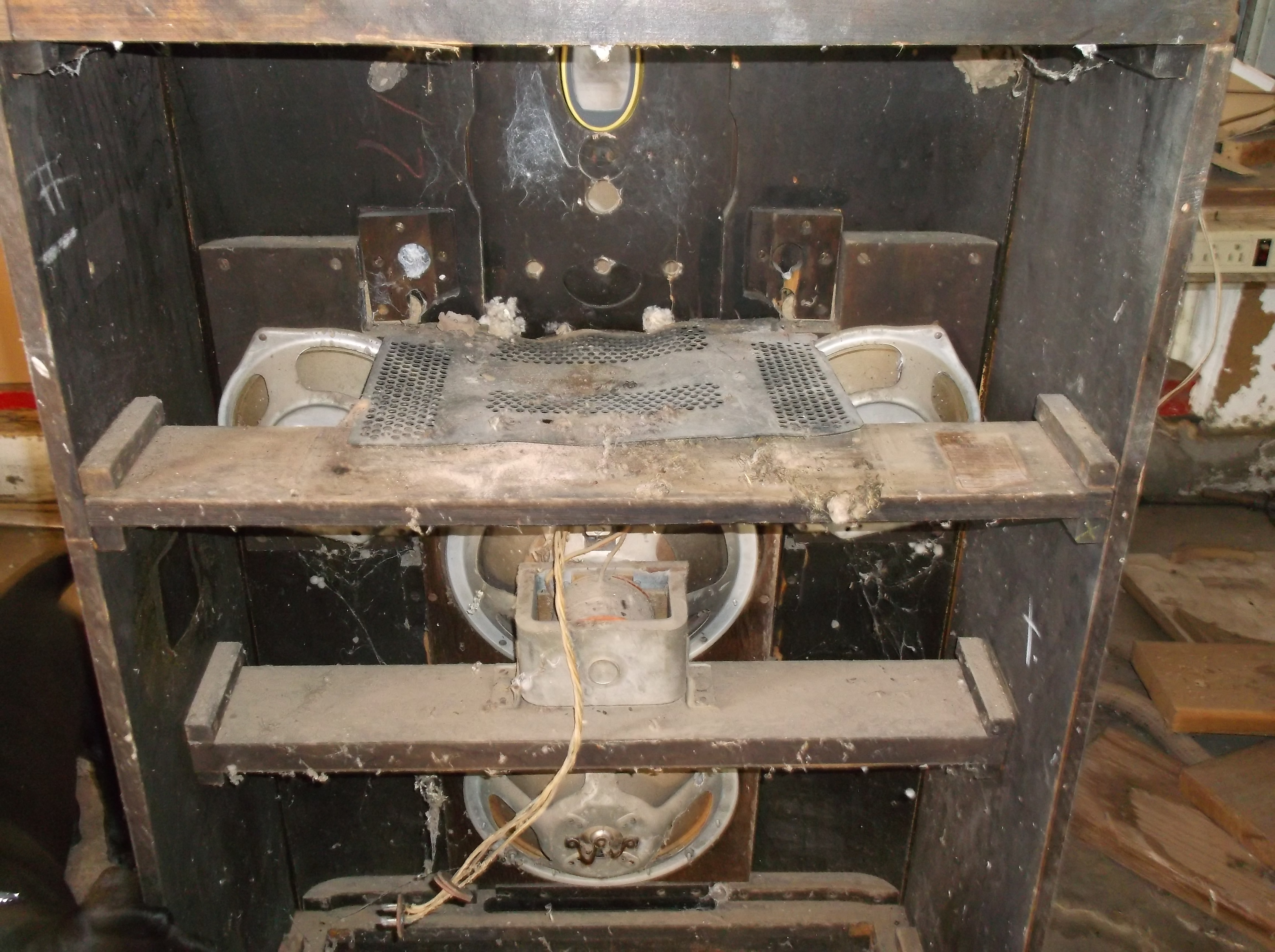

update: rainy day today so I pulled out the philco into a Place I can work on it. some good new is the cabinet is is great shape shape from what I can tell but the not so good news is that the bolts that hold on the radio to the chassis are gone so it seems that someone attempted to fix it and failed so it was parked. also I didn't think mice would like to live in a radio but I was mistaken. there was a nest in there so I imagine a lot of internals have been chewed. no pictures because I forgot my camera

Bob you might get lucky on lots of damage caused by the mice. I have ran into 5 or 6 radios with mice nests and the damage they did was not too bad. Lets hope that's the case here.
Their urine is been the biggest cause of damage I hated dealing with.

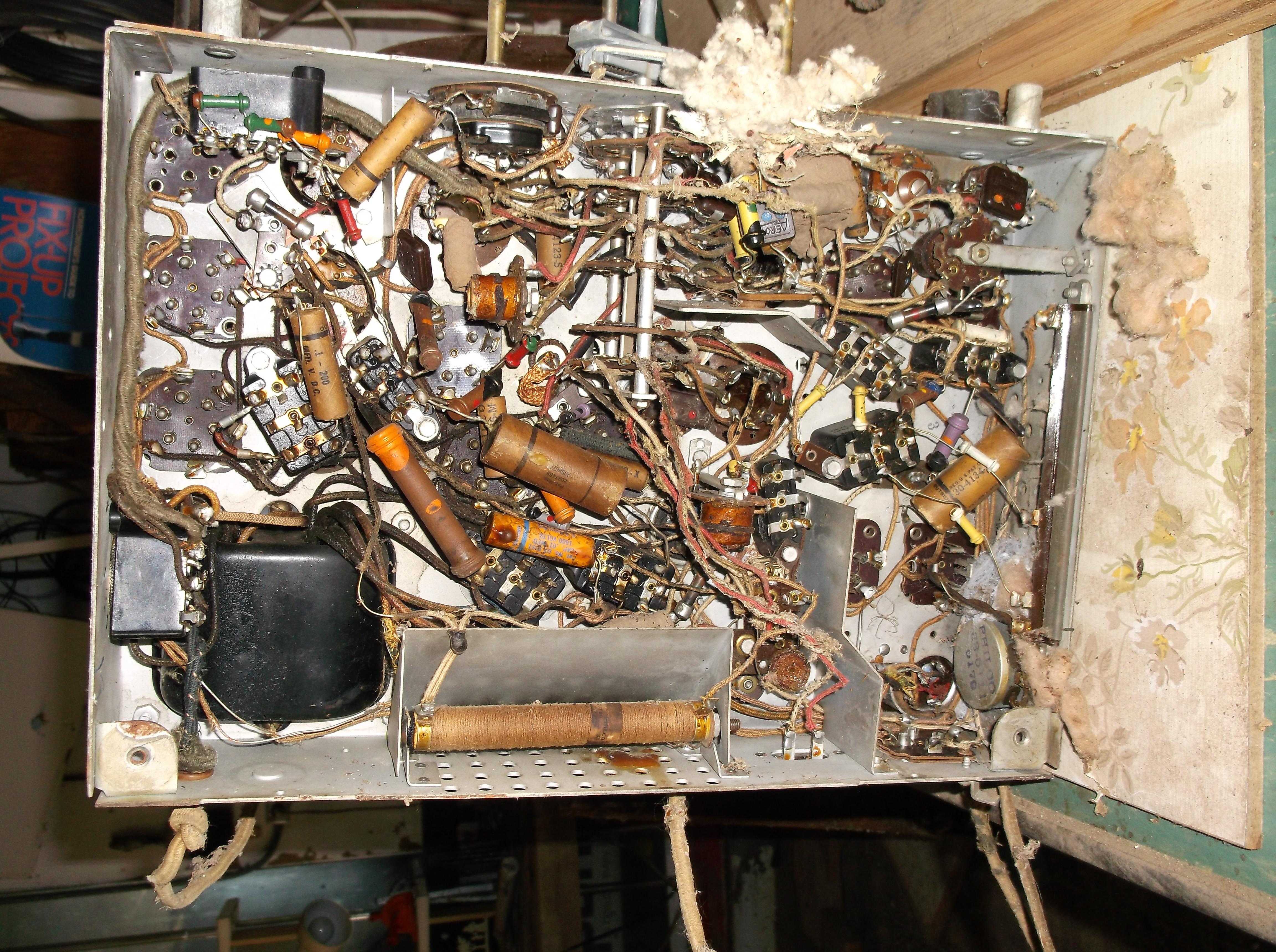

>also how can you test capacitors? do check it with an voltmeter?
That's an easy one. If you disconnect it and throw it in the trash can and it makes a noise it's bad. They are not worth the trouble to test only to find they are or very soon to be bad. Better to replace. There are two different types of fixed non polarize caps in this set, mica and foil/paper. Generally the mica holdup well over time and are still good after many years. On the other hand the foil /paper not so much and can cause lot of problems. These would be the tubular type they are brown w/a black band around one end. I see about 7 or so just looking @ your pic.
Those black things w/the terminals have one or two inside. And then are 3 electrolytic can type caps which have 7 individual caps inside.
