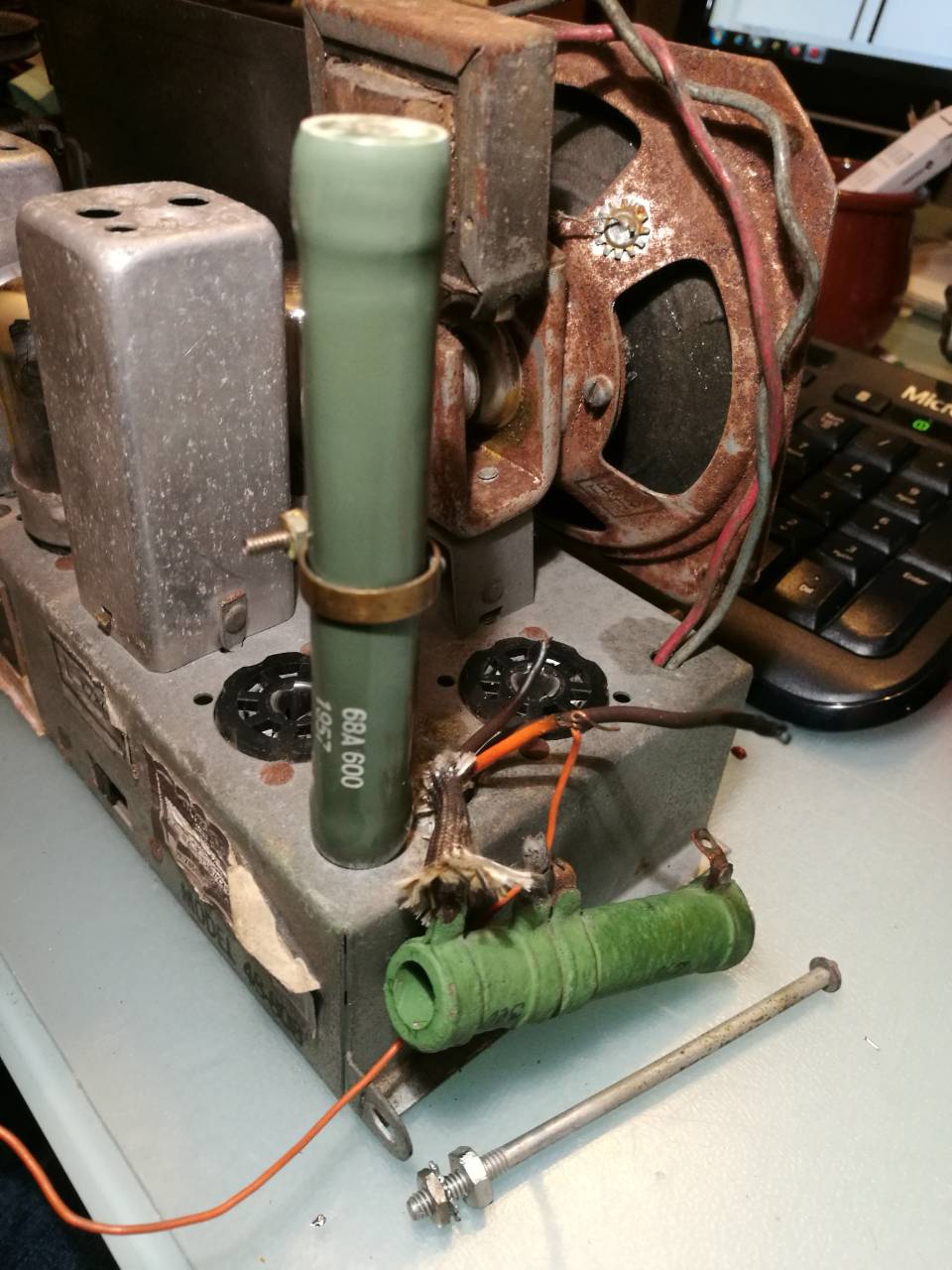

Model 48-808, C201 looks like a resistor
I did get it, thanks!
Just need to find a way to secure it on the chassis as it is longer than the original.
I still have to use the surviving part of R100, so a little fabrication is due.

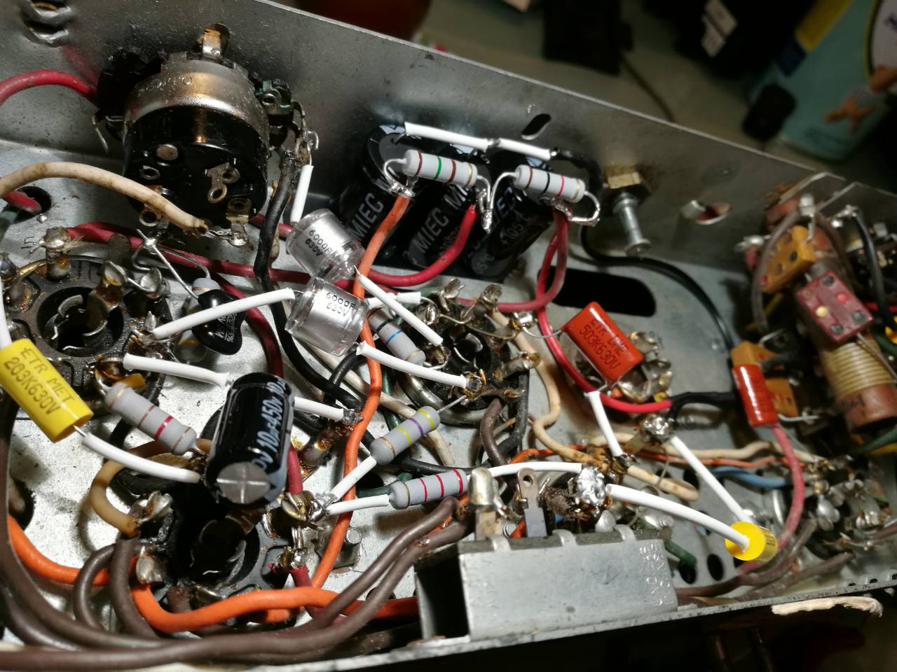

It's been some time but there has been some progress.
I left the capacitor can undisturbed and moved the 4 electrolytics to other locations. I also tried to leave original components as much as I could but they just crumbled apart as soon as I touched them.
Even micas had to go.

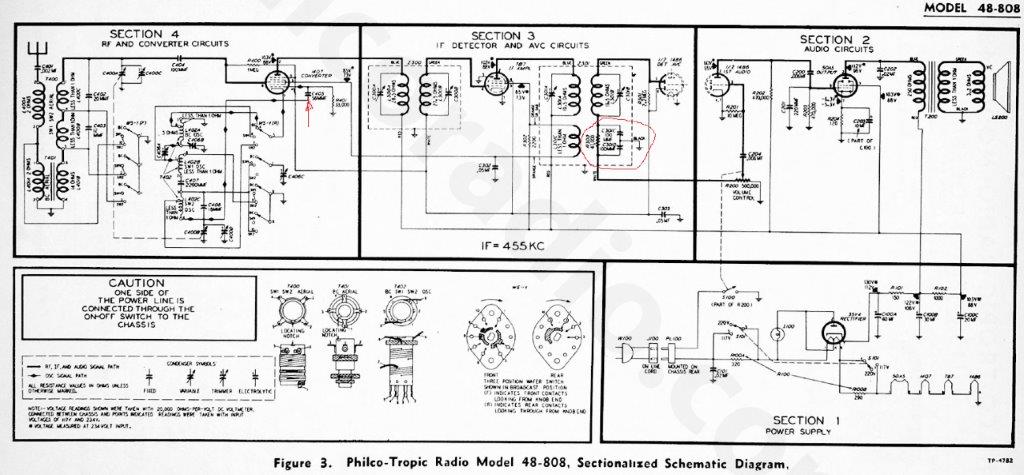

Hello! Hope everyone is OK.
So the tubes finally arrived.

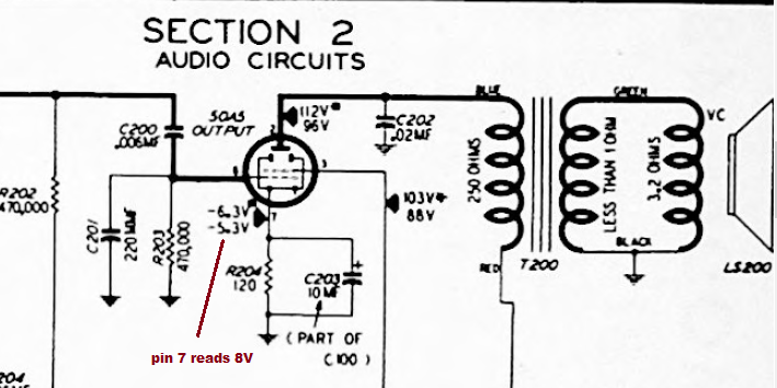

The set turns on but hardly produces any sound at all. The tuned station can be heard but it's very, very faint.
Voltages are similar to the ones listed in the schematic except for 50A5's pin 7. It should be negative but I read about 8V DC.
Also, 50A5's pin 6 should be 0V DC but I read 3V DC. Every component had to be changed as the originals crumbled away. I did test every component before installing, but who knows...
Any help appreciated.
Thanks.
JZ

Hi JZ,
Your fine. The cathode is going to be positive when measuring from the b- rail (- probe on the - rail). Note the ecap there if it was -on the cathode the cap wouldn't like it at all! If you connect the meter - lead to the cathode and the + to the control grid you will see the - bias voltage (the -6 or so).

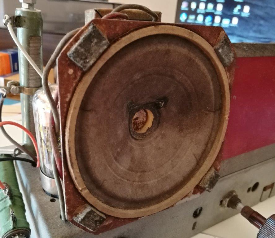

If you touch the grid pin of the 14B6 the spkr should buzz like mad. If it does I would go on to the alignment. If not you may want to check the spkr, the voice coil maybe rusted to the metal pole inside. This makes cone pretty much frozen in place.
Something that looks that good can't have much wrong!!!!

It looks like the speaker has had better days, so I'll start from there.

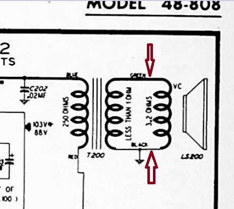

The output transformer has continuity on both sides. If I'd want to use a 4 ohm speaker to test, would I replace the current speaker on these leads?

Just an update, I used an output transformer and speaker from another Philco waiting its turn to be restored and the issue persists.
Sending a 600Hz sine signal through the output transformer makes the speaker sing so I'll be looking for issues from the aerial onwards.

  • the speaker does need replacement as it gets stuck if touched ever so slightly. I was considering a readily available 4'', 4 Ohm speaker that would need some fabrication to be secured to this chassis. I haven't found a similar period part online.

2- Regarding the speaker, a suitable replacement just couldn't be found. The speaker pole did have some rust on it, which was preventing the voice coil from moving freely. It was cleaned as best as possible with compressed air to the point that no further scratching would be noticeable. The cone itself had some tears that were addressed with speaker glue. It's working satisfactory, for the time being.
