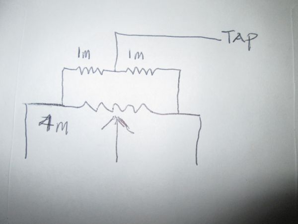

Looking to replace Volume Control on 38-9 Philco part # 33-5216 2meg with 1 meg tap. Anyone have one or perhaps any ideas or tips to replace? I pondered using a stock 1Meg and adding 1 meg resistor at ground and using that junction as tap connection. Yes I have sent Mark Oppat a message requesting one but no replies so far. If you have one available or ideas for substitutions please let me know. Thanks Todd
You can use an untapped 2 meg pot, just do not connect the wire going to the tap at present. It only affects the tone at low volumes. The radio will work OK without it. If you tried using a 1 meg, with a 1 meg resistor, you would not have the full range of volume control, and end up stuck with half volume to full volume, not what you want.
Or if you like experimenting this might give you some of the desired results.
Sorry was having a brain flatulent the 1m should be 2M

Just update, re capped and installed a plain old generic 1 meg audio pot and she works great. 2 out of the 3 tone control positions work. The only one that does not is obviously loudness tap off the volume control. So if anyone is in a bind this would work.
I am going to install a correct pot down the road but just an FYI the radio works great with a generic sub.
