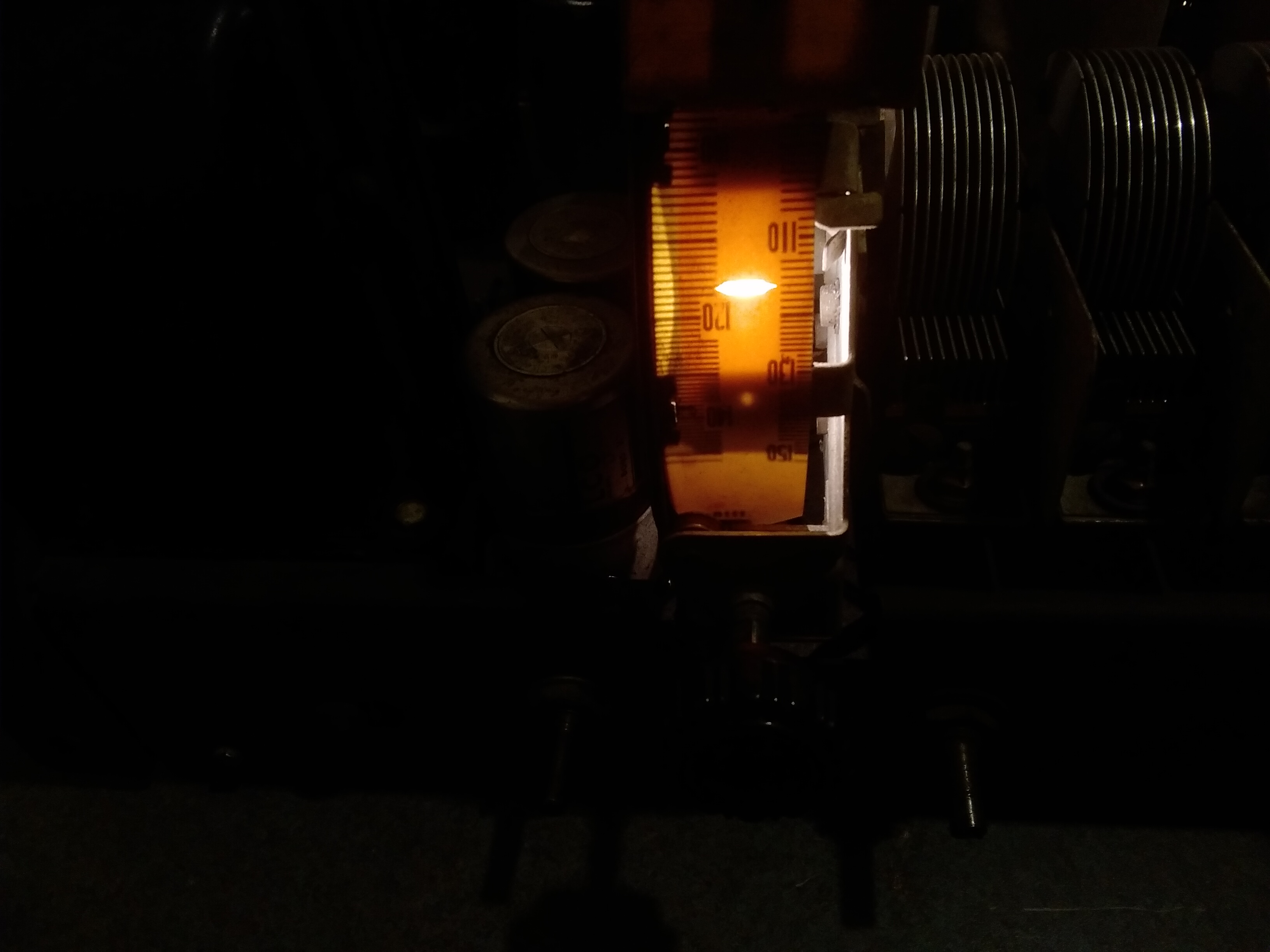

Aligned the set.
The procedure is well-hidden, but I unearthed sometging from the 89 Rider article.
Very simple alignment. Just IF (3 padders) and 1500 kHz. The lower frequency just aligned itself.
Now have to put it back together and clean up the exterior a bit.

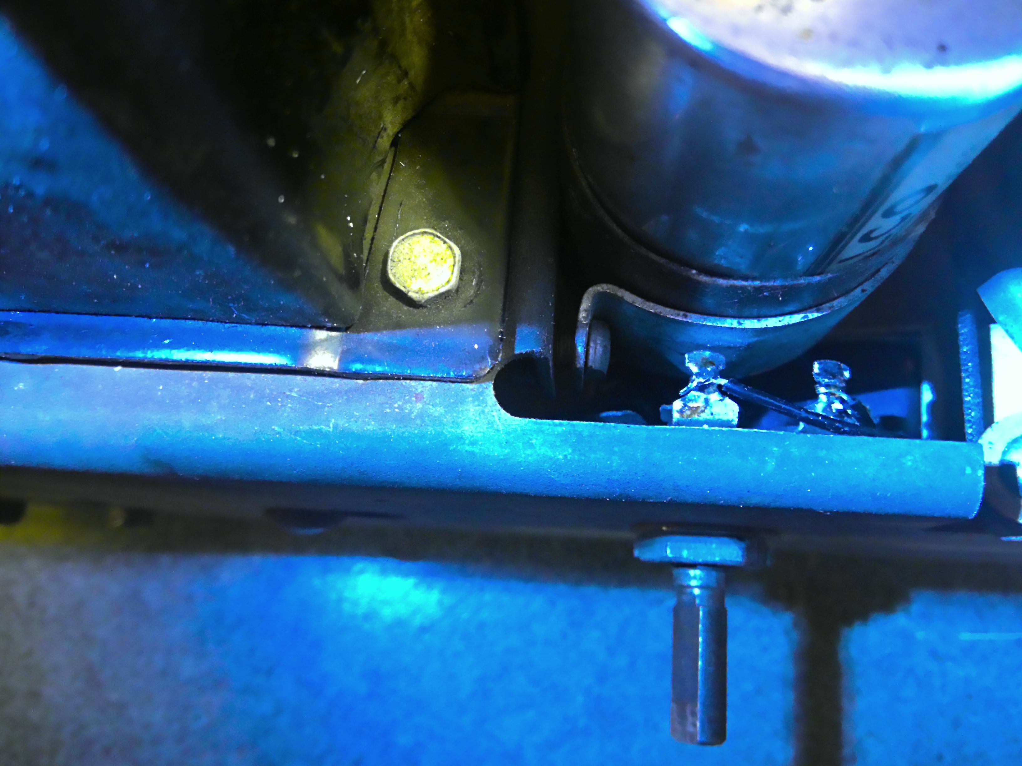

I took the picture of what I saw while giving the chassis one last look:
Remember when I said this chassis is ...tight?
Yes. This tight. The first cap of the tone control is practically touching the grounded electrolytics mounting bracket. And the voltage there is the plate voltage. Safe, as all it would result in is the first cap getting engaged. But....so I had to bend it out. It is possible the bracket got moved a bit when put back in place. Still too close.

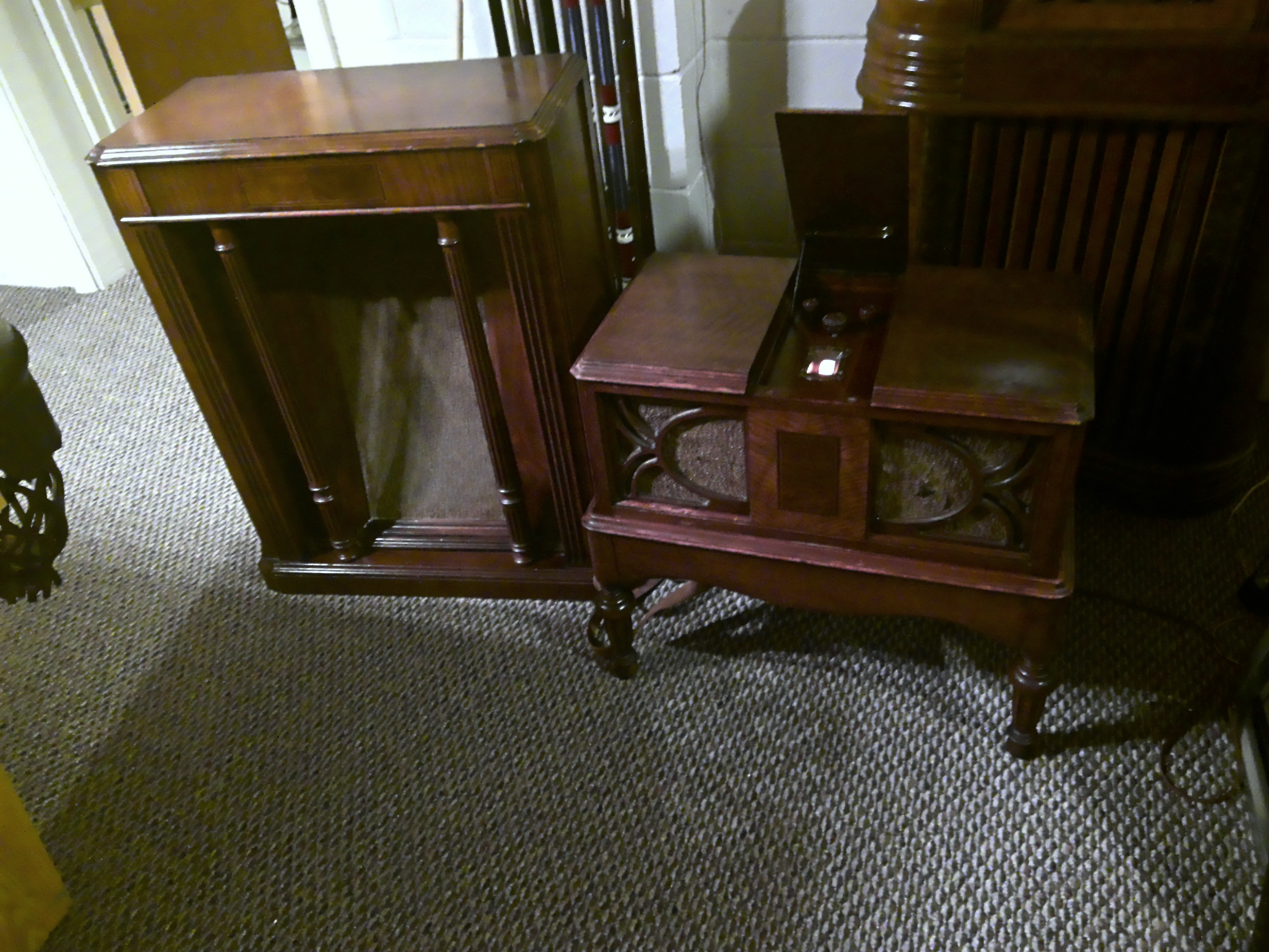

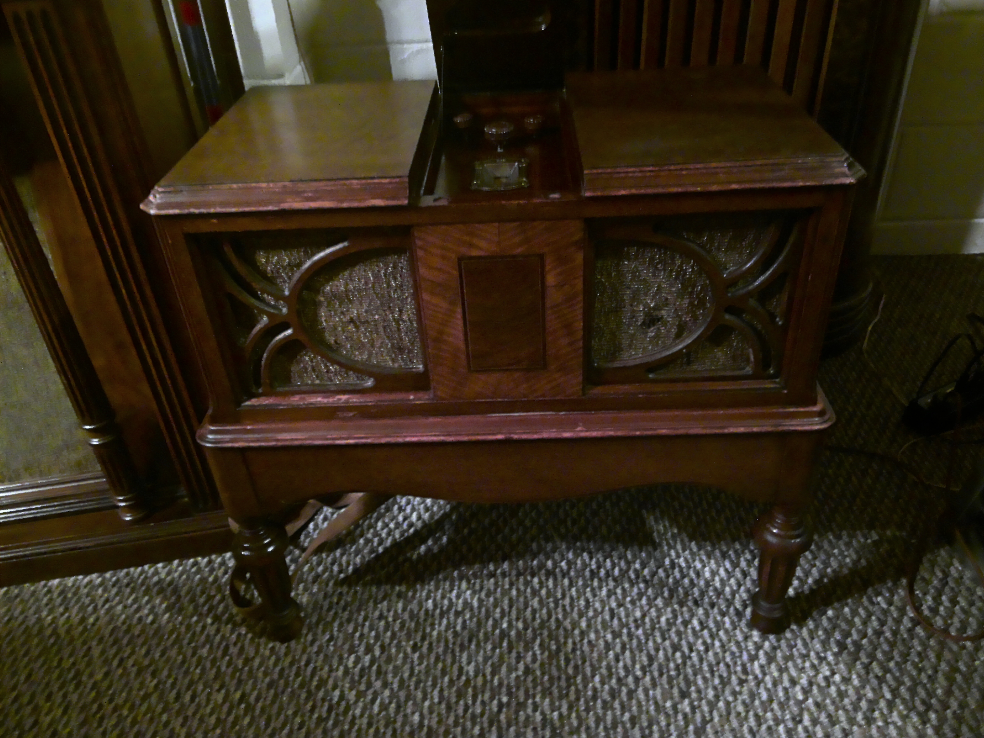

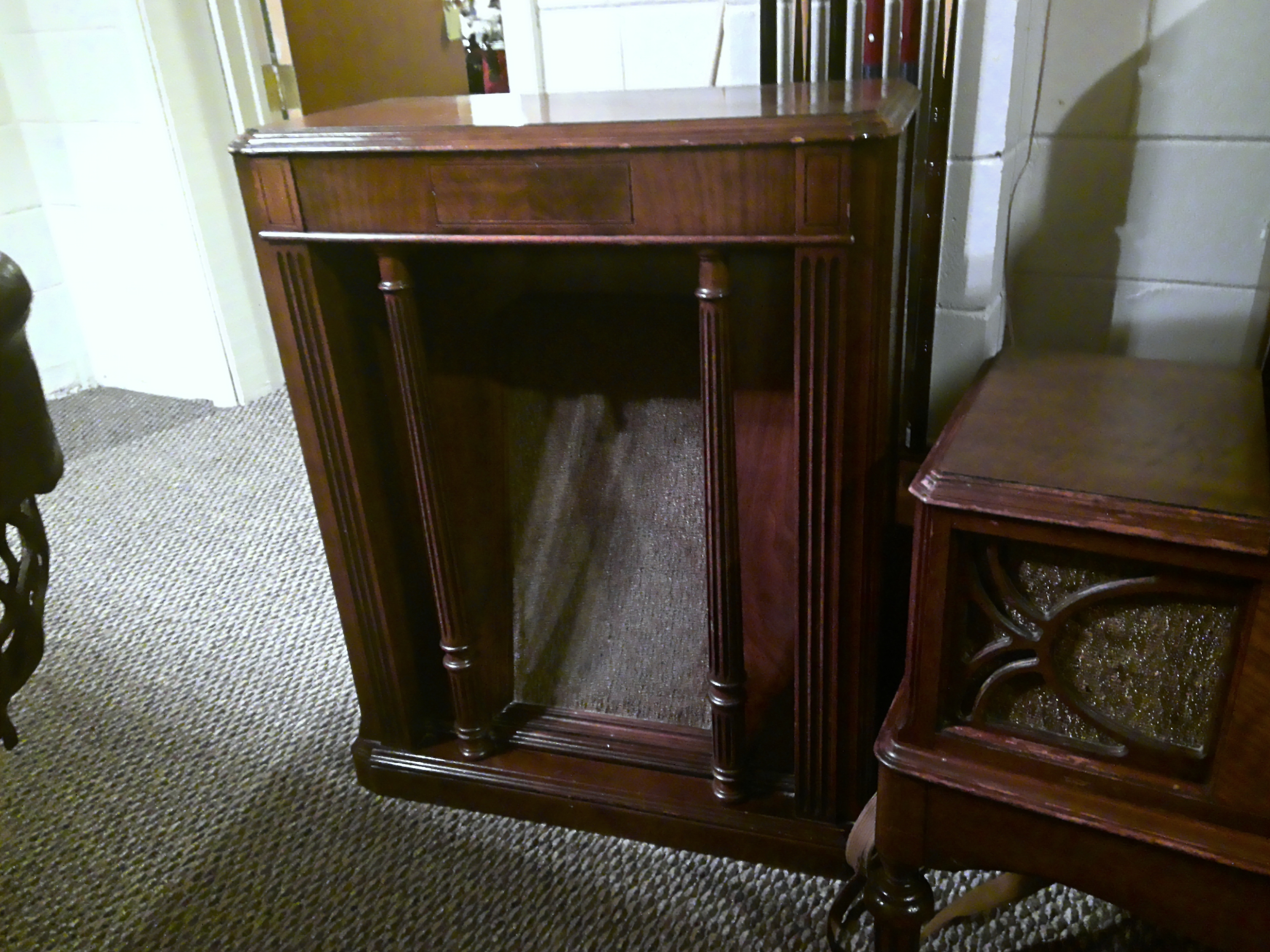

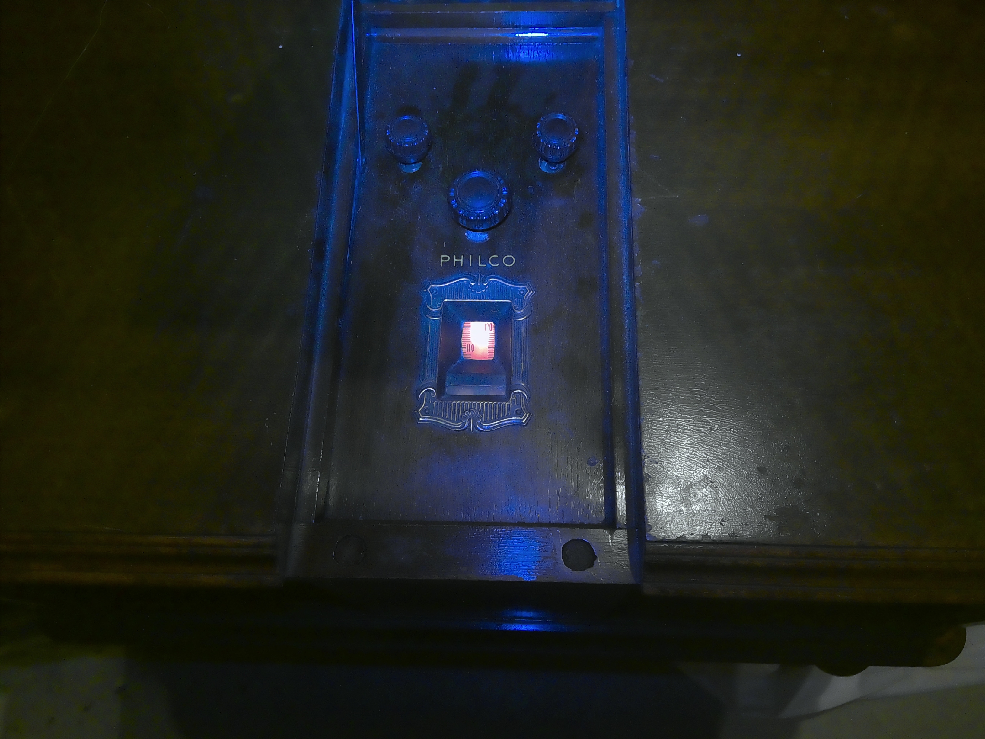

Well. I gave the radio cabinet GoJo wipe.
I made some pictures, but this is with the tablet and not a very good lighting.
This said, of course, the radio cabinet could use refinishing, though the speaker cabinet is fine the way it is. Not ideal but it looks decent to be preserved.
The sound is good. I like it. I took it out from my workshop to put with the general population. Too bad the space in my basement starts shrinking, and I do not think my wife wants it upstairs.
It will have to live in the basement for now.
It is no longer upside down.
This concludes it for now.
