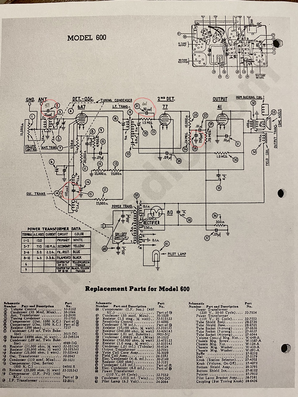

Hello guys, going through my schematic I'm finding that everything matches except for the mica's. I've read in other posts and watched videos of other repairs and most people leave the mica's alone. After testing them they are all out of tolerance, will probably replace them with the values that are in the radio rather than whats shown on the schematic. Just curious if anyone knows of a design change or something that might explain the discrepancy or have any other suggestions?

I think it's best if you stick with the values in the schematic, especially in the oscillator and 6A7 circuit.

How do you know what the value of a given part is? Are you reading the color code or marking on the part? Or are you using a capacitance meter to read it? Just reading it with a meter may just indicate drift not necessarily a change from the factory. It's not unheard of for a set to have service notes from the factory depicting changes. Agree with Rod go with stated values on the schematic if there are issues they can be sorted as it comes together.
The only one that I see that is fairly different from the original is the 510 mmfd cap in the osc. It's controlling the feedback for the oscillator. All the other seem to be pretty negligible.
I would very interested to read the resistances of the windings on the ant, field, osc coils, and the output transformer. Some of which look like they have gnawed on.

I have a decent digital mm that measures to nf and a Heathkit C-3 that is fairly accurate. Maybe I was reading the color codes wrong, so the mica in the oscillator circuit in my radio is the Aerovox with the 3 dots, Blue Brown and Yellow which would be 610uuf or 610pf or .610nf correct. The Heathkit measured the mica at 140uuf out of circuit. I never would have went down this path until I noticed the color codes not matching values on the schematic. I see I wrote the wrong number on schematic earlier, should of been 610.

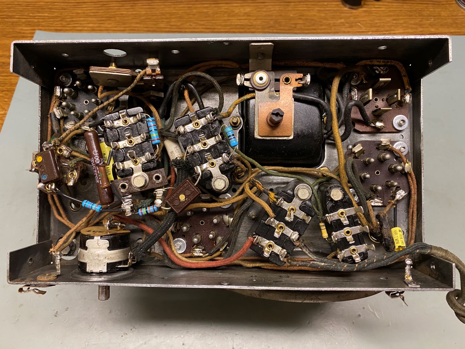

A little update on the Philco 600, I left the mica caps alone after reading what Morzh said "I am yet to replace one single mica in my radios." Thanks for the advice.

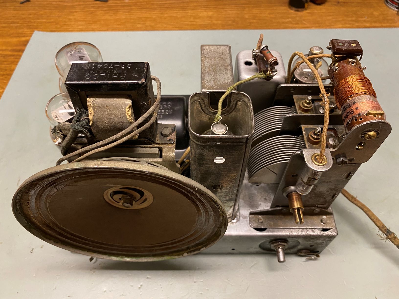

As you can see in the photo's it's a little cleaner, had to rewind the antenna coil it was chewed up really bad. Recapped and replaced all but 3 of the resistors. I replaced all the tubes except the 6A7, the 77 was missing, 41 had something rattling in the base and the 80 was cracked.
The radio works and seemed to align OK but when tuned to a strong radio station you can't turn up the volume or the radio makes an ungodly noise. The sensitivity control helps but at times you can't back it off far enough. Any ideas as to what might going on? I don't have an external antenna so just using a short piece of wire.

The second backelite block from the left, top rivet - there was something in it.....?

There was.... good find, there should be two .05uf inside

Was excited to fix my mistake and see how the radio would work so stayed up a little later last night. Got it back together and it sounds so much better, thanks again for spotting that.
