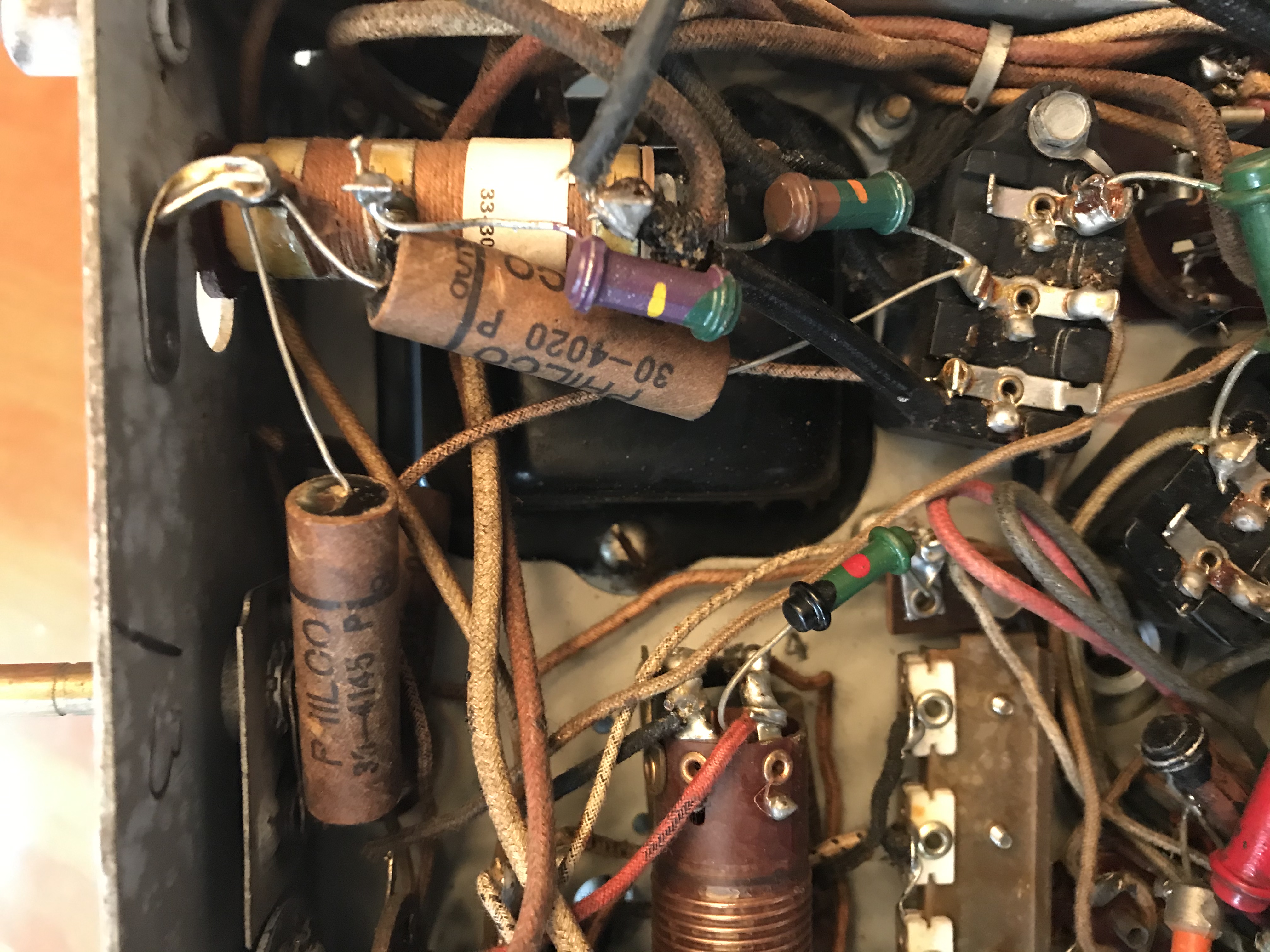

Pic 1 shows no #24 - 400 ohm flexible resistor and no 3rd tab on the #23 bakelite block to solder it onto if it is required. There is also a 30-4145 .05 mfd cap there that’s not on the schematic.

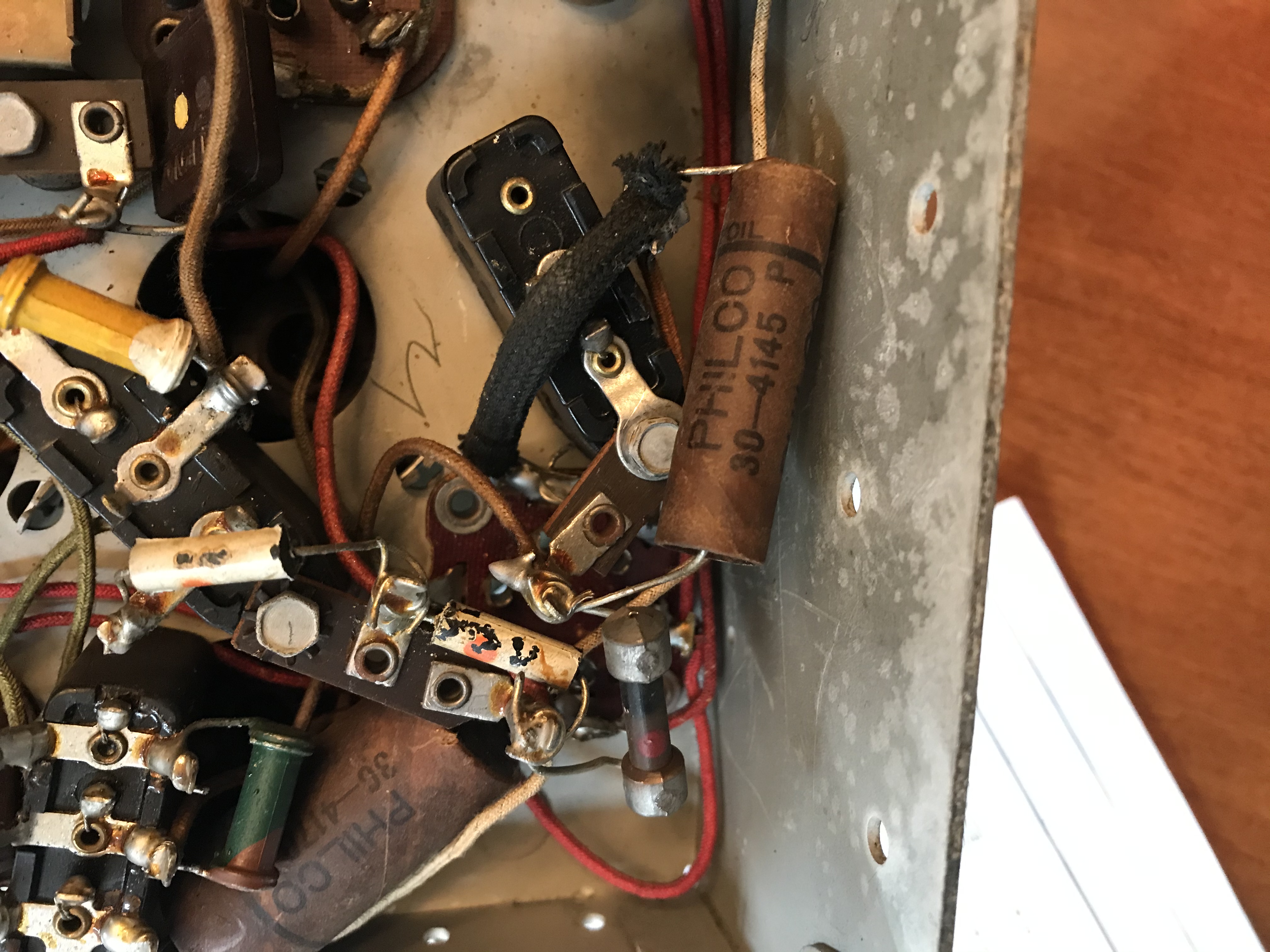

Pic 2 shows 3 caps that aren’t on the schematic - 30-4020 .05 mfd which goes from either ground or #57 wire wound resister to #36 condenser block, a 30–4145 .01 cap which appears to go from the tone control switch either to ground or the same #57( hopefully the photo clarifies to you all as to whether that is part of #57 or ground) and a 30-4113 .02 (you can’t see it in the photo, it is hidden under the 30-4145) which goes from the same spot on the tone control switch and is soldered to a wire that goes to a pin on output tube 42.

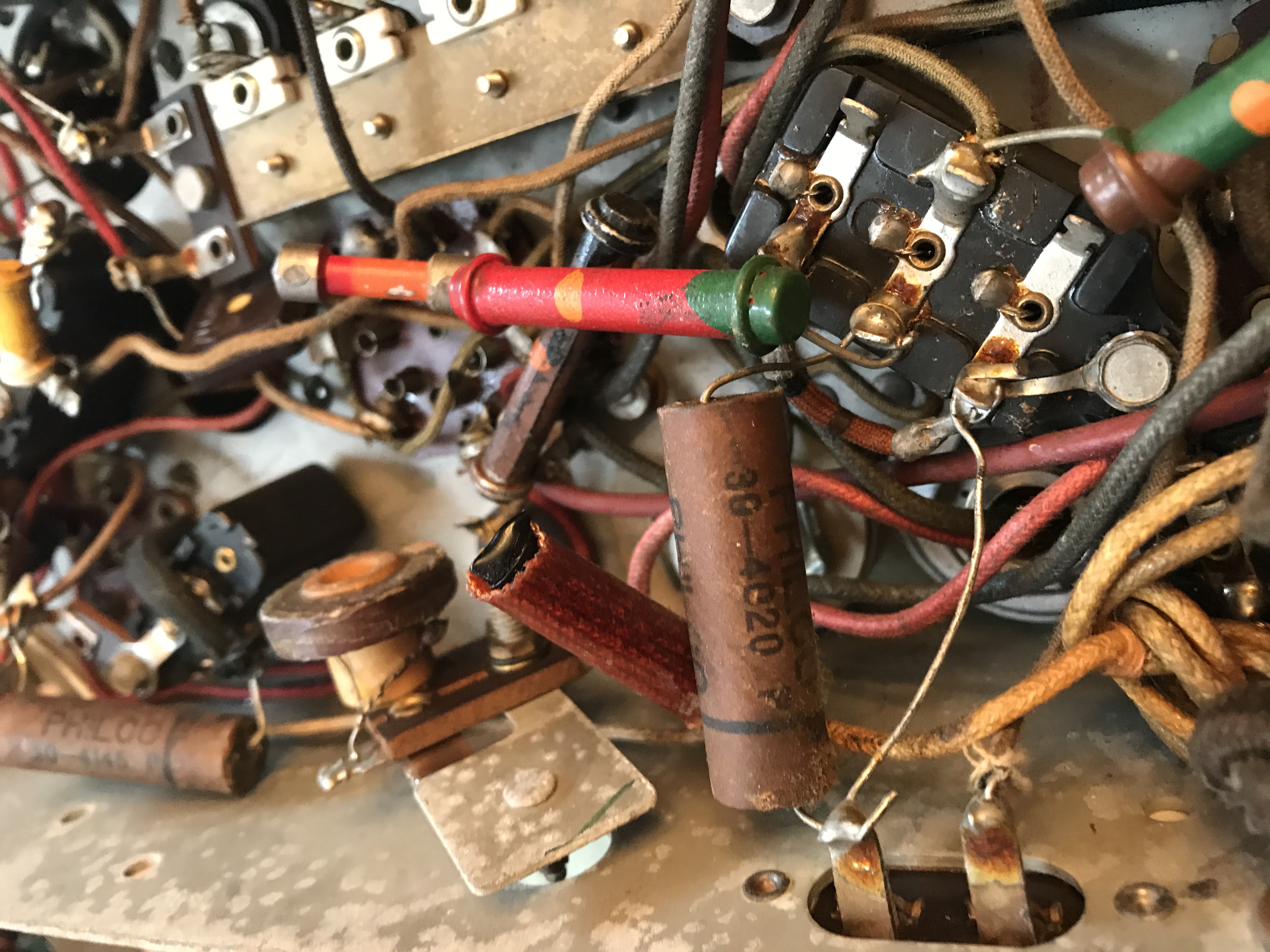

Pic 3 shows a 30-4020 .05 cap that again is not on the schematic. It goes from the connection for BLK antennae to the #15 condenser block.

You need to look at the back of the chassis or the label inside to see what revision (code) yours is. Then try to look at the schematic that is of the same code.
I found this old thread that has a link to some change info for the 610 - https://philcoradio.com/phorum/showthrea...hlight=610
I just finished a Philco 620 and found differences from the schematics.  In reading other topics on the phorum, it seems it was not uncommon for Philco to make changes that weren't always documented.  If what you see looks like an original manufacturing installation, I would duplicate it with a new capacitor, resistor, etc.  However, I'm not an expert on this; just a newbie plus 5 years.
Larry, you are correct about changes made that do not always show up on the schematics. One can often find them in service notes. The Ryder manuals often have them in volumes subsequent to the original one in which the service information for the radio appeared. All the references can be found in the master index. You are right about, "If it looks like an original part, just replace it with a new one of the same marked value. That's what I do too when there is a discrepancy if I cannot find the information on a change in the service notes under changes.
Thanks for the advice, i will replace all of the existing parts as they are now and see how it goes.
