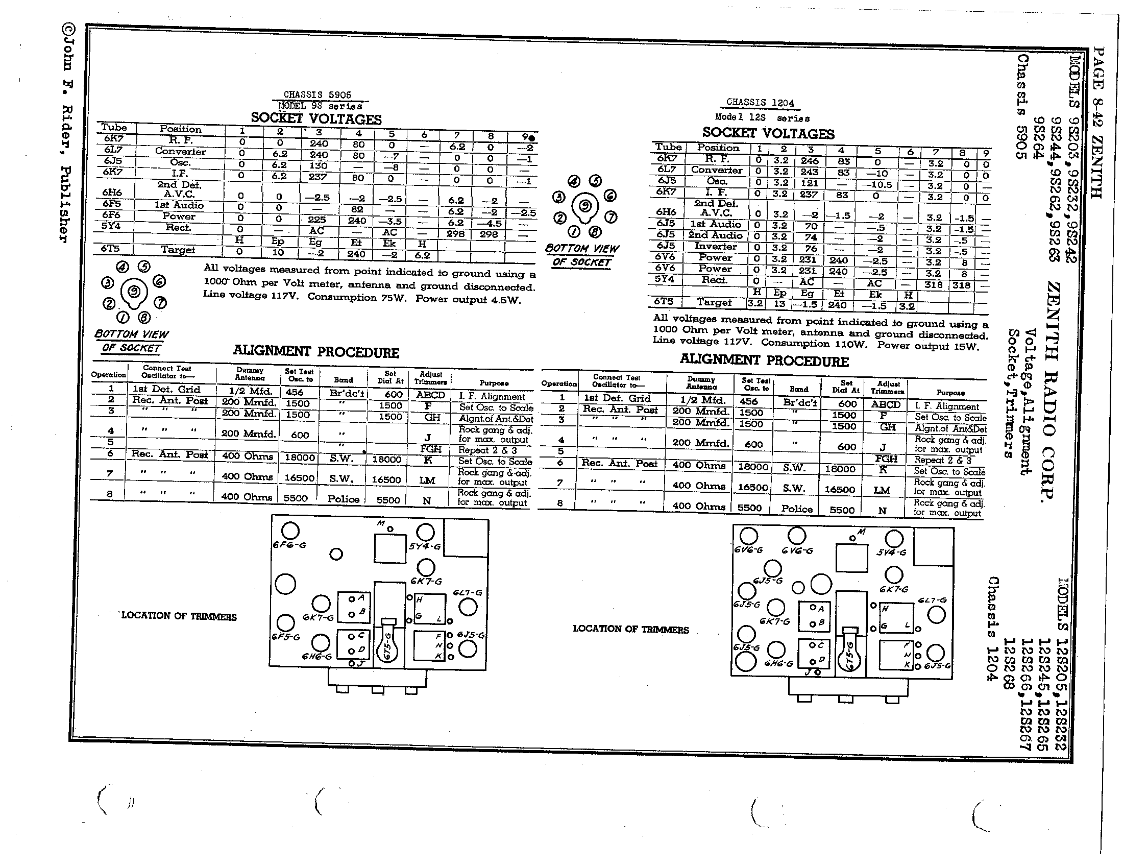

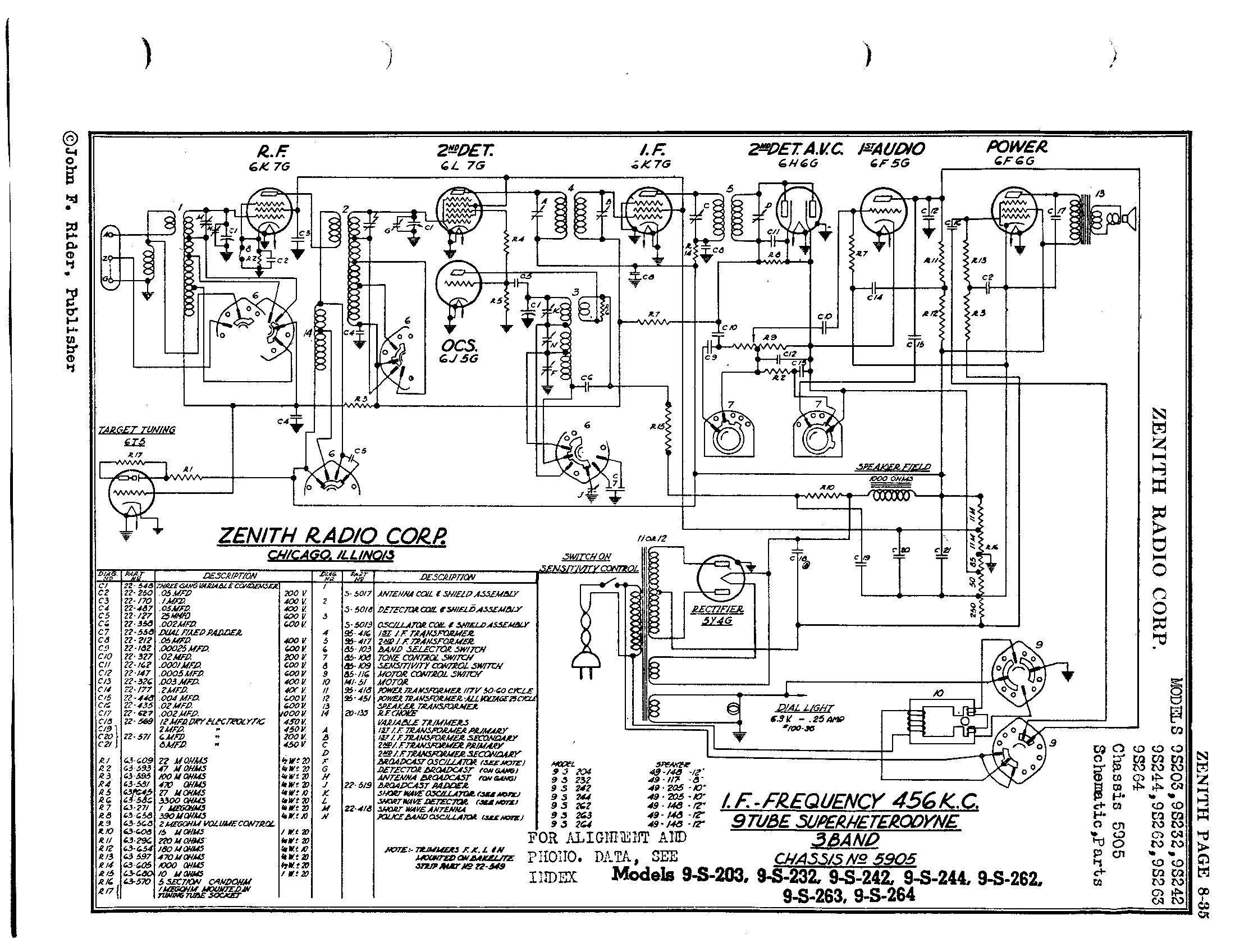

Thanks. Here are the schematic pages for reference:

Are you calling the detector coil or #2 on the schematic the RF transformer? That wouk would make sense because the primary side of the detector coil goes right to the plate of the 6K7 RF tube. Did you rewind your coil?

Yes #2 coil Yes I rewound it; I thionk it was 2 or 3 turns for the primary.
