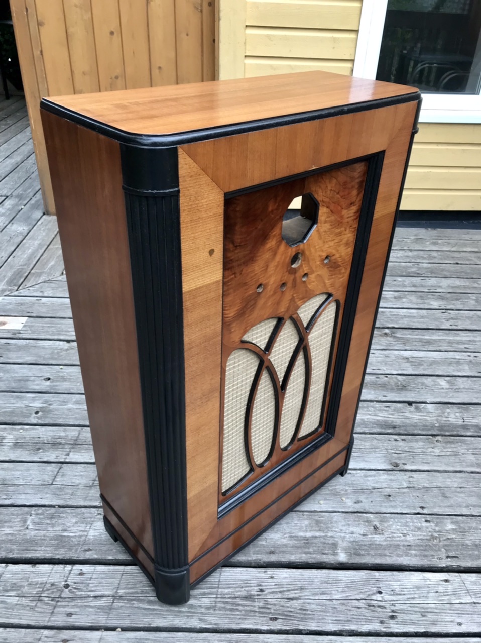

Yes I do have the whole radio, Stromberg Carlson 62, and will have further electrical questions later on but for now I was just trying to establish what works on this radio or how to test to see if it’s working. I haven’t fired it up yet because it was previously worked on and I’m trying to figure out the electrolytics and replace them before turning it on.
I started this hobby because I like working with wood, I wish I had taken a before photo because it was in rough shape, but the cabinet turned out ok.
I wish I had a better electronics background but I don’t which is why I depend on advice from experts at this forum.
Nice job on the cabinet.
