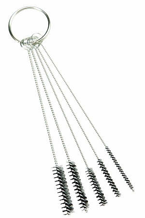

I also like to check and make sure the tube sockets are all tight and then I clean them with some contact cleaner on these little brushes I got from Harbor Freight for airbrushes:
https://www.harborfreight.com/airbrush-c...68155.html
