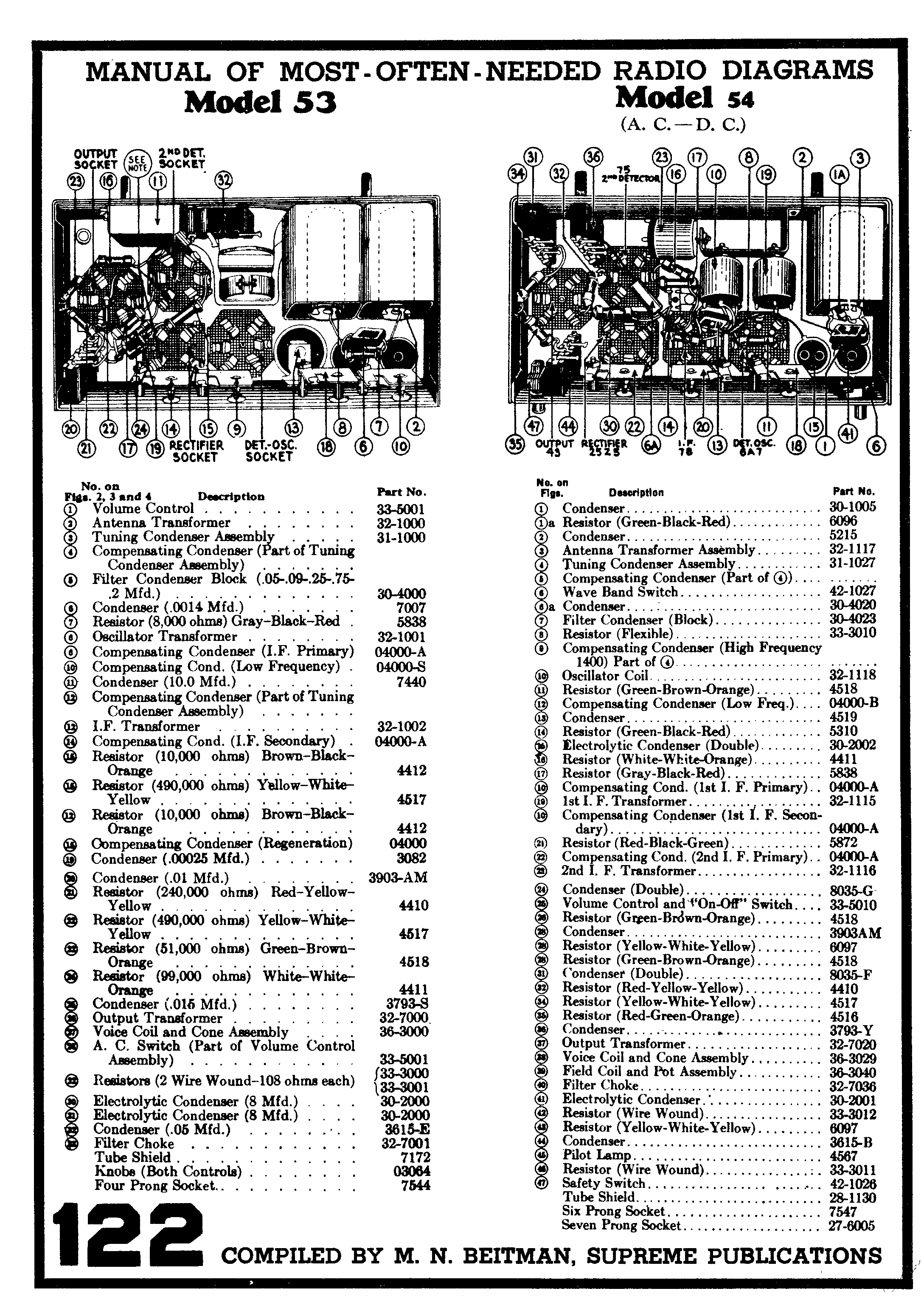

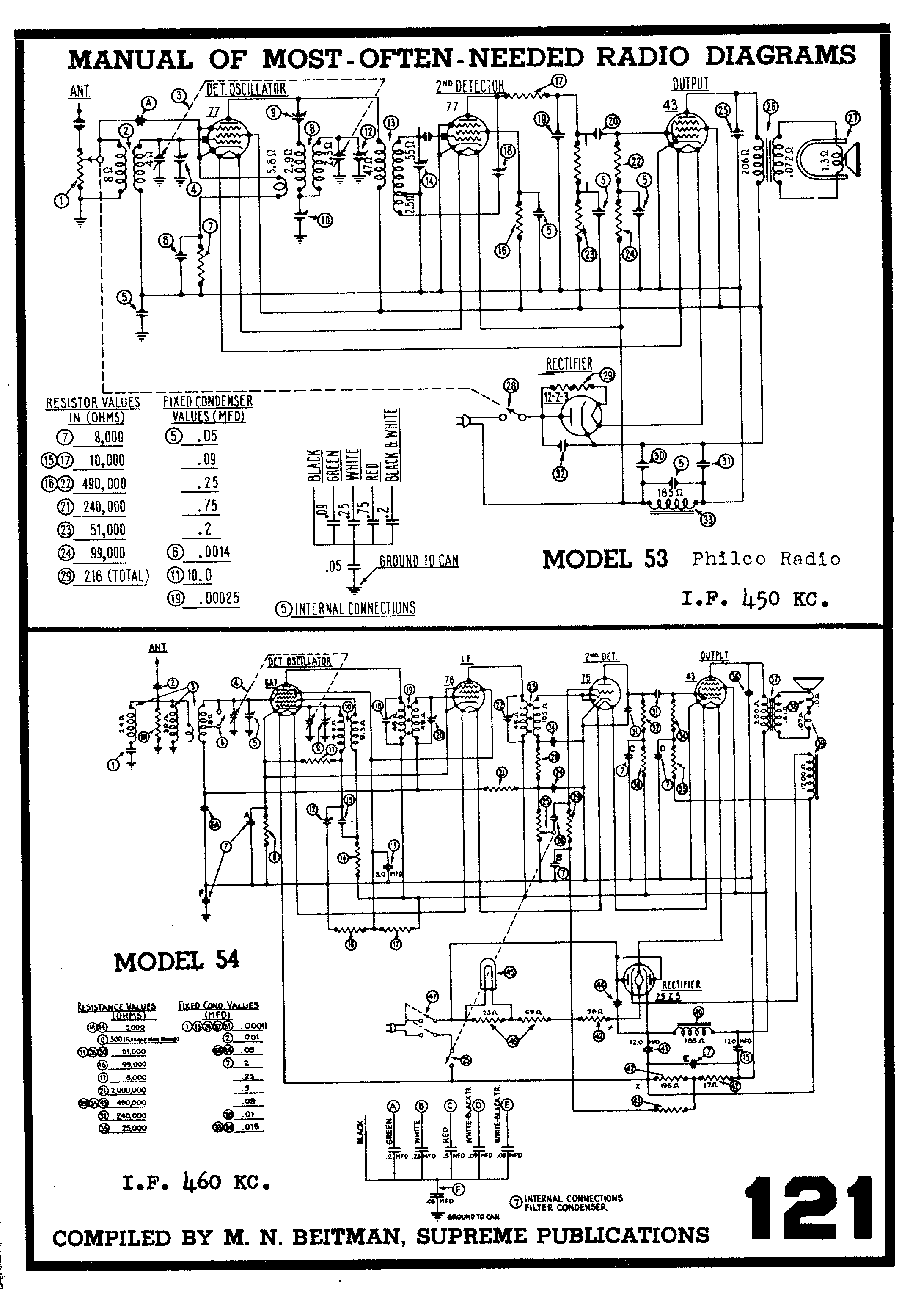

Some info from Beitmans

Thanks David for the schematics.
