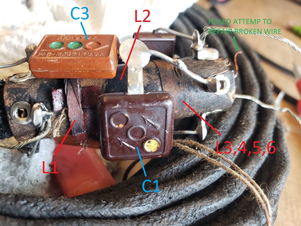

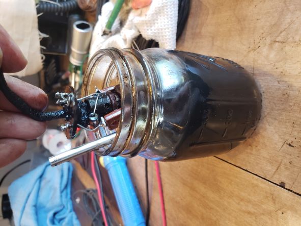

Mineral spirits should dissolve away the pitch and wax slowly but leave any paint code dots or coil sealants intact.
By description, seems the contents is a pair of tuned loading coils to broaden the response of each leg of the antenna wire.
It is also possible that there are resonances setup for the shortwave bands, popular and solar active at the time. Reviewing the solar cycle activity charts of that era may reveal that shortwave radios were built to favor those band openings.

Since you don't want to try a toaster oven and "Cooking with Ron", perhaps a heat gun could soften the tar enough to help remove it.

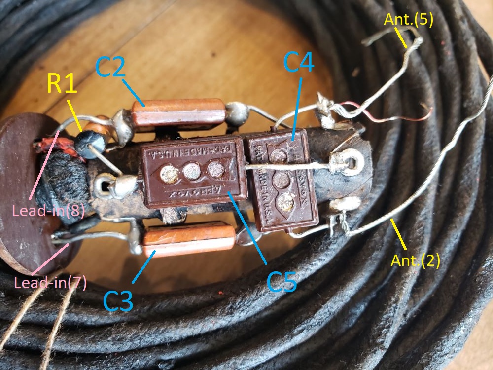

All good advice, very smart bunch here; I don't have a toaster oven but am using heat gun to soften...they seem to be mica condensers, and some of the paint dots are already history but I should be able to measure them when I lift one of the legs...I still hold down a full time job but still time for fun!
-Simon
Oh, and I think Chas is right; there also seems to be a bigger coil down in there, too......

Avoid manipulating the mica condensers by twisting, the clip the attaches the wire to the stack of metal plates can partially open and disconnect, making the cap go lower in capacity.
Good Work!

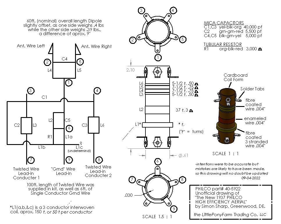

Lest ye think I've been slacking, we have been soaking this thing in a jar of mineral spirits, and it's just about clean now -even the interior which was plugged up
We have broken some one the fine magnet wire the tar was stuck to, but maybe we can count the turns....

We are finished with this (for now), and I haven’t made sense to how all these little tuned circuits are supposed to work together to make a “noise reducing” “More than double the number of stations you can get and enjoy” signal measured in microvolts. There must be some magic in the coils that are in series (L3,L4,L5,L6), plus the “Grnd” lead-in adds its own flavoring.
L1c, I could not find a termination. I broke 4 or 5 wires getting the tar off, and the Mica’s don’t measure right after being soaked and moved around.

Thank you all; I suspect the old Philco "aerials" nulled out certain known (at the time) interfering frequencies with all those little resonant circuits, thereby making it "noise-reducing", I don't know. Yes, antennas can get expensive, but they are important because they are the 'first stage' of the radio preceding the amplifier or first detector and tuned properly can hear (and transmit) around the world!
