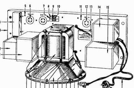

No, I have not repaired one of these but since the speaker on this unit is attached to the amplifier chassis, I would suspect that the leads are soldered to the terminals, and those terminals are likely only for the voice coil. The earlier models R32, R52, etc. used what looks like a 4 pin Jones connector., as these speakers were not connected to the amp chassis. My GE S-22A (RCA R7A) has a rather similar speaker.
I think that these radios were designed and built just before the acquisition of Victor by RCA. The amplifier is rather similar in layout and circuit to the Radiola 80, which (I believe) is the first RCA radio built in the Camden, NJ Victor plant instead of being built by GE or Westinghouse.

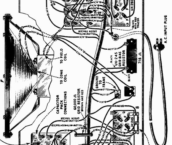

Attached below are pictorials of the Victor R-35 and the Radiola 80, bearing out the likelihood that the speaker connection is soldered at 2 terminals on a strip for the voice coil and the field coil leads being pigtails directly from the coil.
From what I can discern, the only difference between the Radiola 80 and the Victor R35Amp Chassis are the method of connecting the radio chassis and the fact that the Field coil is in the B return side on the Radiola 80 as opposed to being on the B+ side on the Victor.
In my book, this is a cool radio, as it was Victor's entry into building their own radios (they previously bought Radiola 16s, 17s or 18s from RCA.

Your RE45 radio with Electrola (electric Victrola with magnetic pickup) was based on the earlier R-32, which (I believe) is the first radio that Victor manufactured. Your speaker has a plug, likely because the speaker is cabinet mounted, and appears to be the GE Kellog-Rice speaker that all electrodynamic (and PM Dynamic) speakers are based on. The R 35, 39, Radiola 80 and R7 Suprette speakers are similar but with a different frame. The wires on the 80 and R7 Suprette are confirmed by pics to be soldered. If the Radiola 80 are soldered, it is likely that the R35, R39 and RE57 (similar amp chassis to the Radiola 80) are also soldered. Flr the R35, 39 and Radiola 80, the pigtail from the radio chassis connects to the amp / PS Chassis via screw connectors, as opposed to the Jones connector that yours uses.. BTW, I think that the RE45 is a cool radio. How does the Phono sound? The cartridge is no GE RPX let alone a Pickering, Shure, Otofon, etc., but it IS magnetic! (If I bought one of these, Ms. Fixr would fix my wagon but good!
