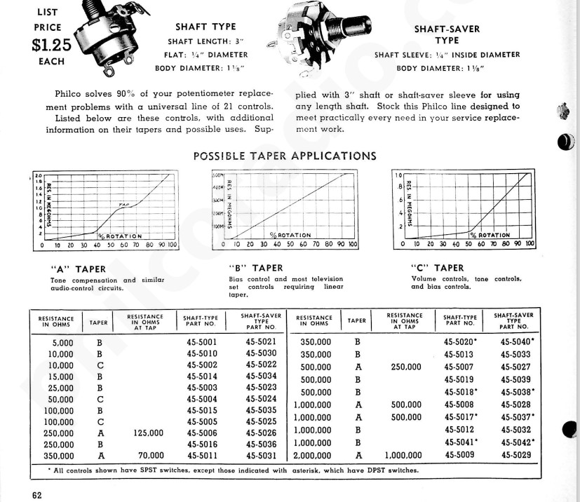

Hello guys, working on this radio I found that the volume control was replaced because the on/off push button was not working. A volume control with on/off switch was installed. The volume is down so I checked the control it is stamped Philco 45-5001-8 when I measure it, it measures 1 meg, the schematic shows the volume control should be 500K. I couldn't find info on the 45-5001-8 to make sure.
Can someone tell me that the 45-5001-8 is indeed a 1 meg. I may have to put in a 500K, to get more volume.
