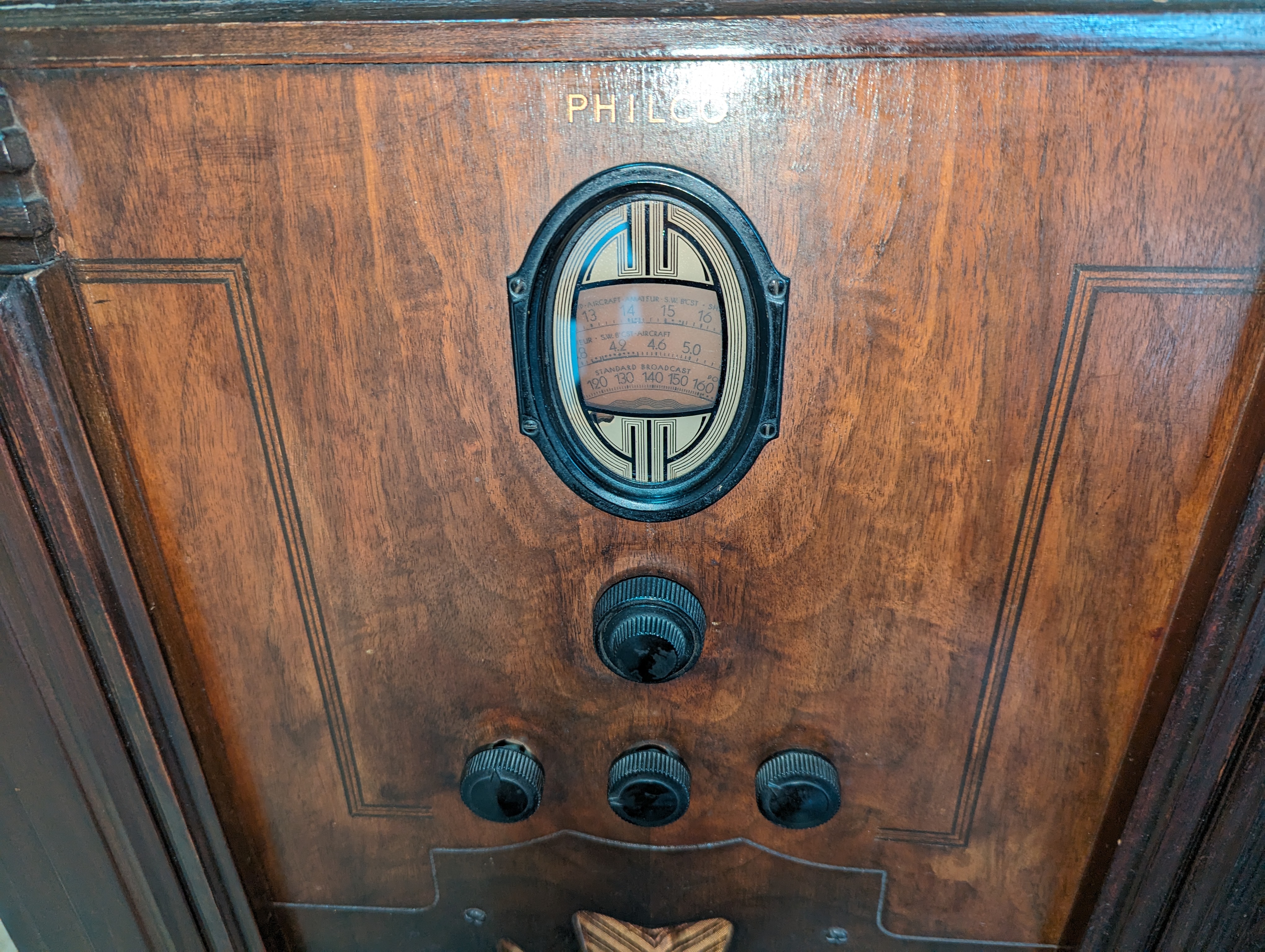

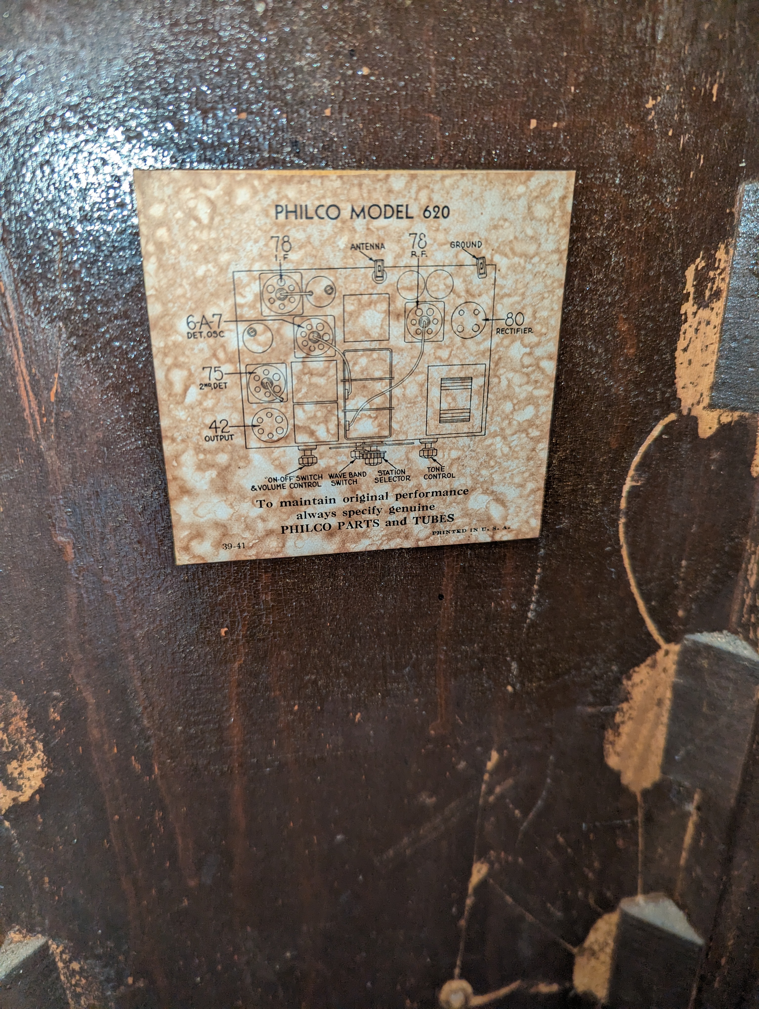

Does anyone have the schematic for the Philco 36-620F?  I've searched the Philco site and Nostalgia Air but couldn't find it under the year for             1936.
The tubes are 6A7, 75, 42, 78 (2), and 80.  I can find a picture of it when I go through the old radio pictures online, but no schematic.

If you take a look your 620 doesn't have a year designation as the pre 1937 don't. That's why you couldn't find it under the 36-620 listing. Your 1kv cap you can take two .047mfd @ 630v and connect them in series to give you .0235mfd @ 1260v.
