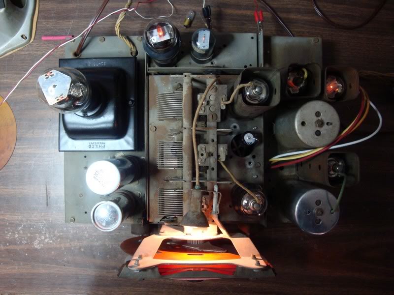

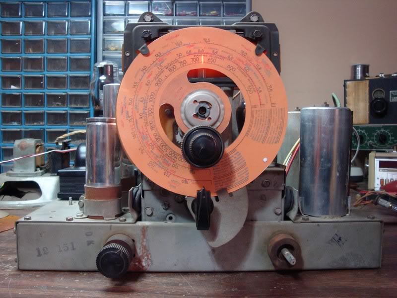

Here are a couple photos of the now restored 37-650 chassis in action.
[Image: http://www.philcoradio.com/images/phorum...0001-1.jpg]
[Image: http://www.philcoradio.com/images/phorum...0002-1.jpg]
