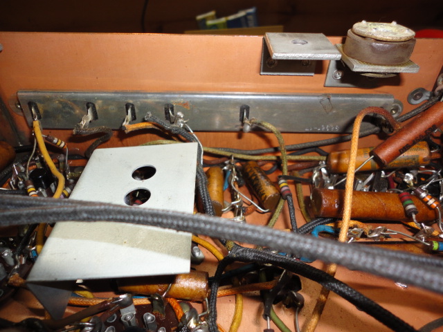

Posts: 56
Threads: 15
Joined: Jan 2013
City: Felton, PA
Im working on a V-215 now. Luckily, mine doesnt appear to have been worked on previously.
I am having an awful time trying to figure out the candohm. I posted to the ARF but no one seems to have experience with this set.
First of all, the schematic shows the 3 resistor sections in series, with 4 tie in points and the sections appear to be connected in series. On my set, the candohm has 6 terminals, and the sections are separated.
Reading resistance from left to right, I get 151 ohms between terminals 1 & 2, 21 ohms between terminals 3 & 4, and 3Kohms between terminals 5 & 6. The correct spec is 145 ohms, 25 ohms, and 10 ohms. Also, the schematic shows the end of the 10 ohm section grounded to chassis. Mine has no continuity to chassis from terminal 6.
Does anyone have any experience with this particular candohm??
