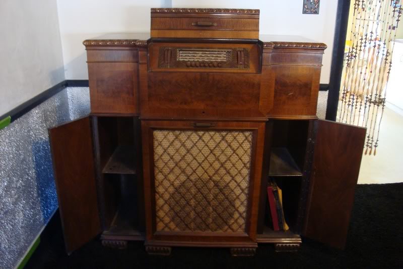

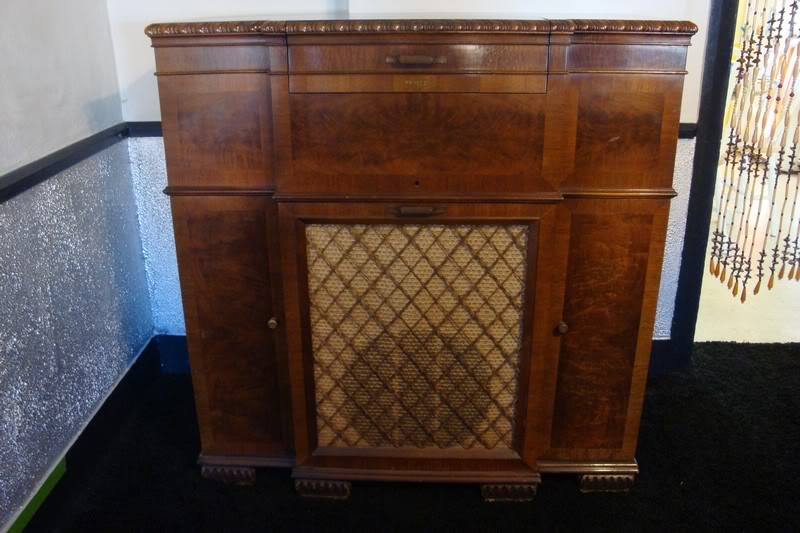

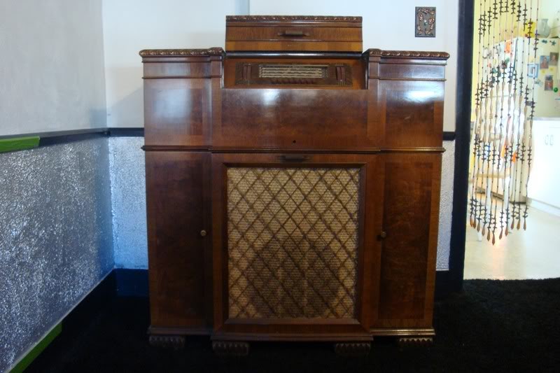

I've had this 41-616 since 2010. As is the case with many of my sets, it has been sitting, patiently waiting for me to do something with it...
[Image: http://www.philcoradio.com/images/phorum...e00001.jpg]
[Image: http://www.philcoradio.com/images/phorum...e00002.jpg]
[Image: http://www.philcoradio.com/images/phorum...e00003.jpg]
When I acquired this set, it had no tubes, and was missing its original 3-post De Luxe Inter-Mix changer. Some nondescript 1950s changer was placed in the phono compartment...and I do mean placed...not bolted in, just sitting on the motor board.

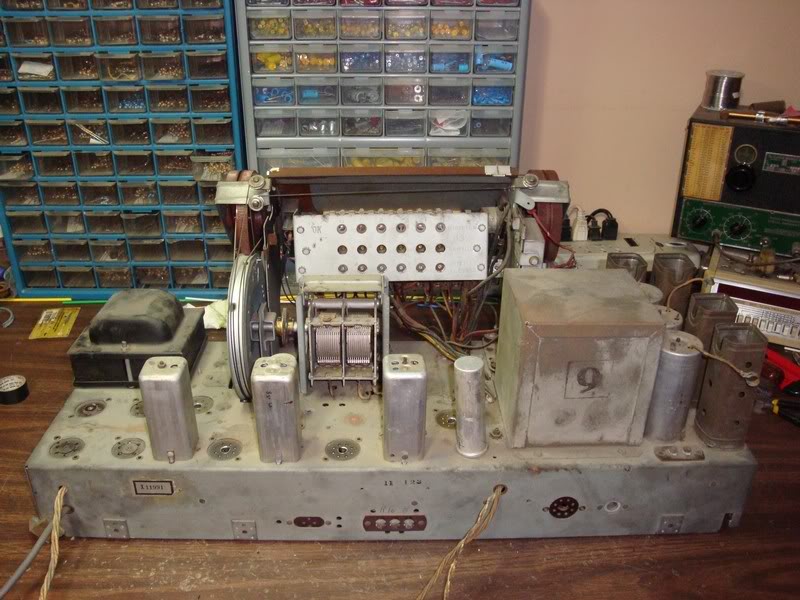

Anyway...earlier this week, I pulled the huge chassis out and set it on the workbench.
[Image: http://www.philcoradio.com/images/phorum...e00005.jpg]

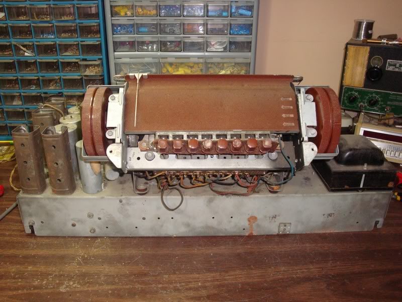

I removed the dial scale and put it away, not to be replaced until the chassis is finished.
[Image: http://www.philcoradio.com/images/phorum...e00006.jpg]
As you can see, there are no tubes...but the tube shields are all there in the Mystery Control section of the chassis.
[Image: http://www.philcoradio.com/images/phorum...e00004.jpg]
[Image: http://www.philcoradio.com/images/phorum...e00007.jpg]

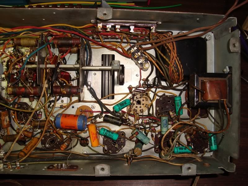

Bob (bandersen), I think the chassis in my set is a bit more crowded than your 41-316 chassis is...
If you notice, many of the original paper caps were replaced, mostly with turquoise Sangamo caps, and a few with black Cornell Dubilier caps. This was probably done in the late 1950s or early 1960s.
The original electrolytics were also replaced with Twist-Lock electrolytics. One was installed well, on a phenolic mounting board; the other was just sort of stuck in an existing hole in a sloppy fashion.
Lots and lots of rubber-covered wiring under the chassis.
Oh, and surprisingly, the audio output transformer is still good! These are often bad in the 1939-1942 models.
I've decided that instead of resleeving all of the wires with heat shrink tubing as I usually do, in this chassis I am going to replace the longer wires and the wiring harnesses running from the stepper unit to the pushbutton mechanism and the individual button lights with new PVC-insulated wires.

Yes, that side of both chassis appears to be the same...but take a look at the other side of my 41-616 chassis, compared to yours. Icon_eek Icon_crazy
The area around your stepper unit switch contacts looks relatively empty compared to mine.

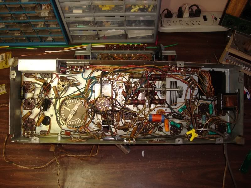

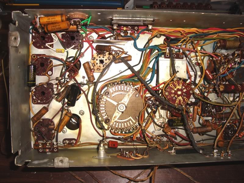

For clarity, here is a close-up of the other side of the chassis:
[Image: http://www.philcoradio.com/images/phorum...e00008.jpg]
Yes, the extra switch next to the stepper unit switch contacts is a relay driven switch, which switches the receiver from radio to phonograph mode and back again. I sure hope there is nothing wrong with this relay and switch. Icon_think
You'll also notice mine has an extra tube socket - that is for a 7C6, used as a phono preamp.
In the photo above, I have removed the shield (which mounted at upper left) which covers the spark filter coil and associated circuitry. You'll also see more of those Cornell Dubilier Cubs in this photo. You can also see that the restoration work has begun - one cap and one resistor have been replaced, and four short wires have been resleeved.
