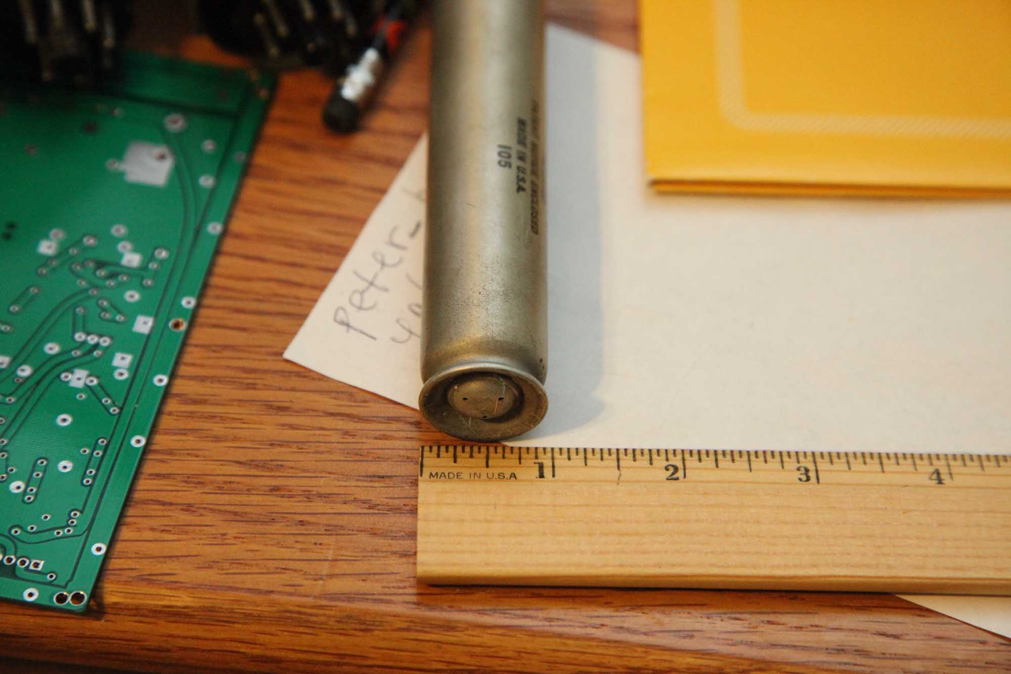

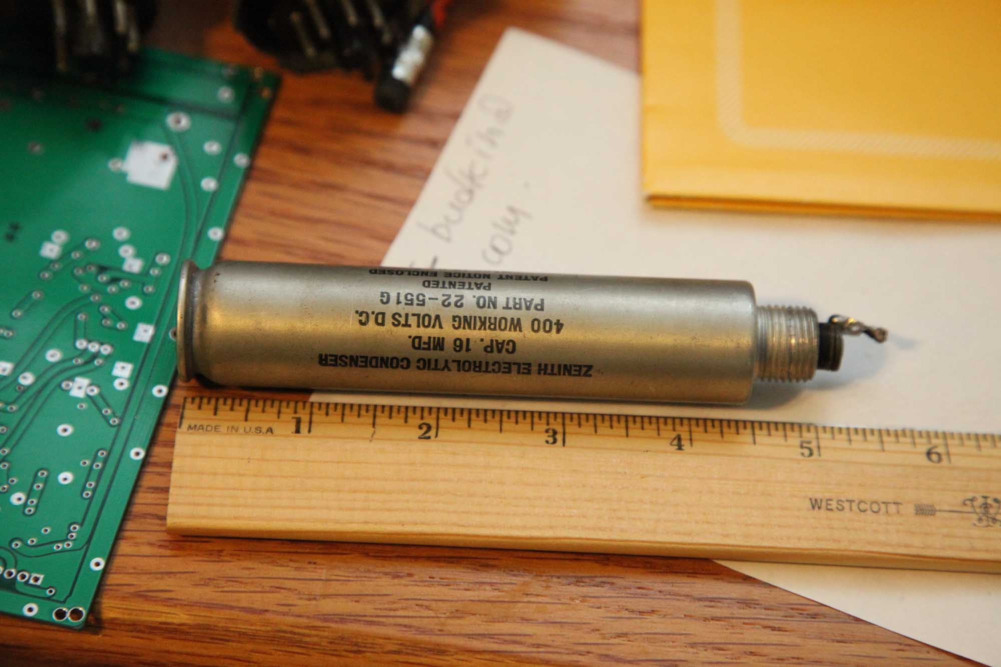

I have a Zenith electrolytic that is totally dried up (says 16uF 400V, measures at 1nF and is suspiciously lightweight), and that is very slim and long (under 1" diam. and 5.5" long).
I want to restuff it but not sure where best to cut it. I want it to look undamaged when it's done, but if I cut the top, I simply won't reach to the bottom. Too long and narrow. If I cut the bottom, it will look like you know what.

Here is the cap.

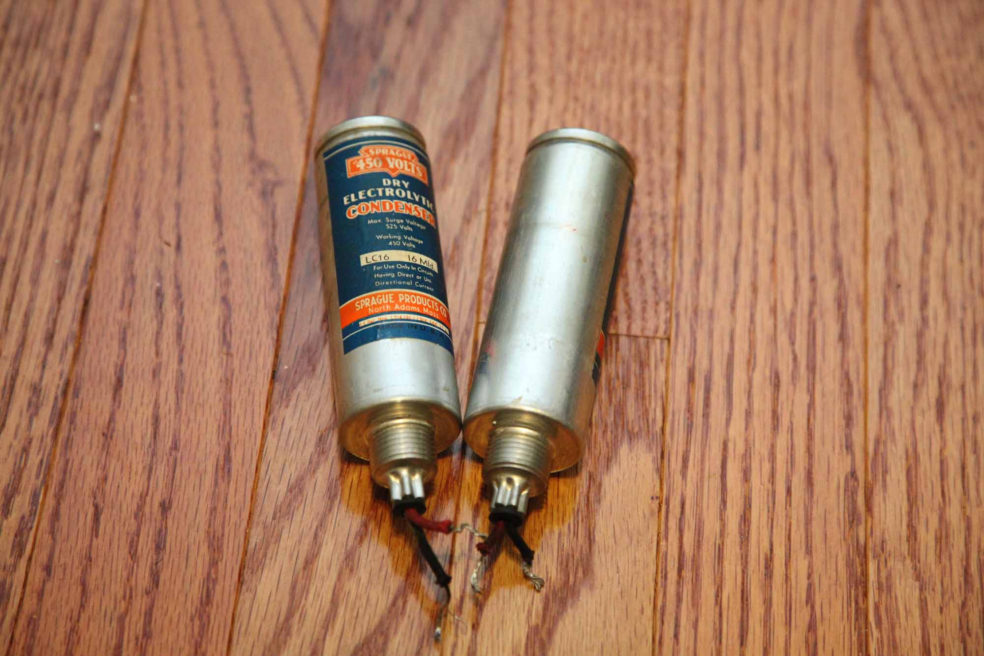

As for the two insulated wires out, you probably mean something like this?
Those had insulated body and two wires and this is how i re-stuffed them; I can make this one look like it too.
Actually this is an even better idea, as the length precludes me from soldering to the center pin, but if I don't need it and am out to simply gut the cap and remove the center pin, it requires no finesse and can be done even with this length to width ratio.
Thanks, I think I know what I'll do.

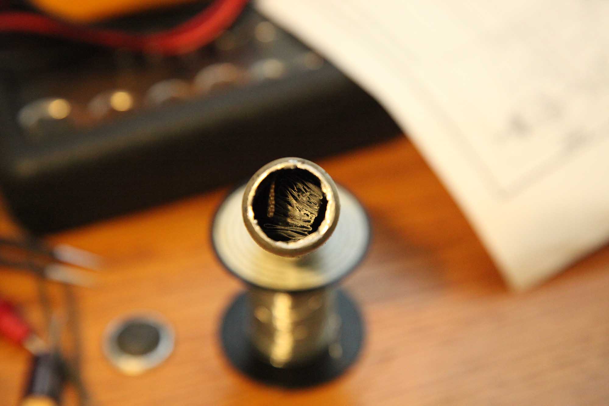

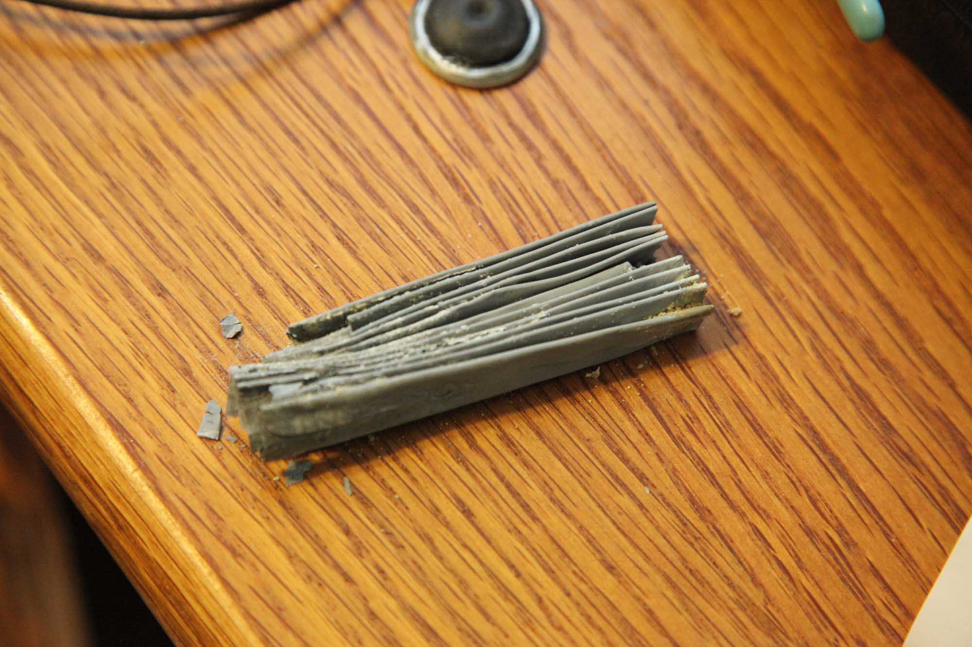

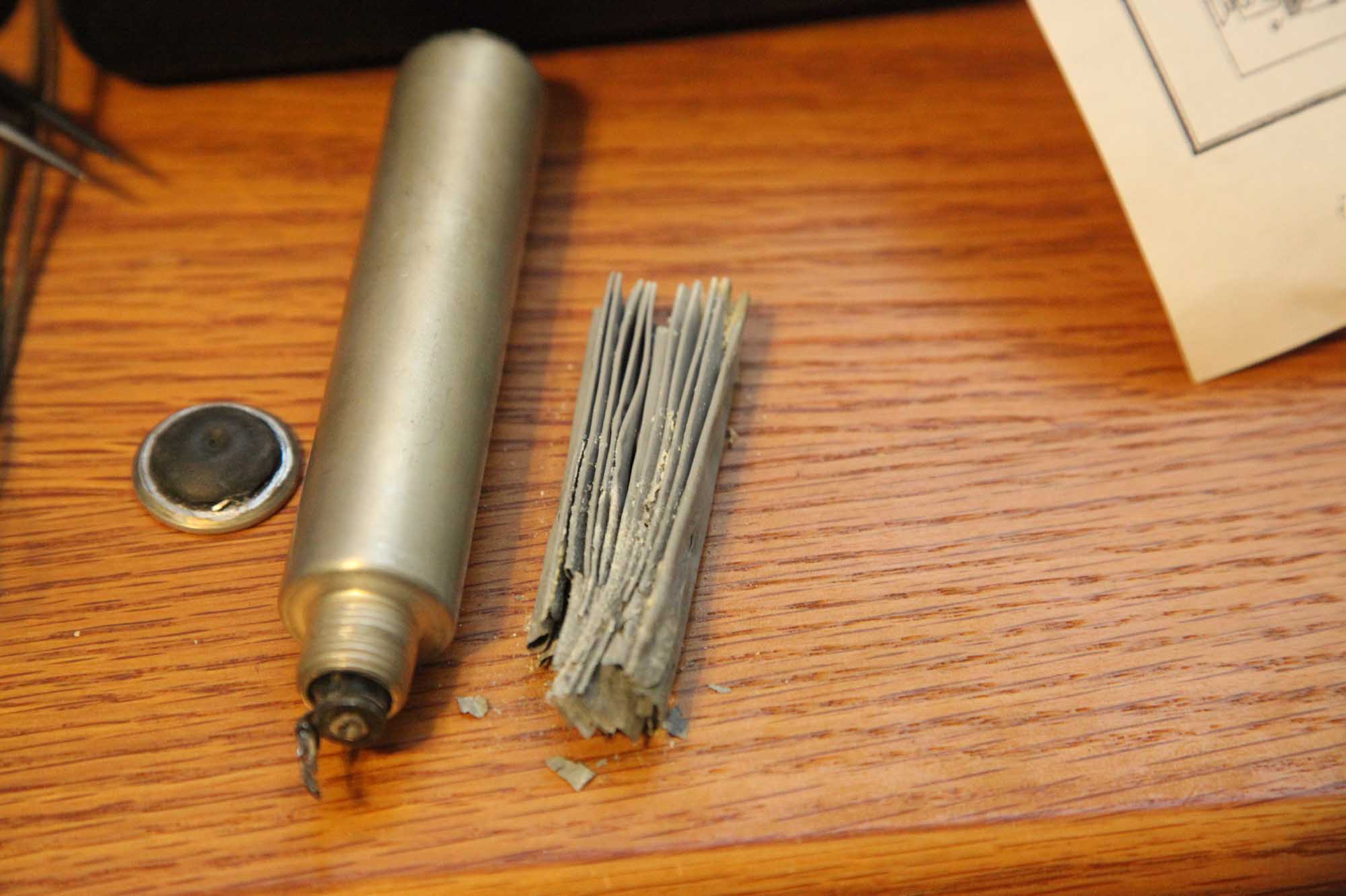

I will post photos either today or tomorrow: I cut off the top cap with my Dremel and the cutting disk, right at the groove, so it will look fine.
Insides were as dry as H**l on a hot day in June.
Taking them out did not pose any problems, and there was no tar or anything. It was dry dry.
The central rod is quite high and should it be solderable I'd have no problem soldering to it, but I think it is not, and it is attached to the solder contact with a rivet of some sort.
So as I planned, I will remove it and go with two wires.
I will wait 'till I finish, but so far it is not nearly as bad as I thought it would be.

Here, I made some pics.
