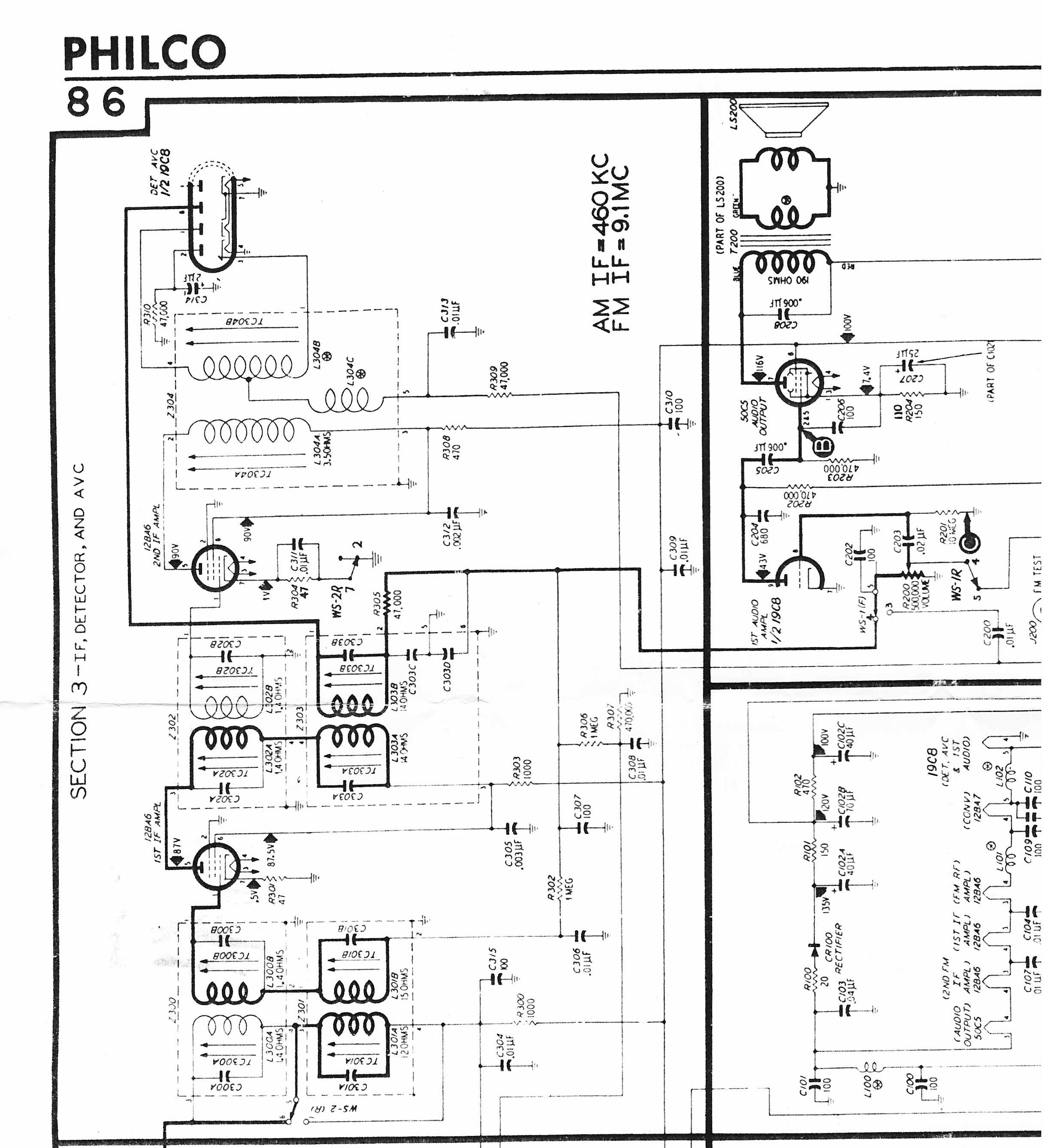

Hi guys. Finally got the schematic scanned. I'm showing only the last I.F. and the ratio detector. I'm wondering if there should be a cap in the secondary of the ratio detector trans. Some other schematics show one but not here. If it has one and it's open that might explain my not being able to get a null. Any ideas? Thanks[/quote]

Thanks for the reply. I did check the coil both primary and secondary and they are not open and the tertiary(?) winding has connection to the secondary winding. Another funny thing, there is no sound at all with c314 in place, and it has been replaced. I've just bought an EICO sweep marker and I want to see what the fm bandpass looks like. Philco complicated things by choosing 9.1 mhertz as the if. I already have a Heath sweep marker but it is for 10.7mhz not 9.1. The EICO has variable marker (I believe) so I should be able to adjust it to the Philco i.f. We'll see how that goes. I keep wondering if there should be a cap across the secondary of the ratio transformer. The schematic does not show one but similar schematics for other radios do. What do you think?

That discriminator coil was a trouble spot for those radios. Look for a broken slug. There should be some internal caps as well, but less likely to be bad.

Thanks to Don Lind for his suggestions re- the ratio detector coil. I took it apart and found that the slugs were intact and did move up and down. I checked for an internal cap and there was one on the secondary only. It showed no capacitance whatsoever with the coil unsoldered. I cut it out of the circuit and carefully reassembled the can. I had no idea what value of cap to use in the secondary circuit. I dug into my stock of small mica caps and came up with a 47pf unit which I soldered in. I was now able to do a proper alignment and the secondary adjustment does not show a null. The radio now plays distortion free. Thanks again for everyone's suggestions.
