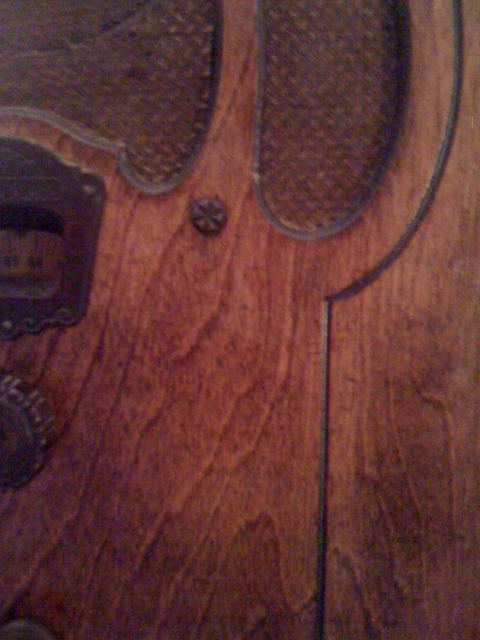

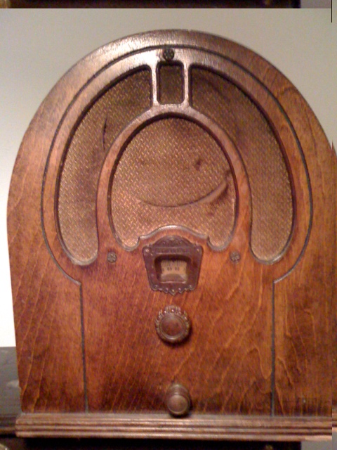

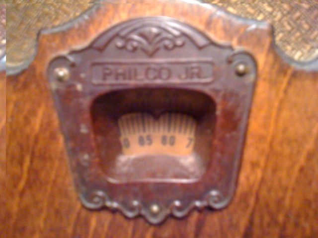

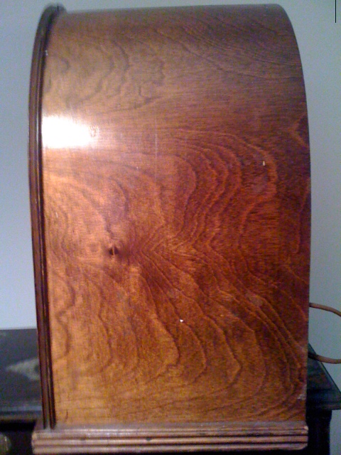

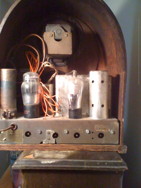

                    Are there Philco Model 80 radios that were the Jr model with beautiful real wood instead of the two tone finish.
Please see the pictures. I have recently got on board collecting Philco radios. I am an Atwater Kent Collector and I am expanding to other brands.

No, your set has been stripped to bare wood. Looks like a light clear finish was applied after the cabinet was stripped. You should hope it isn't polyurethane...because that stuff is nearly impossible to remove.

Do you mean that all of the two tone radios had a beautiful solid wood behind the finish. Many post say that the front was flat and a neutral basic wood.

All Model 80 sets were two-toned when they left the factory. A lot has happened to them in the 80 years that have passed since.
Some Philco models, notably the later 1935 and 1936 tombstones, have cheap white wood behind the very dark toner that was used on the top, sides and trim.
There must be some people that like the look of the cheap white wood, based on the number of 1937 Philco cathedrals and tombstones I have seen that have had all of their photofinish stripped off and refinished in a plain neutral color. Icon_thumbdown
