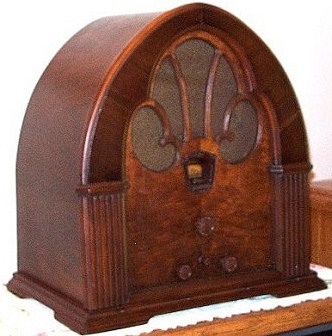

Am working on the cabinet of an 80 Jr which had been in 3 or 4 inches of water at some point.  The veneer buckled and bubbled so I've disassembled the bottom, front and arch to be able to get at gluing down the veneer.
[Image: https://www.dropbox.com/s/4jm0ru1e8cxvxy....jpg?raw=1]
[Image: https://www.dropbox.com/s/sn6398trh3iq7z....jpg?raw=1]
Was able to get the arch away from the front with only one small veneer tear which will glue back together easily.
Question: When reassembling the arch to the front do you guys glue it back in place or just press fit it into the front and then glue the glue blocks that connect the base to the arch sides??  Thanks!!
I just finished gluing together a model 80 with a similar problem of water damage at the bottom. It seems that the front panel was originally fastened to the arch by glue in the groove, along with the two glue blocks near the bottom, so that's the way I redid it. Without gluing the groove, the cabinet would be very weak and flexible. Its a pretty flimsy structure overall and needs all the strength you can give it.

I feel for you brother. 8) Here's a picture of my 90 that met the same fate years ago. But there is hope...2nd picture.
