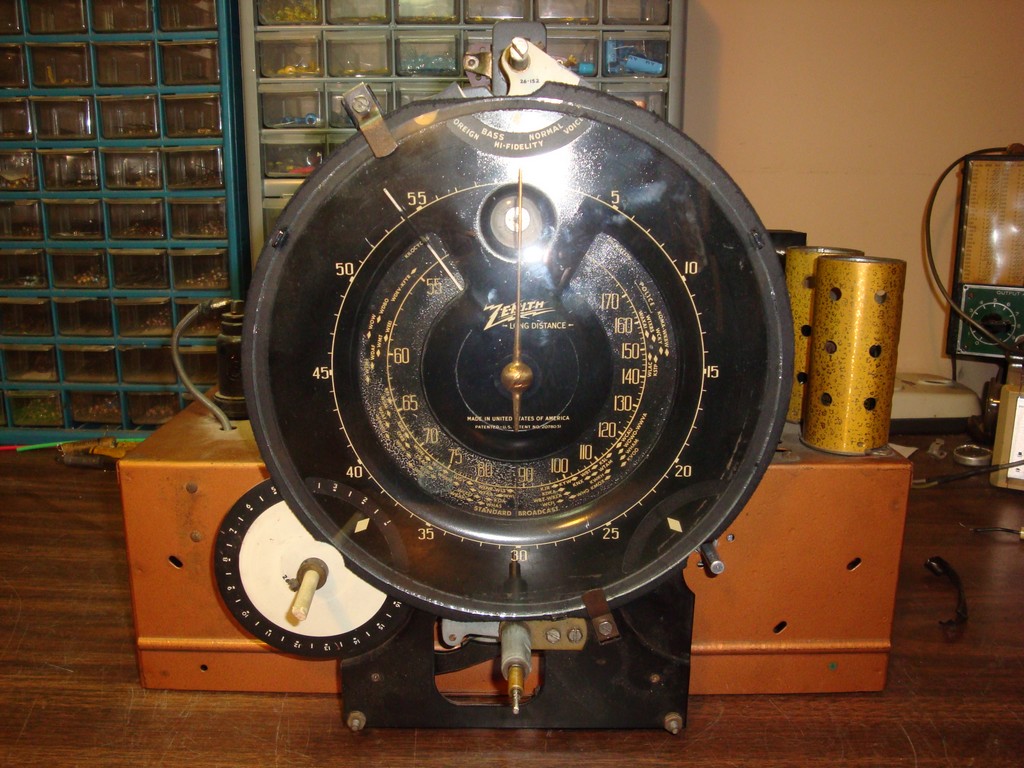

I pulled the chassis out of the cabinet again today. As soon as I set it on the bench, the dial glass fell off, since it only had one clamp sort of holding it in place. Luckily, I caught it before it had a chance to break. Whew!

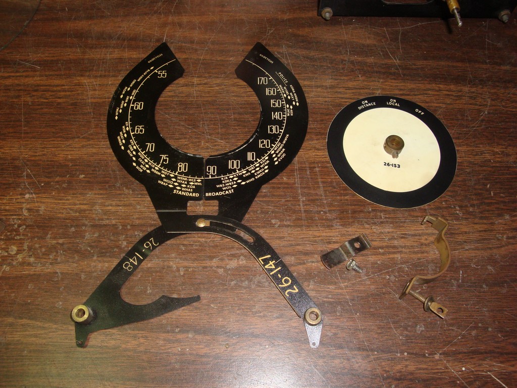

A week ago (or was it two?), a CARE package arrived from Phorum member "thirtiesradio." Thanks, Keith!
[Image: http://www.philcoradio.com/images/phorum..._00002.jpg]
After taking this photo, I packed the AM shutters and the disk for "Off-Local-Distance" back up, as I am not yet ready to use these.

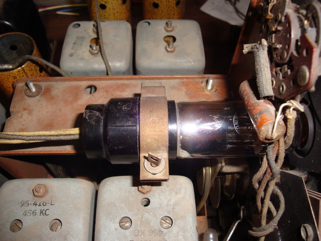

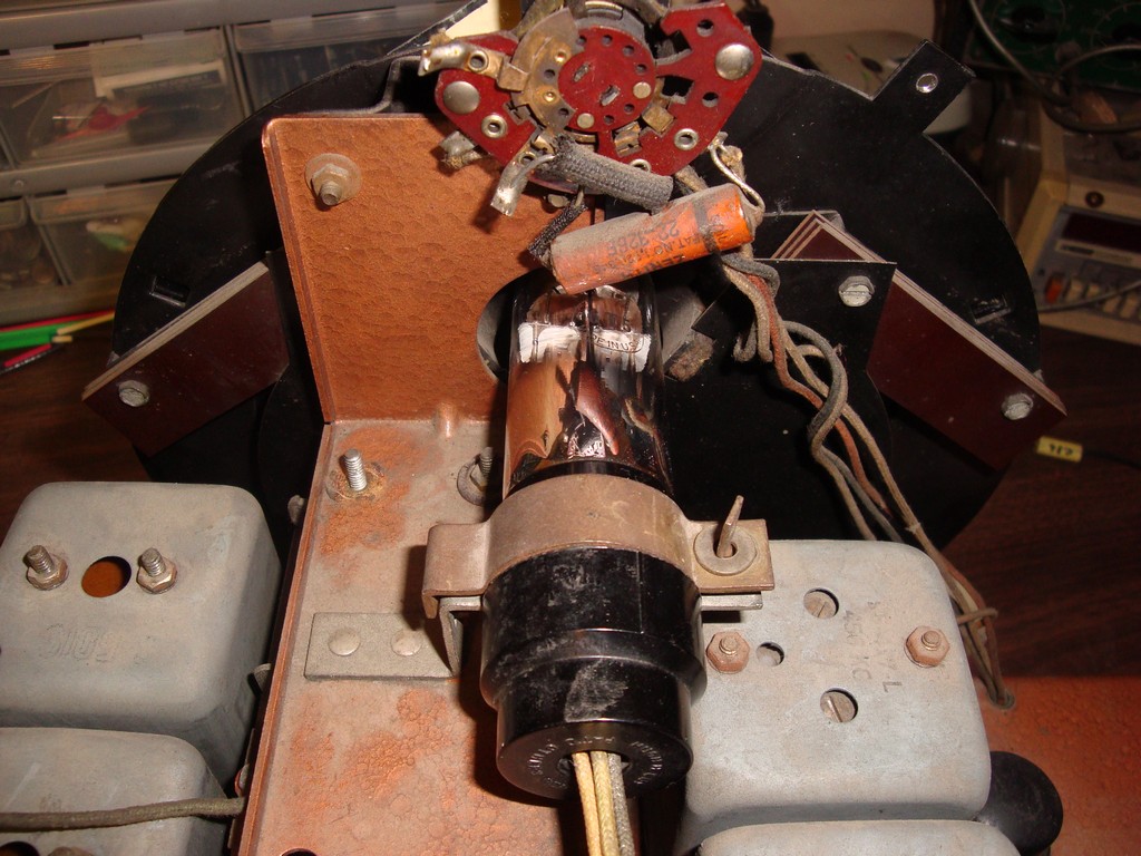

I took the upper clamp piece and attached it to the lower part of the clamp which holds the eye tube in place. Just for fun, I reinstalled the dead 6T5 also:
[Image: http://www.philcoradio.com/images/phorum..._00003.jpg]
[Image: http://www.philcoradio.com/images/phorum..._00004.jpg]
[Image: http://www.philcoradio.com/images/phorum..._00008.jpg]

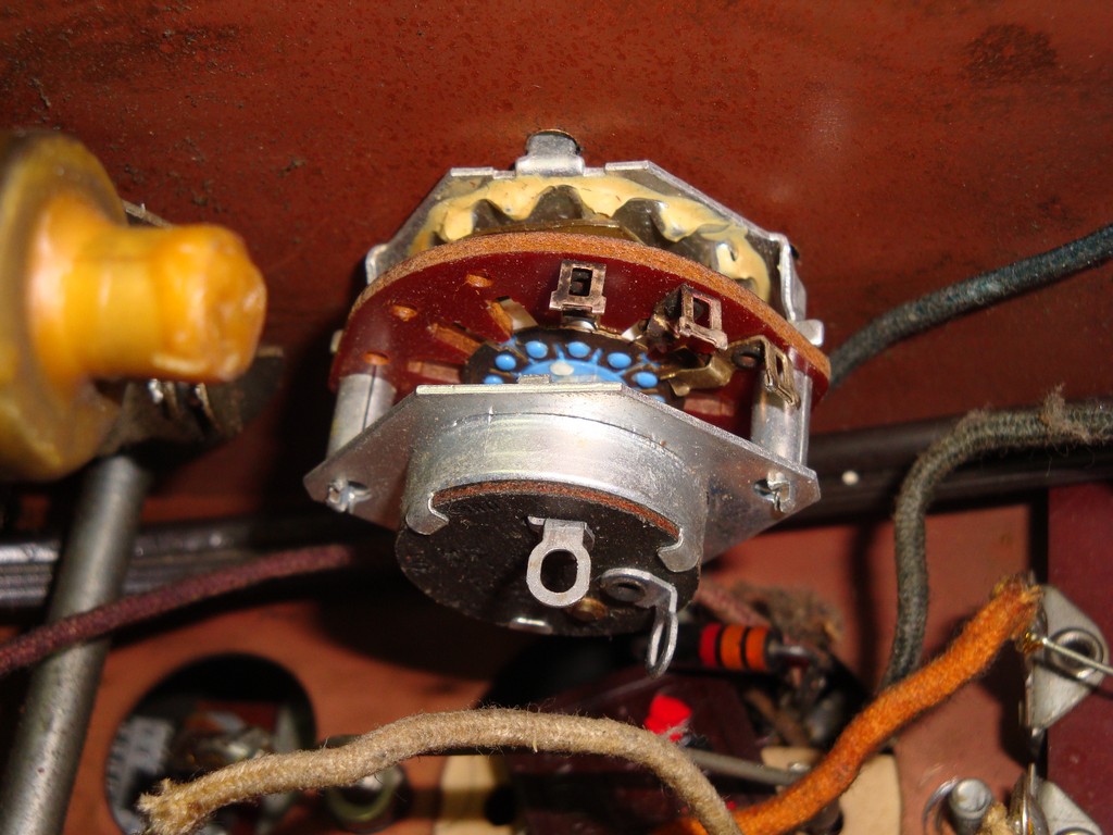

Remember that potentiometer that was connected to nothing, just taking up space where the off-on-local-distance switch should go?
[Image: http://www.philcoradio.com/images/phorum..._00005.jpg]
Well, I had a few special switches that I had bought on eBay a couple years ago for use in Philco 19 and 89 sets. This combines an off-on switch for AC power with a two pole, three position rotary switch. Using one of the two pole sections for local-distance, and the AC switch for power, this will be an excellent replacement for the original off-on-local-distance switch once I wire it into the circuit:

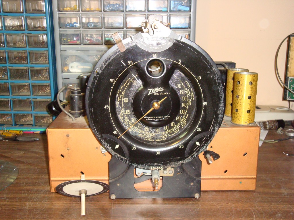

I also purchased a dial glass gasket from Mark Palmquist. Using that, and the second dial glass clamp from "thirtiesradio," I put the dial glass back on the chassis. It now looks like this:
[Image: http://www.philcoradio.com/images/phorum..._00007.jpg]
I also figured out where the dial lamp was supposed to be mounted, and put it back into its proper place.
