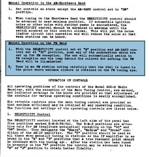

What the manual says is that to change between AM and FM, you have to have the AM switch in the BC position, and the bandwidth switch in the M position.
This does, indeed, seem to be the way mine works. It's rather a convoluted switching scheme.

Sorry BAD, I did not understand. Will try again to change from AM to FM with the Selectivity control in various positions. I didn't realize you were changing from AM to FM.

Yes Brenda, the position of the selectivity switch in the wrong position does stop the changing from AM to FM. Not certain why as I always had mine set to the "M" position. Glad you found the coil you needed.
