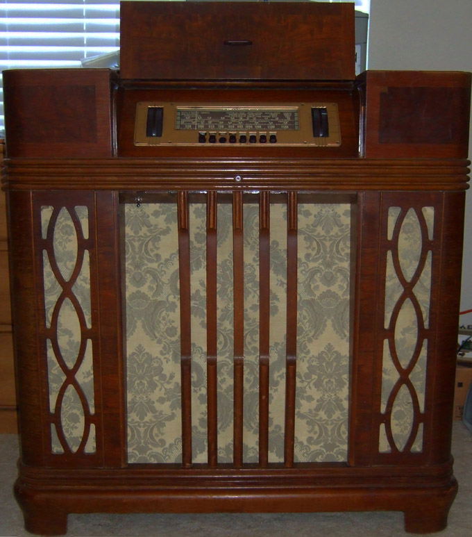

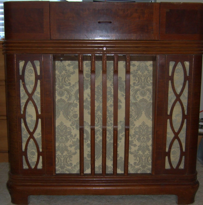

I managed to get the chassis reinstalled in the cabinet and replaced the original grill cloth that was hopeless. Since I could not get the original type, I decided to just satisfy myself as to appearance of the grill cloth. I found a brocade cloth that had some gold and green tones somewhat similar to those in the original cloth, but not as dark. I need to move the center grill slightly to one side to get the patten centered better. These pictures are of the front only with the lid open and closed. I still have to refinish the cabinet and the pictures have had some blemishes removed using Photoshop, but it shows about how it looks now. I hope to soon have a jewel for the pilot lamp.
Thanks to everyone for their help!.
Joe
