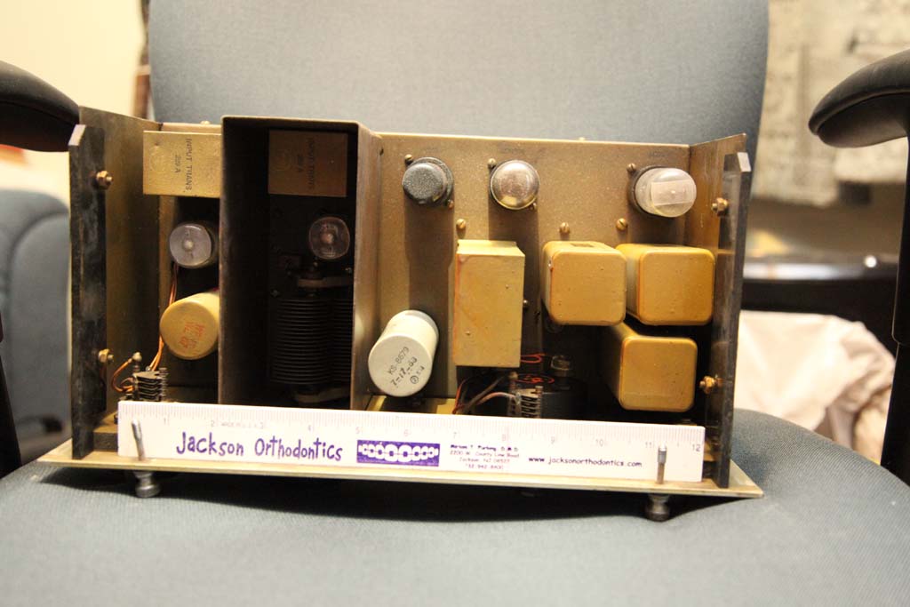

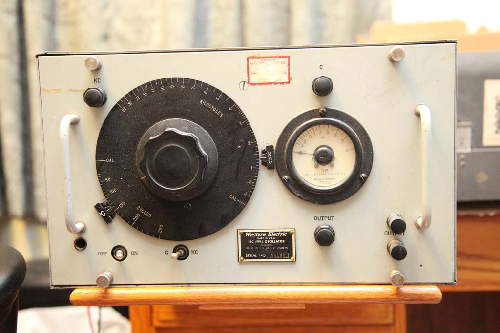

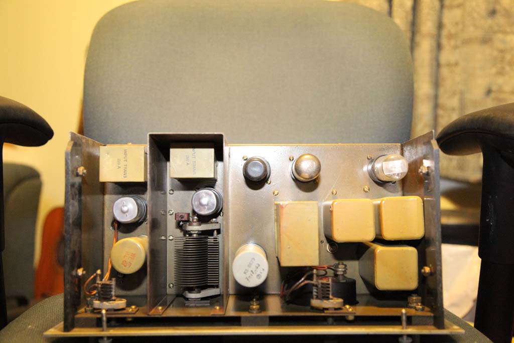

Here are some pics of the oscillator.
Face and chassis top.

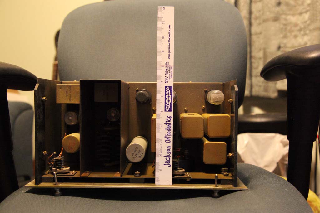

Brenda,
Here are some pics of the oscillator. Face and chassis top.

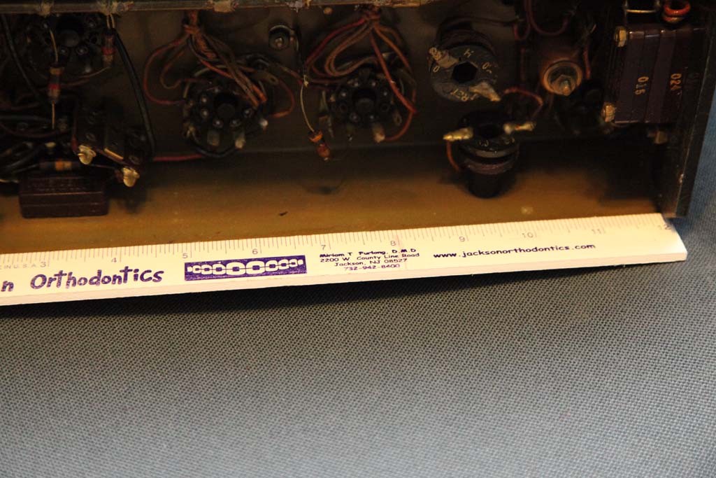

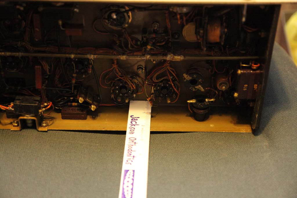

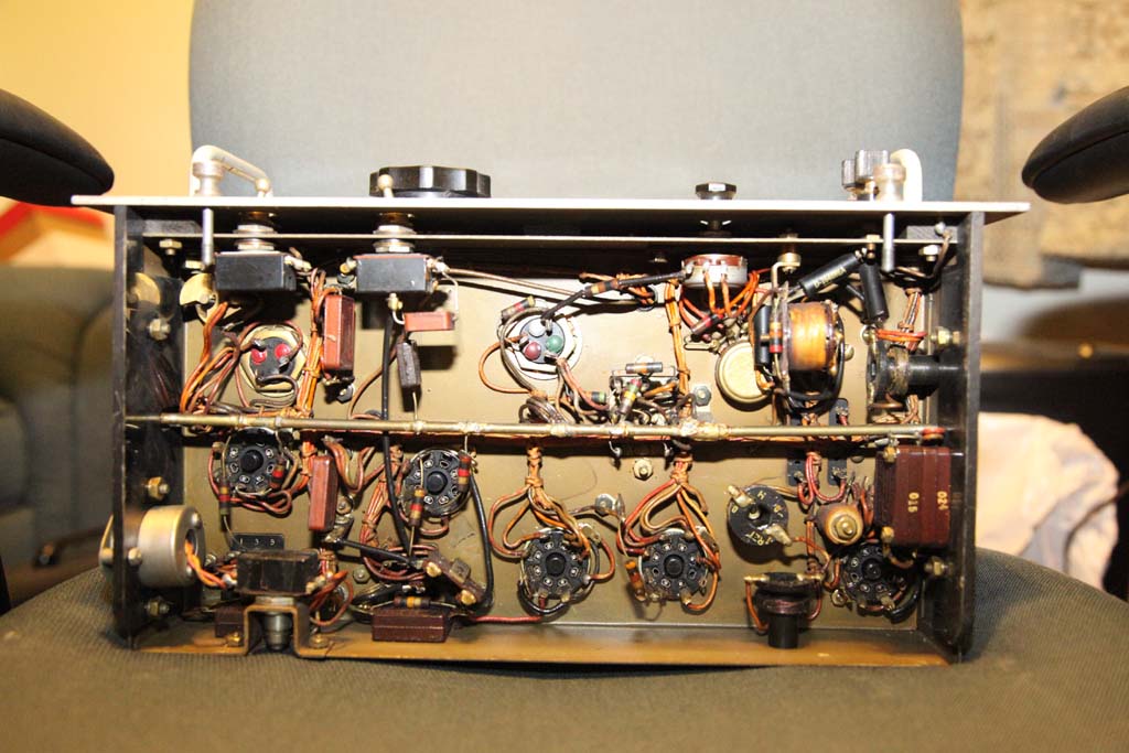

01-10-2014, 04:19 PM
Underchassis.

This looks to be a well thought out design. "hot chassis"? Perhaps, but well isolated from the cabinet and the outputs are isolated by capacitors. I note the ground bus is insulated from chassis by the bakelite standoffs, and the front panel is insulated from the rest of the chassis the same way. From the look of the design, there shouldn't be any hazardous voltage applied to any point accessible from the outside of the cabinet once the cover is in place.

Yes you are absolutely right, the first time I looked I hadn't noticed it: the chassis is mount of two large plastic sidings that keep it from contacting the front panel and the case. Capacitors alone woud not be sufficient, as low acoustic frequency dictates a cap that could present low impedance to a touch current should I decide to complete a circuit to something nasty, but the good news is the output is isolated by a transformer. That makes it that much safer. That is, in fact we do have a transformer isolation after all. Well, I was a litle impatient in buying that HP200, but.....truth be told, I always wanted HP200, so I used it as an excuse. Plus the price of it was low, so all is good. Now I just have to see if I could find a fitting plug. I don't feel like changing the power socket.

That's a really interesting oscillator, and very well built as is typical of WE equipment. Looks like its a beat frequency audio generator where two RF carriers are mixed together to produce an audio signal.
Nice thing is that it can generate an audio sweep from 100 Hz to 15 KHz with one turn of the knob. Great for a quick check of audio freq response. Downside is that they are a bit unstable because you are subtracting two RF signals from each other, magnifying any freq drift. The waveshape may also not be a very good sine wave because of harmonics in the RF signals and nonlinearities in the mixing process. The HP 200CD is a true Wein Bridge oscillator and produces a very nice low didtortion sine wave. Its probably more suitable for critical testing, and of course its a classic HP design.

I have these two electrolytics, they are from 1953. They can be seen on the pics above of the top and bottom. All are still measure pretty good. One dual 16uF measures 17uF and 20uF, another dual 16uF+50uF measures 20uF and 63.7uF respectively. I really hate to cut them open. They are probably military grade. 200V rated, and the voltage is low as it is a half-wave rectifier. I unsoldered them and have them out but can't bring myself to do it. Even though this thing has not been used since probably some time in 70s, I am not sure they need forming as the voltage will be half their working voltage.
