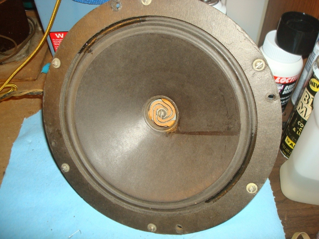

Hello, this is my 1st post in this phorum. I bought a Philco model 70 from Ebay that was in good condition and mostly original. The problem is they didnt remove and pack the speaker (which I had requested), and it came loose and busted the grill. I had the cabinet repaired, and it looks really nice. I havent powered up the radio yet to check things - the seller said it had a low hum and static. The speaker voice coil rubs the magnet when I press the cone. It has the screw in the middle. Before I send this off for a repair, is there some kind of adjustment to center the coil? I havent had any success in searches here on this, and havent found anything on youtube (although there are some interesting videos on rebuilding some of these radios).

You can loosen up that screw and slide the voice coil around slightly. If it is not broken or warped, that is often all it takes.

Thanks for the advice. I loosened the screw and it seemed that it helped a little. I dont know if this type speaker is pretty 'tight', or if there should be pretty free movement of the cone. It may have some crud around voice coil. This is a little different than what I have seen in the past, no spyder or cover over the voice coil. This speaker is tight. Ill know for sure when I power it up and test things. Field and output trans checks ok with the ohmmeter. I had been concerned that the ship damage might have tweaked things.

In fact what you see in the center, the rigid piece of paper through which the screw goes, is actually the spider. Does not add to quality sound, but that is how it is.
I guess you could try to unsolder the voice coil, remove the screws holding the cone and then this central screw, remove the cone (never done it myself but I think this is how it should work looking at the speaker) and try to clean whatever crud or some other cr.... which is in there, and then replace the cone and center it.

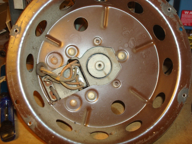

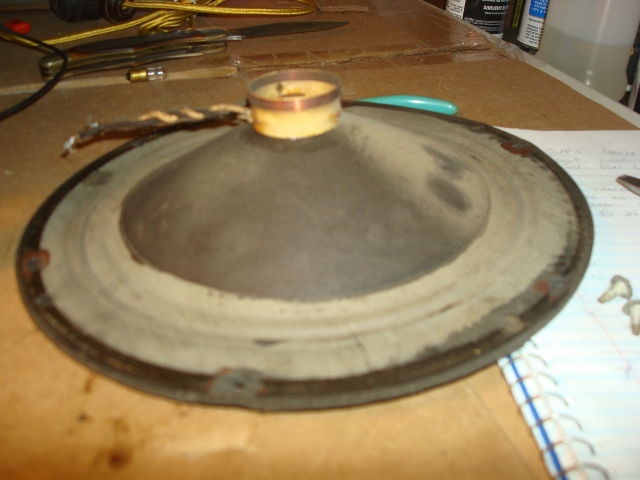

Now that I have the 70 rebuilt and working decent, I decided to tackle this speaker. It sounded pretty bad with a lot of rasping and popping. I unsoldered the voice coil leads, removed the screws and lifted the cone out of the speaker. A word of caution - part of my speaker cone was stuck to the metal frame and started to tear. I used a knife to gently remove it. I didnt have any speaker cement, so I used fabric glue to repair. Also, make sure you guide the screwdriver with your thumb so it doesnt slip off the screw and puncture the cone.
Here are a few pics.

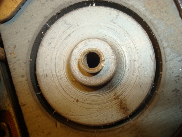

Here was the problem. The air gap is full of a lot of metal shavings. I cleaned out with a small screwdriver, then blew out with compressed air.
I put things back together. Remember the order of the washers in the screw on the spider. I put this screw in first. This centered things. Next I put the outer screws, loose, then gently tightened, pushed the cone to check, then tightened up. A mistake I made was cementing the cone where I ripped it after I reassembled. I had a noise from the tear between the metal frame cone ring. I had to remove, glue the part under the cardboard ring, let the glue dry, then put back together. (I didnt unsolder the VC leads for this) This time, it sounded good.
