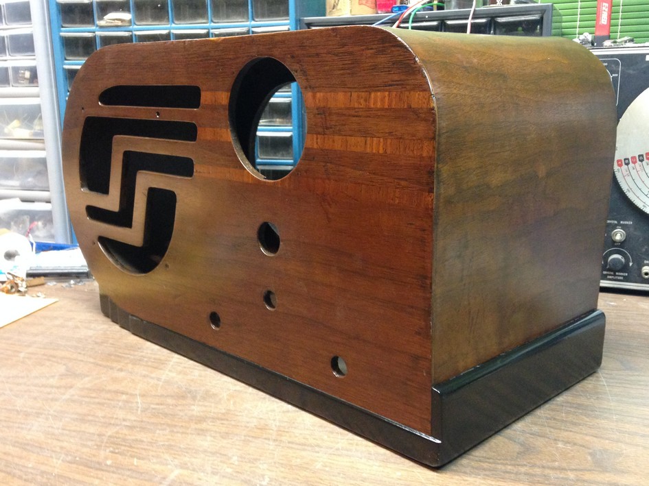

Progress:
[Image: http://www.philcoradio.com/images/phorum/37610_024.jpg]
[Image: http://www.philcoradio.com/images/phorum/37610_025.jpg]
I noticed as I was applying the last coat of Extra Dark Walnut toner that an area of the tape was coming loose at the bottom left, just under the front panel where the side begins to curve upward. Icon_eek
Fortunately, only a tiny bit of Extra Dark Walnut managed to get onto the Medium Walnut and was easily removed. Unfortunately, that took the Medium Walnut with it. But I'll be able to touch it up with some Medium Walnut sprayed into a spray can lid, and a small brush. No big deal.

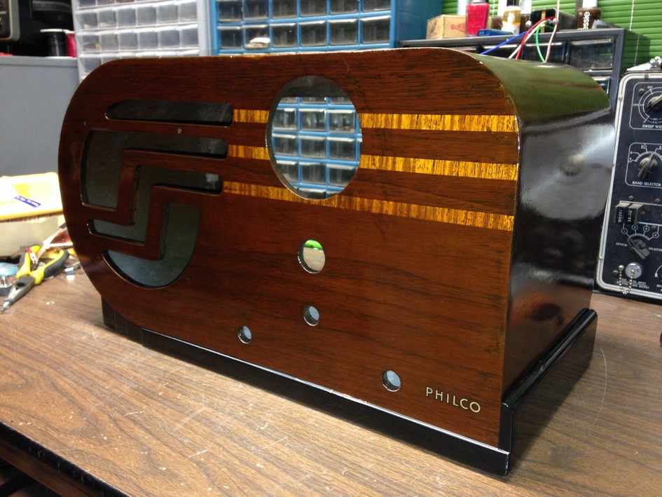

Tonight's progress:

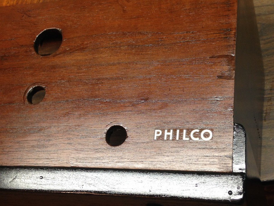

I decided to try something different. Previously when I have refinished cabinets, I applied the PHILCO decal before the final two coats of clear.
This time, I applied the decal before I began to spray on the clear coats.
[Image: http://www.philcoradio.com/images/phorum/37610_026.jpg]
Pardon the poor photo, sorry, too much glare from the lamp over my workbench.

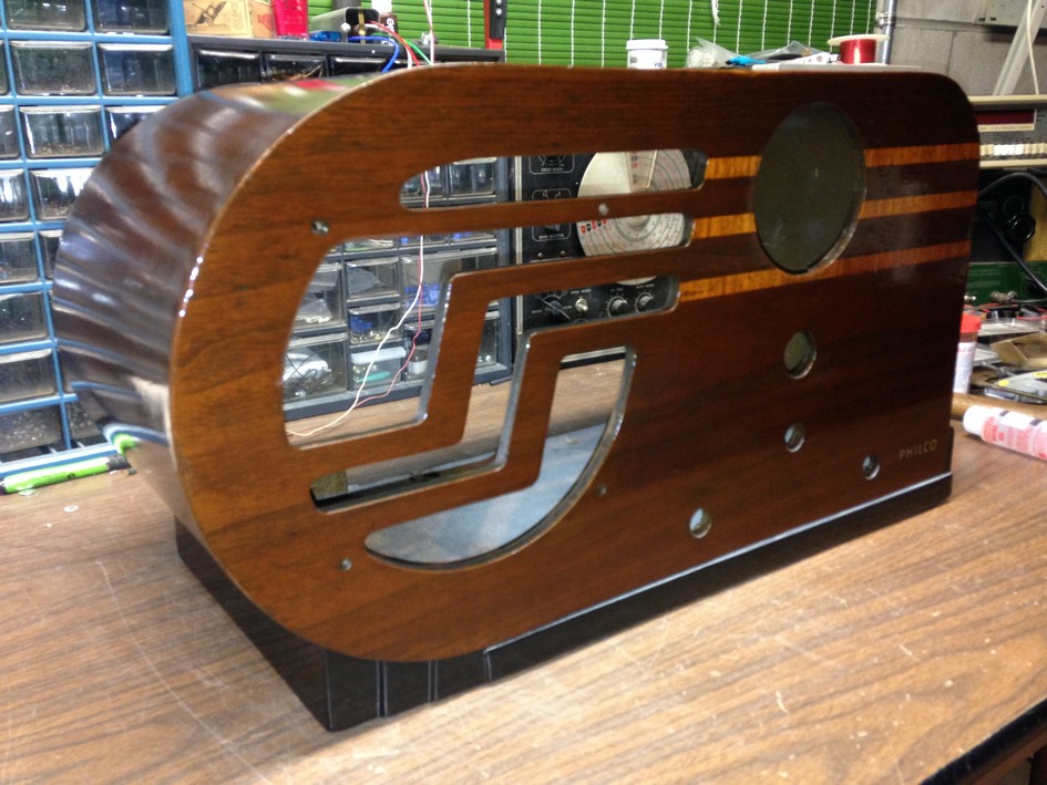

The next job was to begin applying clear lacquer.
I sprayed on three coats of Deft.
[Image: http://www.philcoradio.com/images/phorum/37610_027.jpg]
Unfortunately, my camera decided to focus on the test equipment in the background rather than the radio. Icon_eh Icon_mad

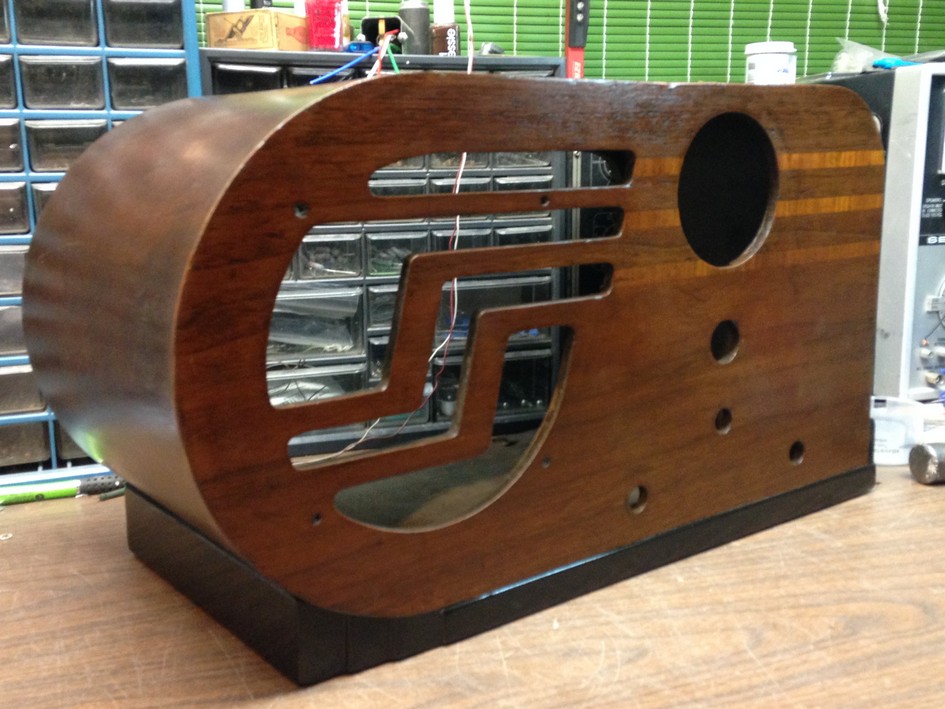

Two more (and better) photos:
[Image: http://www.philcoradio.com/images/phorum/37610_028.jpg]
[Image: http://www.philcoradio.com/images/phorum/37610_029.jpg]
The cabinet is really starting to look good now, in spite of the flaws it has. The finish is nice, shiny and deep.
Speaking of flaws: I managed to get a minor run on the left edge of the large grille opening. I think I will be able to make that go away with some careful sanding, though.
I'm glad I applied the decal after toner and before clear. I think it is going to look much better this way, and I think I will do this with all cabinets I refinish henceforth.
The grain is completely filled now! Icon_thumbup Icon_thumbup
Next, I plan to wet sand with 400 or 600 grit wet/dry paper, then give it a couple more thin coats. Following that, I will wet sand again with 1000 grit wet/dry paper, spray on two thin final coats, let it cure, then rub the cabinet down with rottenstone.

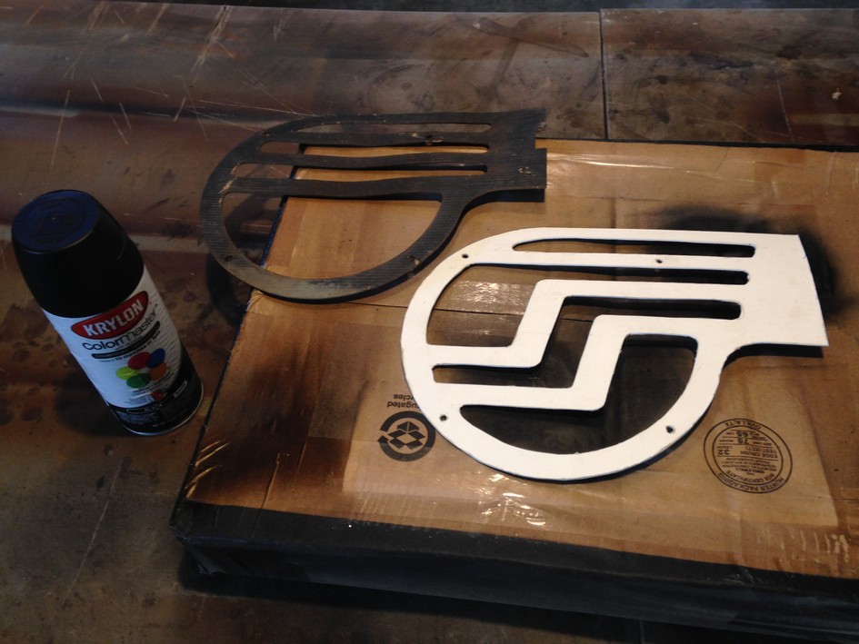

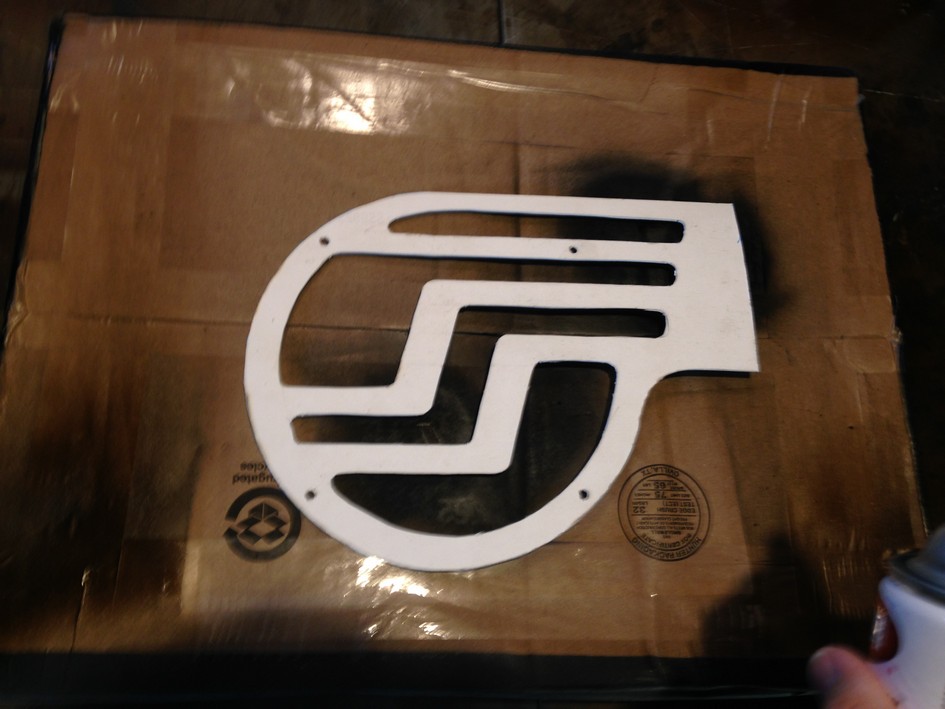

My next move was to make a backing board for the grille cloth.
[Image: http://www.philcoradio.com/images/phorum/37610_030.jpg]
I used an old 37-610 early version backing board as a template, but before I cut the holes, I placed the new one behind the grille of the cabinet and then traced the outline of the cutouts so they would match the grille.
Then I cut out the holes...
and was left with this:
[Image: http://www.philcoradio.com/images/phorum/37610_031.jpg]

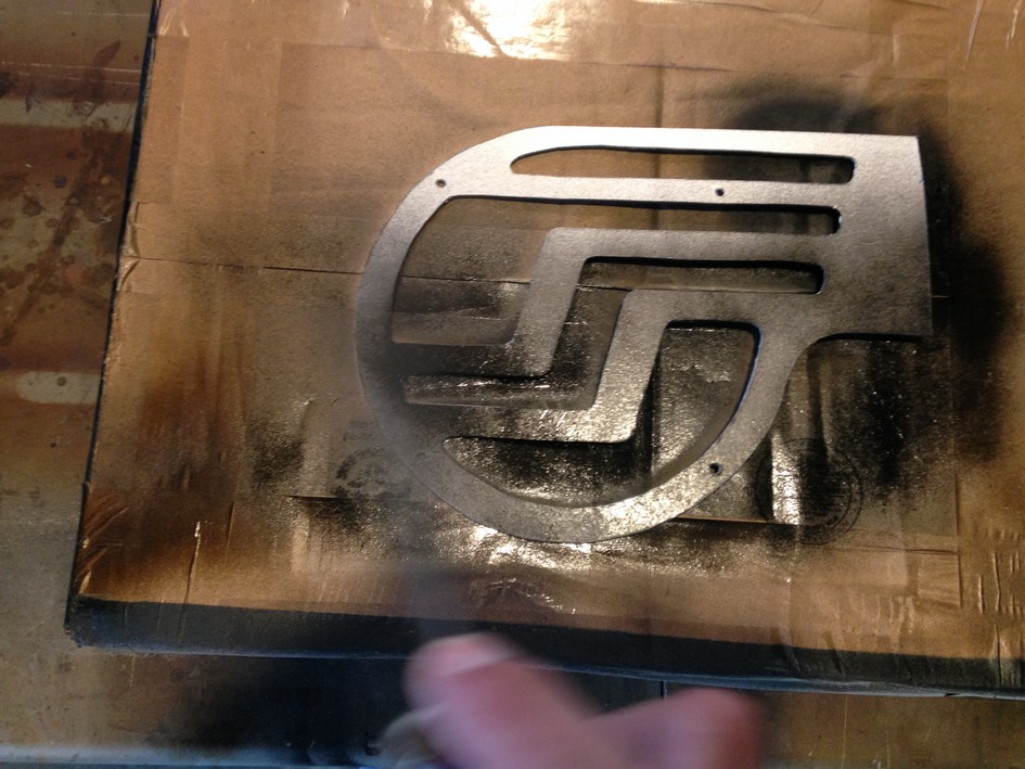

This is backing board for picture frames, which is dull black on one side but white on the other, so the white side had to be painted black. I used Krylon Satin Black.
[Image: http://www.philcoradio.com/images/phorum/37610_032.jpg]
After the application of two coats of paint, I let it dry. While the paint was drying, I went into my extremely limited supply of grille cloth from Radio Grille Cloth Headquarters and cut out a piece of Philco "Ribbed" cloth, enough to cover the new board. I tried my best to iron out the crease, but could not get it 100% ironed out, so I let it go as "good enough".
Then, I sprayed some Super 77 on the newly painted surface of the backing board, let it sit for about 15 minutes, and then applied the cloth to the board. It turned out well. Sorry, no photo.

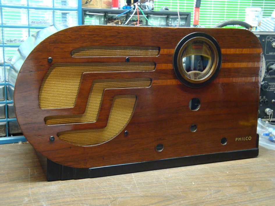

So...after almost three weeks of curing...I decided today that it was time to rub the cabinet down with rottenstone and then give it a coat of wax.
I had previously purchased some rottenstone, a felt pad, and some "Wool-Lube" (what the guy behind the counter said I needed for a lubricant) for this purpose.
Bear in mind that I had never done the rottenstone process before...so I watched one of Bob Andersen's videos on how to do this. I noticed the only thing he had different than me was generic mineral oil instead of Wool-Lube.
Wool-Lube is more of a gel than a liquid. I think that the next time I do this sort of work that I will purchase mineral oil and use it instead.
But anyway...the rottenstone process seemed to work well; any remaining slight roughness on the finish was gone after the rubdown.
I then wiped the cabinet down with a clean rag.
Next, I began to wax the cabinet.
I have a very old can of Minwax wood wax. Old, and harder than heck to polish out...but it leaves a good wax coating.
Finally, after lots of elbow grease, I had a nicely waxed cabinet.

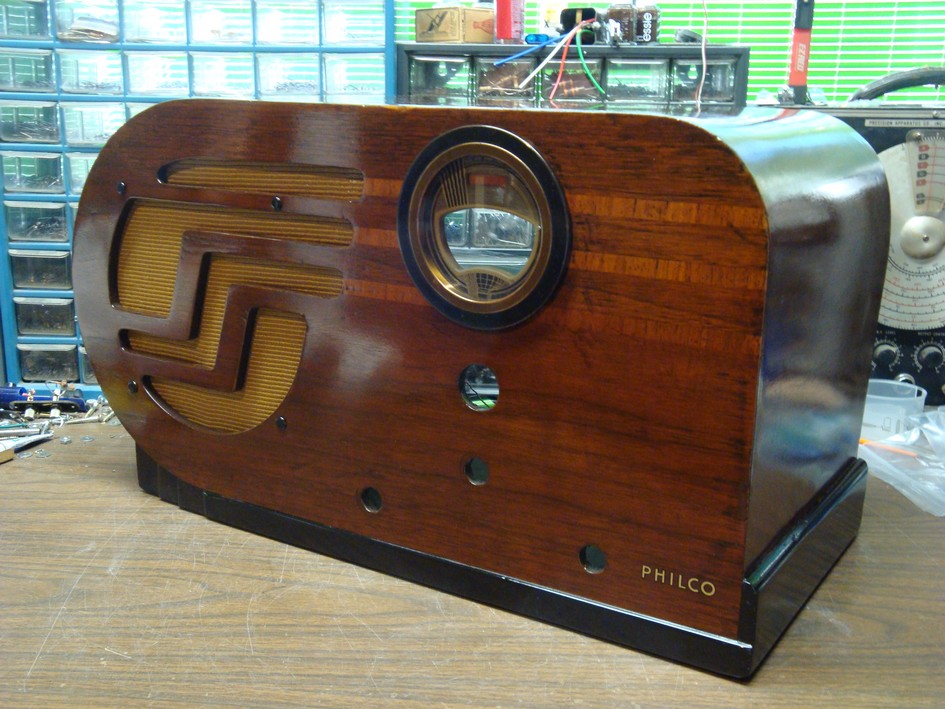

I installed the speaker screws (which I had lacquered a week or so ago), the grille cloth/backing board, and the escutcheon.
The final result:
[Image: http://www.philcoradio.com/images/phorum/37610_033.jpg]
[Image: http://www.philcoradio.com/images/phorum/37610_034.jpg]
[Image: http://www.philcoradio.com/images/phorum/37610_035.jpg]
Overall...not bad, I think. Not perfect...but not bad. The grain is filled and the surface is super smooth. Those were my main two goals.

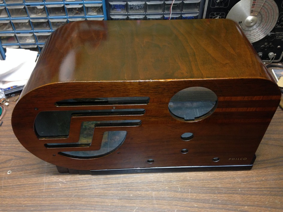

Next up:

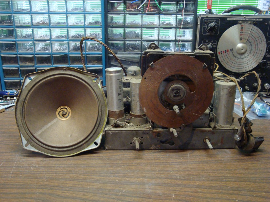

[Image: http://www.philcoradio.com/images/phorum/37610_036.jpg]
To clean up and attempt to restore this 37-640 chassis, for use in this cabinet. But that is a story for another thread.
