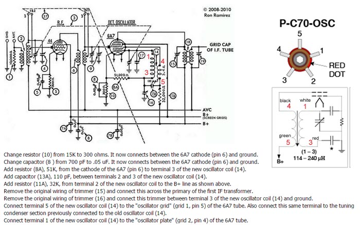

Here is a circuit diagram that I ended up using with the coil pinouts noted on Ron's circuit.
I attached colored wires to the pins and mounted the coil on a piece of aluminum up inside the oscillator coil can.  The color choices were mine, and you can refer to the pin numbers to identify the actual connections.

A couple things to note.  I found that a good place to wire the 110 mmf capacitor is right across pins 3-5 of the coil.  It saves trying to find a connection point somewhere else under the chassis.  Also, I might add two steps to Ron's list, if you are using the steps as a checklist.
a. Be sure to disconnect the secondary of the (6) RF coil from ground and make the connection to the AVC buss.
b. Connect pin 2 (plate) of the 6A7 tube to the primary of the (18) IF coil.
Certainly if you follow Ron's schematic, you will not miss these steps.

If anyone is having oscillator problems with a Philco 19/89 (71 or 91 also) this is the fix. I had not thought about buying a coil. But honestly, it is not that difficult to rewind the original. with no more turns than this coil has, a winder is not necessary.
Quote:I don't know how well the SW (police band) works after this mod. On these radios
 Should work just fine. The band switch does not change the oscillator frequency on these radios. The tuned frequency just moves to the high side of the oscillator.
