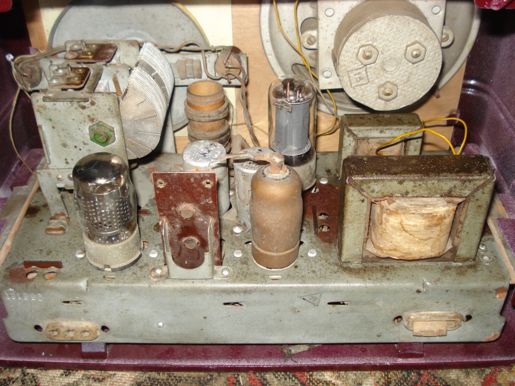

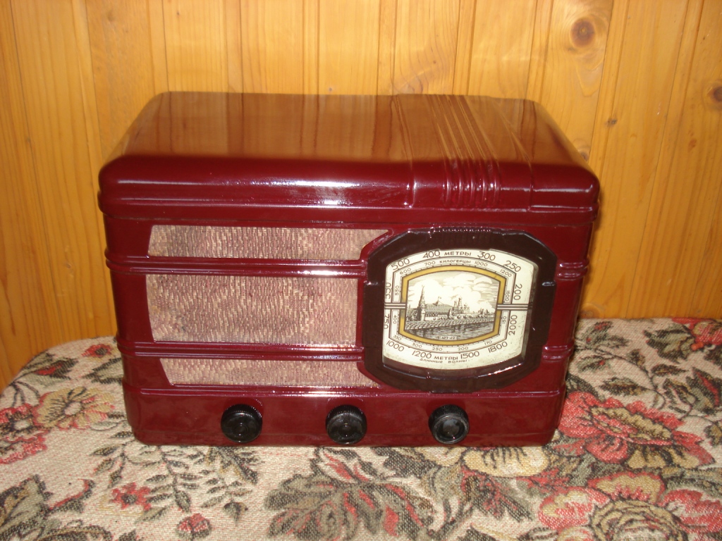

As already mentioned, the first model of the "people's" radio ARZ-49 turned out to be not very successful and reliable, and therefore, in two years, this radio was upgraded and produced at various enterprises under the indexes ARZ-51 and ARZ-52. The main changes in the design were the replacement of the selenium rectifier on the 6Ц5C кenotron and the replacement of the output radiation beam 30П1C with a 30-volt getter voltage on the tetrod 6П6С. Thus, this one of the simplest superheteradins in the USSR has become a 4-tube radio. In the photo ARZ-52 from my collection.The exterior model from the old differs only with variants of colors, matter and small changes in the design of the scale - the ARZ-49 inscription disappeared.
But on the chassis the changes are more prominent ...

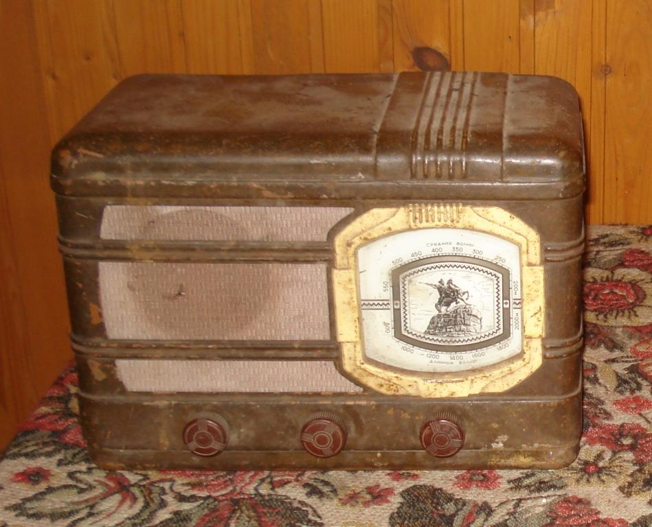

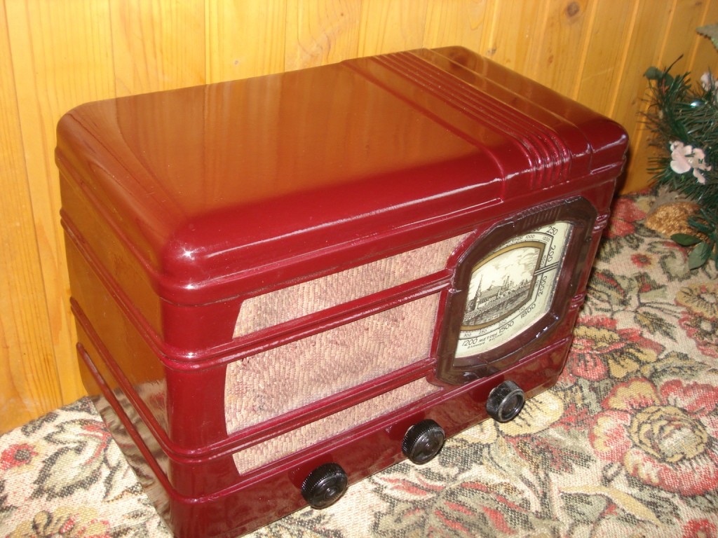

The next model ARZ, which began to be manufactured since the 54th year, almost did not differ from the model 52 - all the differences consisted in a more varied coloring of the cabinet and three variants of the scale design, since the device was manufactured on three occasions by enterprises, including Ukraine. On the photo of ARZ-54 manufactured by the Zaporozhye plant "Radiopribor" from my collection before the restoration. Now it is being restored and a week later should be ready ..

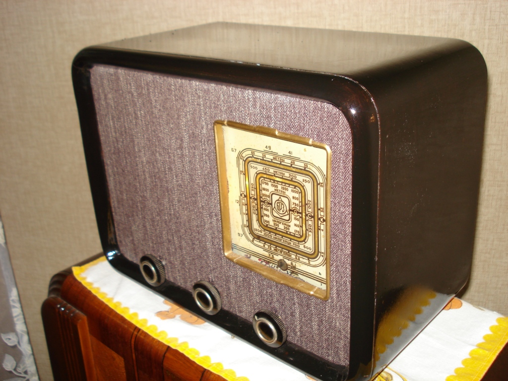

The next story about "folk" radio in the USSR will be about the model of Record 52, which was made in 1952. Unlike the previous model, Record 47, this radio was made on only 6-volt series lamps and with a transformer power supply .. This topology of the circuit for radio on 5-wire radiolamps has become dominant for almost the next decade. My new radio receiver of this series is still in restoration, and so I will show a photo of the previous Record-52, which is now owned by one of my colleagues in the United States.

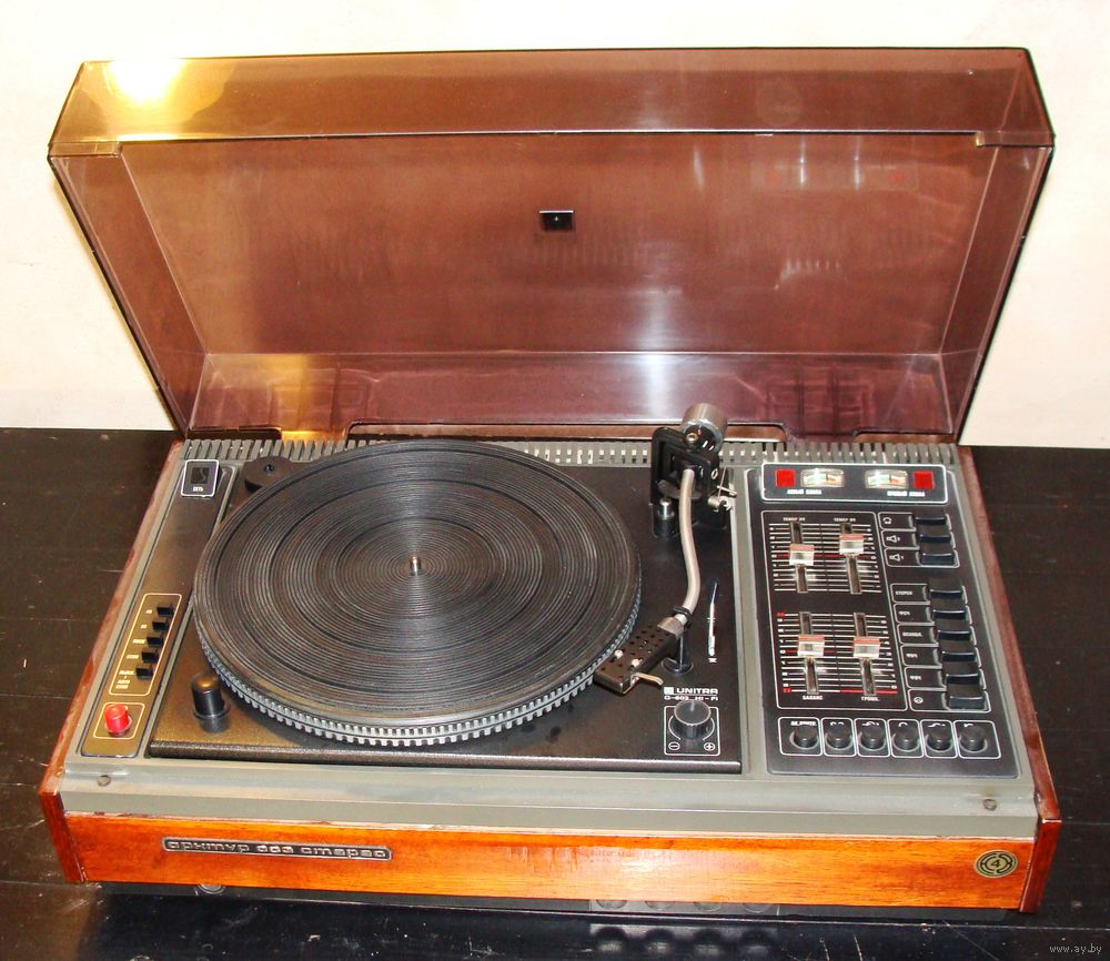

БРЗ - Бердский Радио Завод - Berdsk Radio Factory, the first one that started making Soviet Hi-Fi equipment, some of which (Arctur-003 turntable + amplifier + speakers combo, and Arctur-006 turntable) I had as my first.
Arctur-003
Arctur-006
https://ru.wikipedia.org/wiki/Вега_(прои...ъединение)
Yes Michael. In the 70's ... 80's the Berdsk Radio Factory was one of the leaders of Hi- Fi technology in the USSR

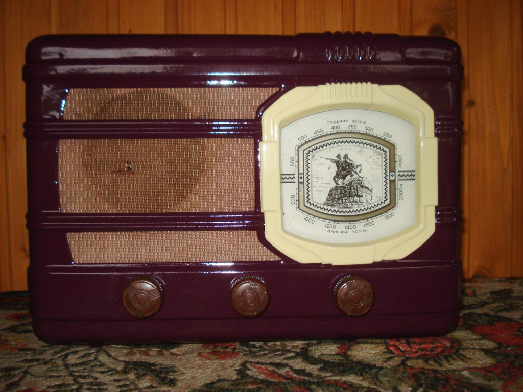

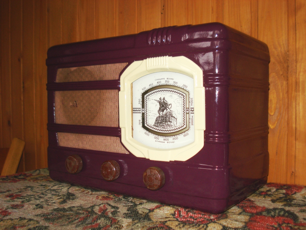

Today completed the restoration of ARZ-54. Now he has this look. Unfortunately I do not have a new grill yet

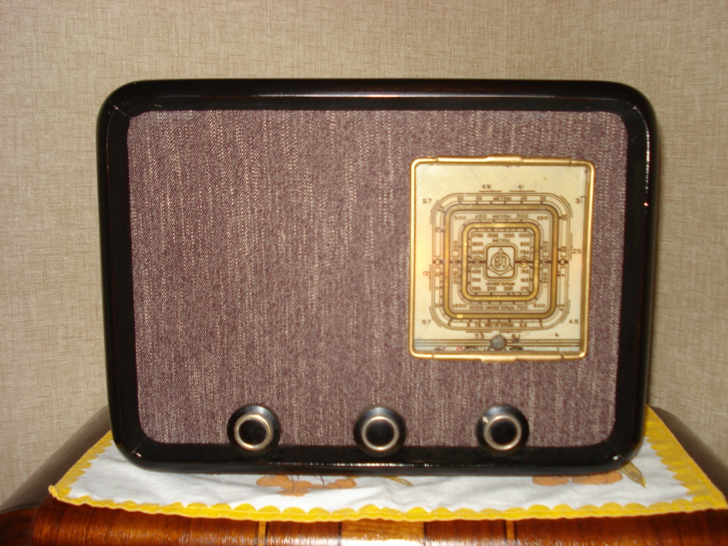

After a short pause, which arose due to the unbearable summer heat and my laziness Icon_mrgreen , I will continue the story of the Soviet radio class "Folk radio" ... In the past month, he has restored two radio with the abbreviation "Record" - models 52nd and 53rd years. Both models are five-lamp radio and are very similar in the schemes. The only significant differences between them are only in the design of the case, the frequency of the intermediate frequency and the design of the contours of the IF. In the record 52, the IF is 465 kHz, while the 53 is at 110 kHz.
"Record" - models 52. This radio is also made at the Berd Radio Factory

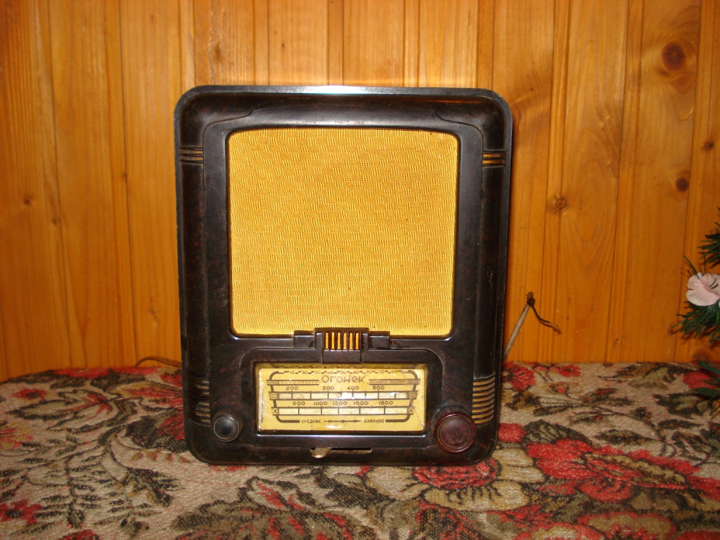

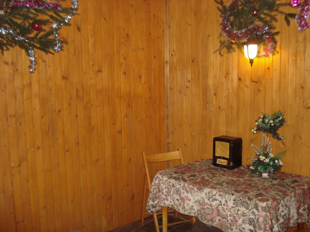

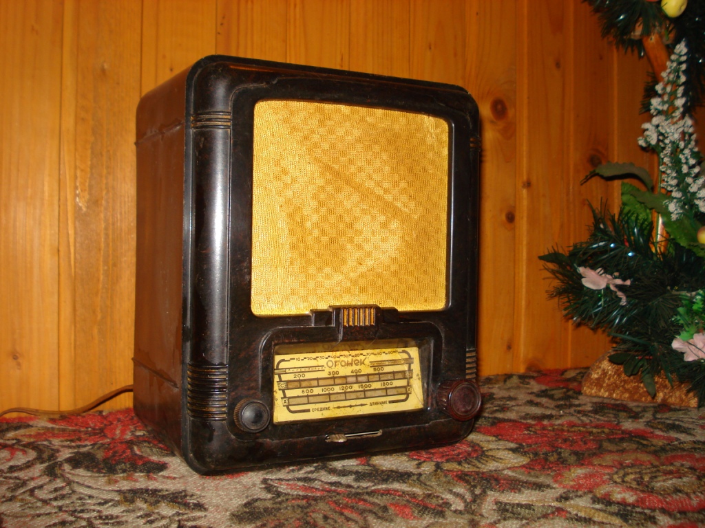

Hello everyone and the upcoming New Year! After another "little" pause, I will continue to demonstrate the receivers from my collection. I will finish the conversation about "folk radio" by two beautiful and stylish radio receivers in Bakelite buildings - "Огонёк" (Fire) and  "Стрела"(Arrow).
The radio network lamp "Ogonyok" since 1953 produced the Moscow radio plant Red October. The receiver is a 2-band superheterodyne, has 5 radio tubes, and is powered by a network of 127/220 volts. I just bought this receiver quite recently, and so I did not manage to bring it to an impeccable state. But this winter I have big plans.But we can say that such beauties always please their owner ... Icon_biggrin

I have an impression this radio was inspired by somd of those German People's Radios, Volksempfängers.
So . And with a later version of 38 ... 44th years, there is even some kind of external resemblance. But the main thing for such receivers is the propaganda mission - to broadcast only local stations and to glorify the leaders of communism and Nazism ... In fact, such radio in prewar Germany and in the USSR were made exclusively for this purpose and were the most massive, despite the small assortment of models.
