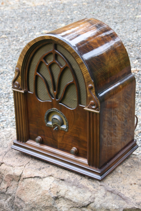

That is how I got this effect on a Clarion cathedral:

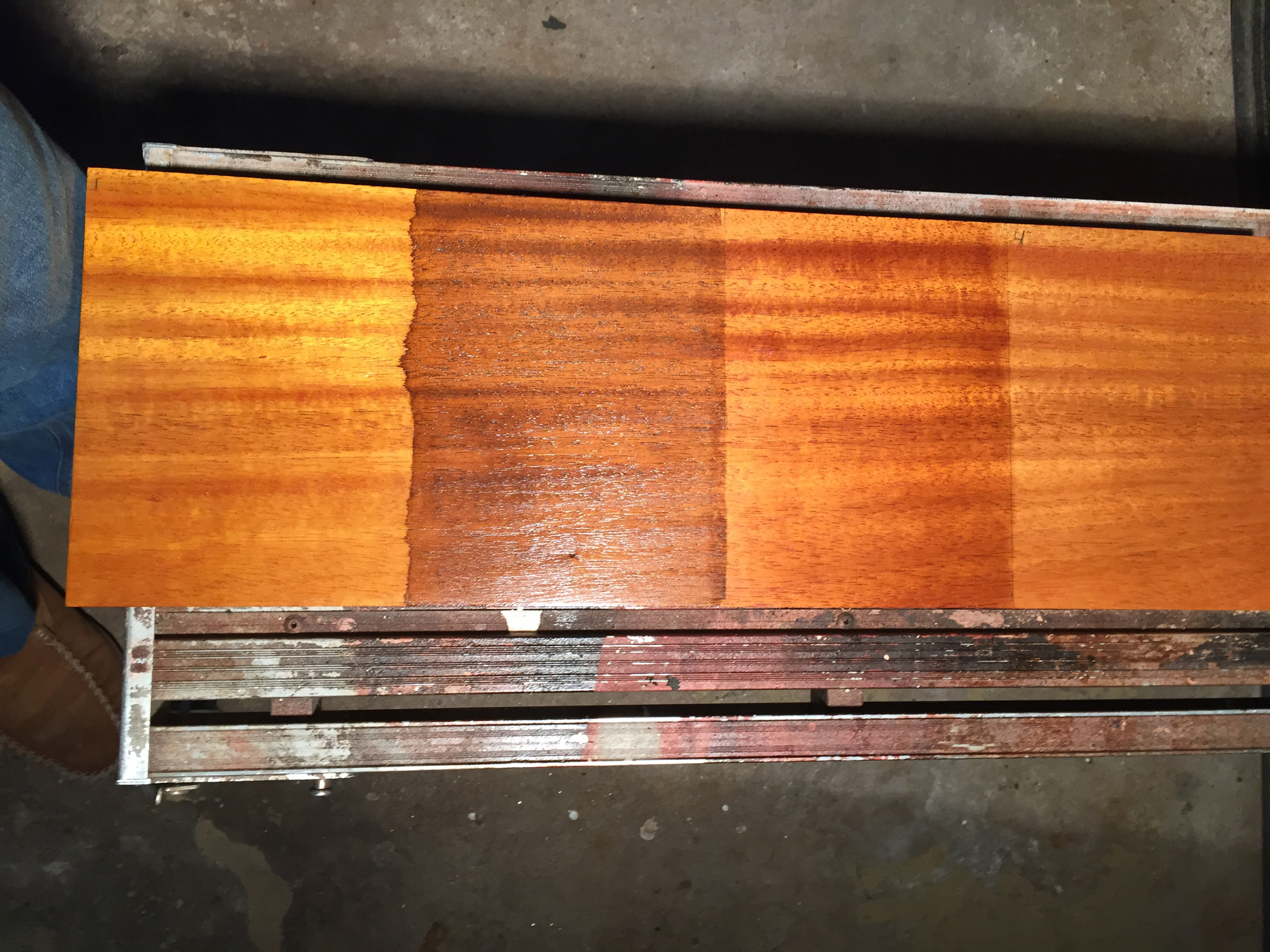

Today I started on my test board. In the picture you will see 4 sections. From left to right are the following, Yellow dye stain, Medium Brown Walnut pigment stain, Light Golden Oak dye stain, and bare wood. All stains were dry brushed after application to keep from getting blotchy. There is a coat of Zinnser Seal Coat over everything.
Next will be a 400 grit sanding followed by grain filler. Since I am grain filling the top , front, and sides of the cabinet, I want to get an idea of how the colors will show up. This way if I need to stain, I will know what direction to go.

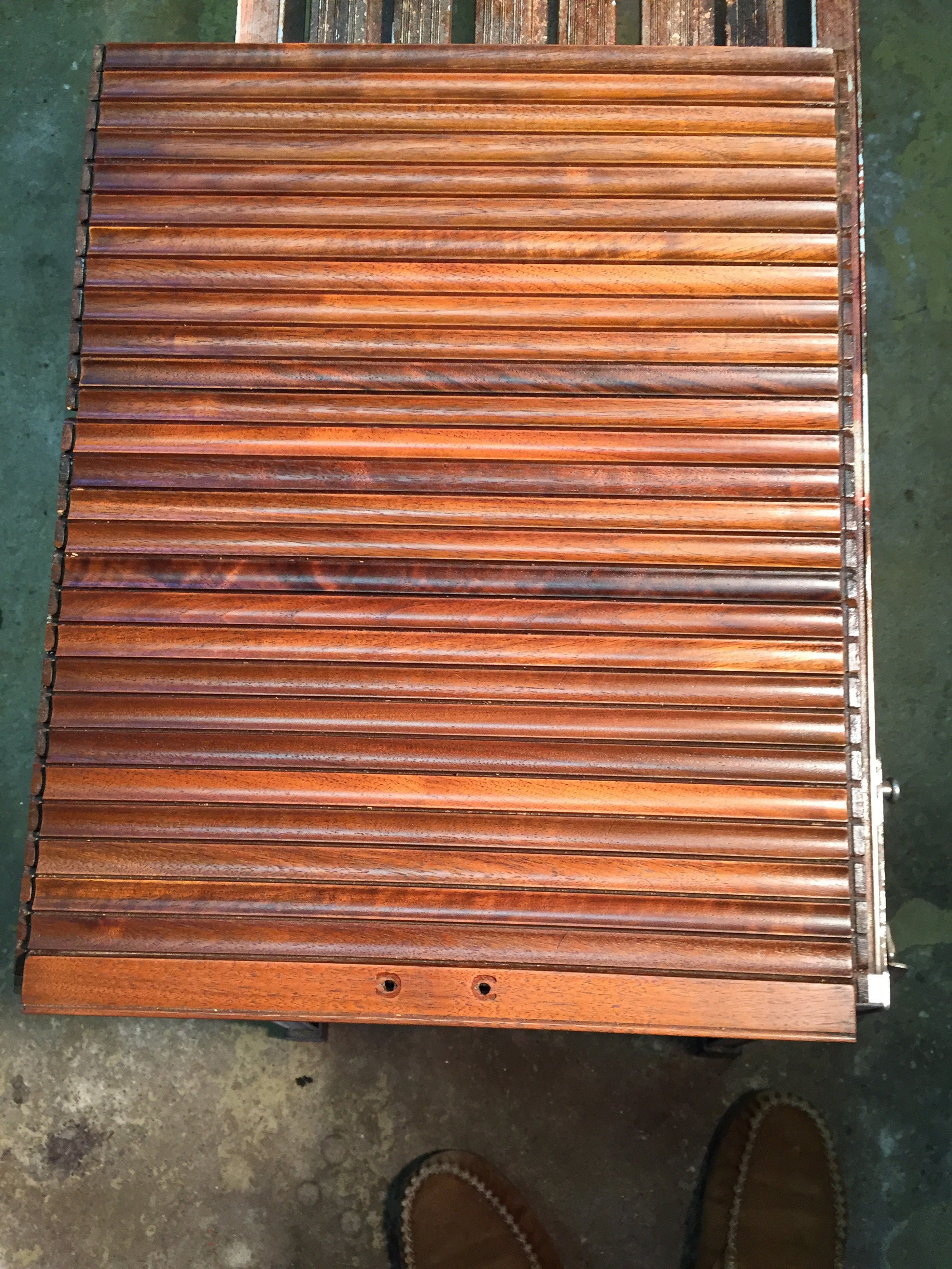

The roll top has two coast of spray sanding sealer on it, and I would say a light sanding and it's ready for a top coat when I am ready to do so.

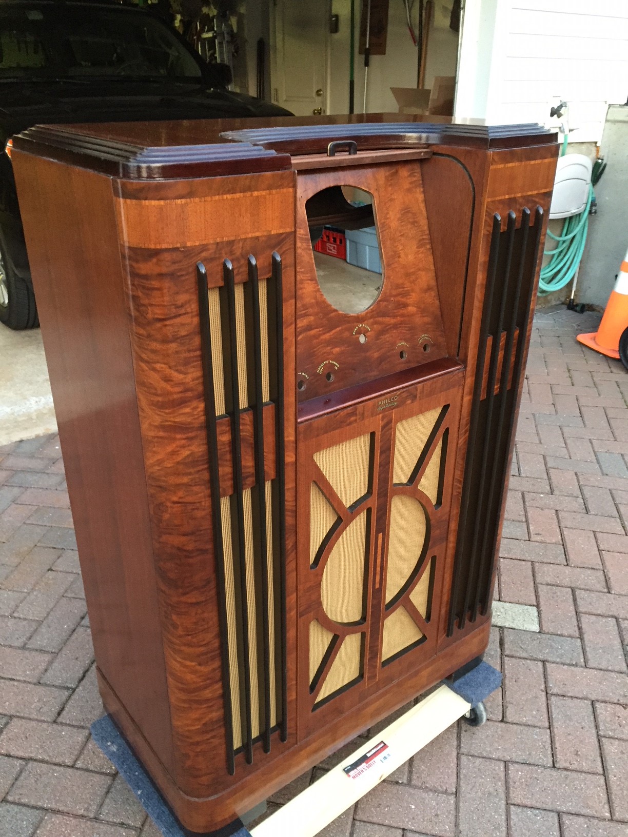

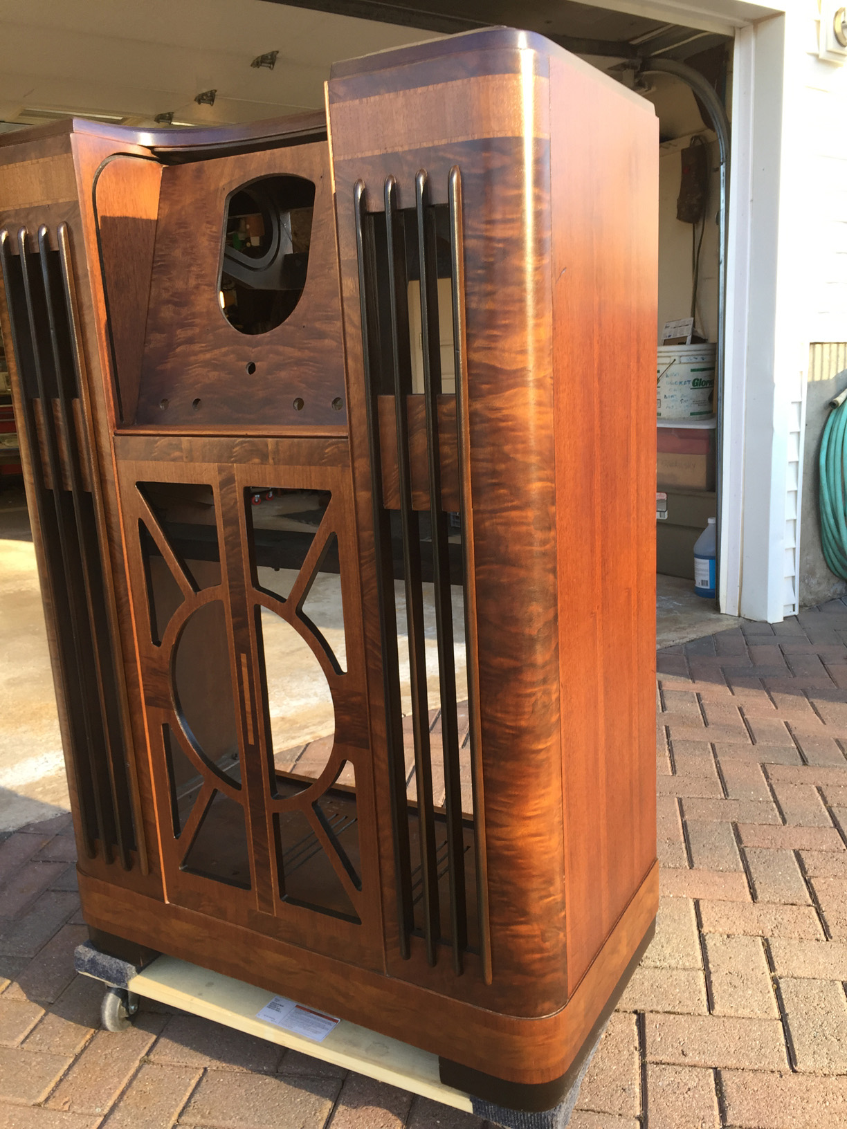

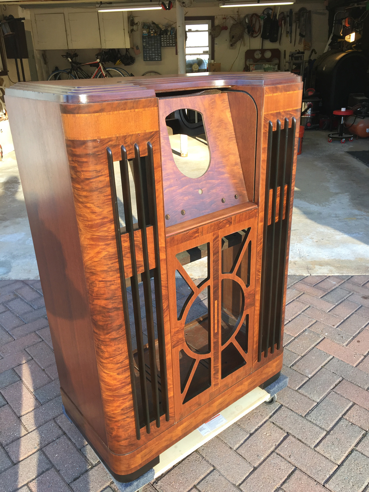

Well much progress on my cabinet finally. Currently everything is close to being ready for a top coat, as it is sealed with sanding sealer. 23 steps so far.
I have to decide if I want the rim around the top to be darker. I did the grille bars with VanDyke Brown, but thought the rim should be lighter. There is one section between the bottom of the front panel and the radio front, a narrow board, that is too light. Can't really tell from the pictures. That could get a shot of Extra Dark Walnut classic toner to blend it in.
Once ready, I will spend some time with my new sprayer, a Fuji Mini Mite 3 stage HVLP unit. I will practice on a spare piece of wood so I can get my pattern and flow right. Plus learn how to shoot vertical surfaces too.
Here are some quickly shot pictures I took today so you can get an idea of the project so far.
Tony
Beautiful!
Icon_smile
The grille bars should be Perfect Brown (much lighter than what you used, but slightly darker than Medium Walnut), not Van Dyke Brown.
Y'all speaking Chinese.
Fantastic!
Ron and everyone, thanks for your comments.
I will look into stripping off the grille bars and see how hard it will be without causing other problems. I do like it this way, but I fully understand it's not close to original color. Somewhere I saw a picture of one done similar and we all know what happens when you assume.
Tony

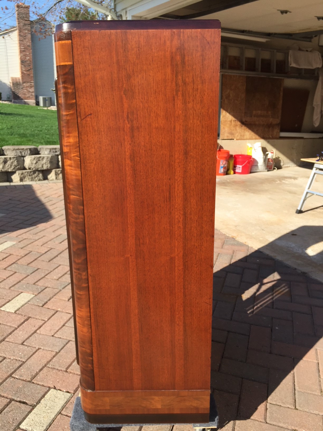

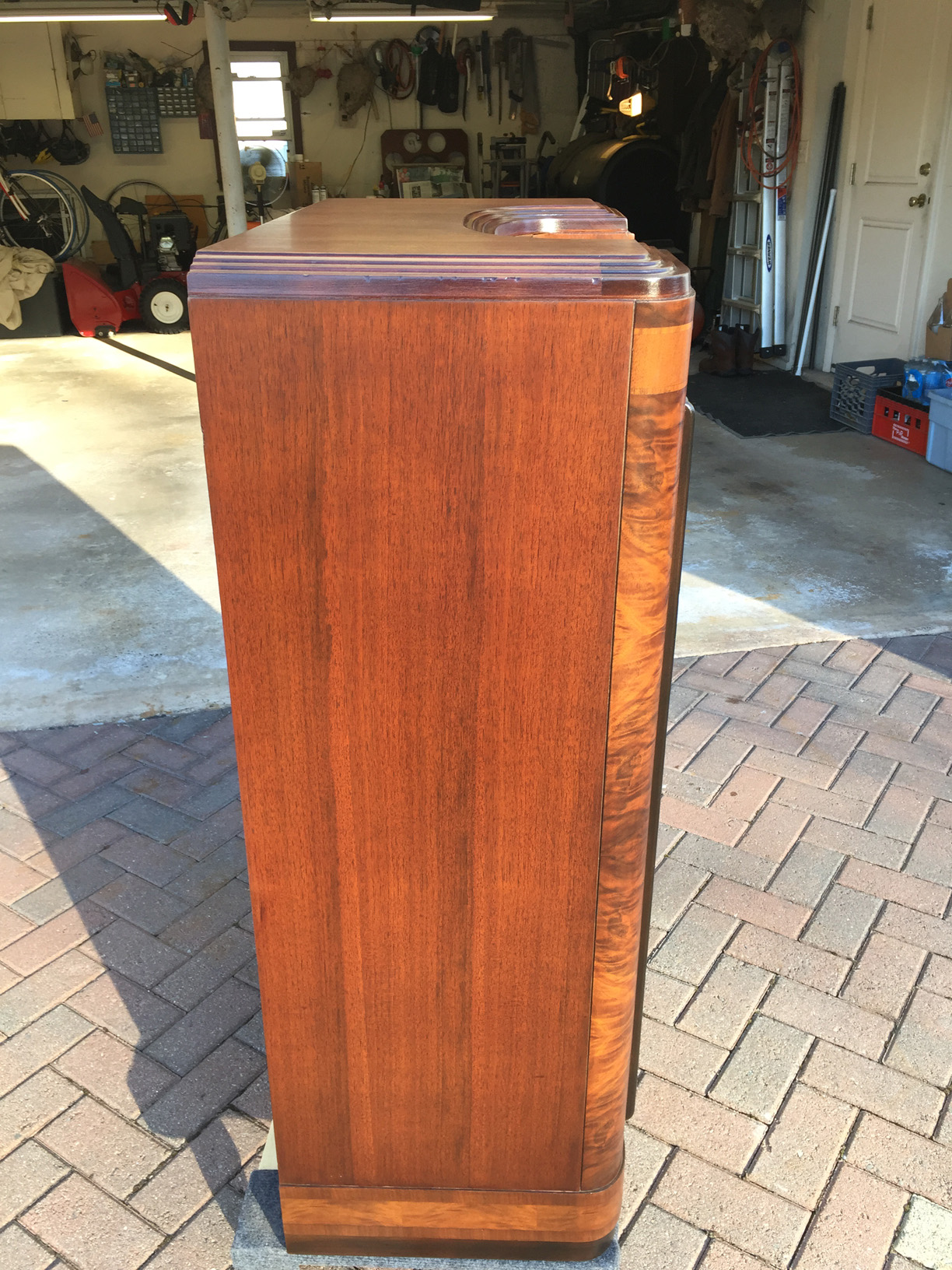

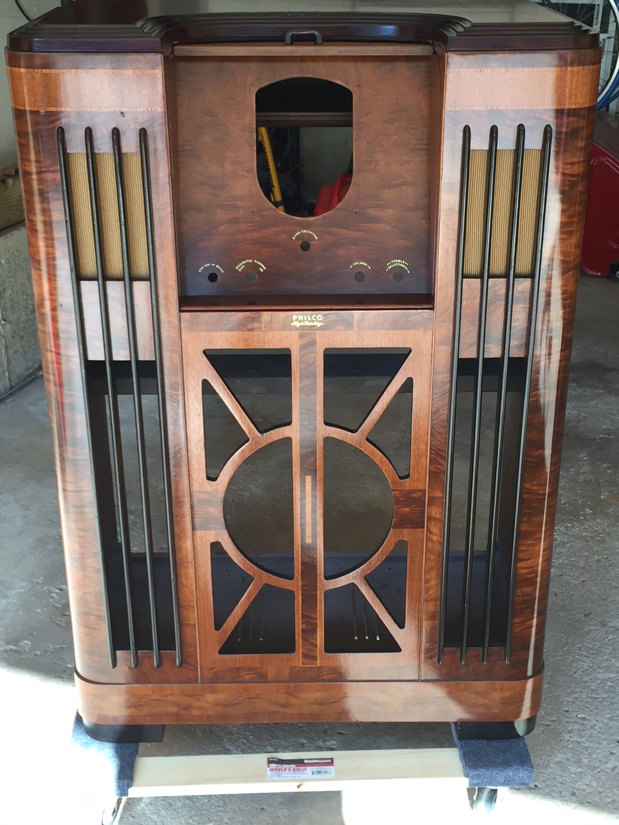

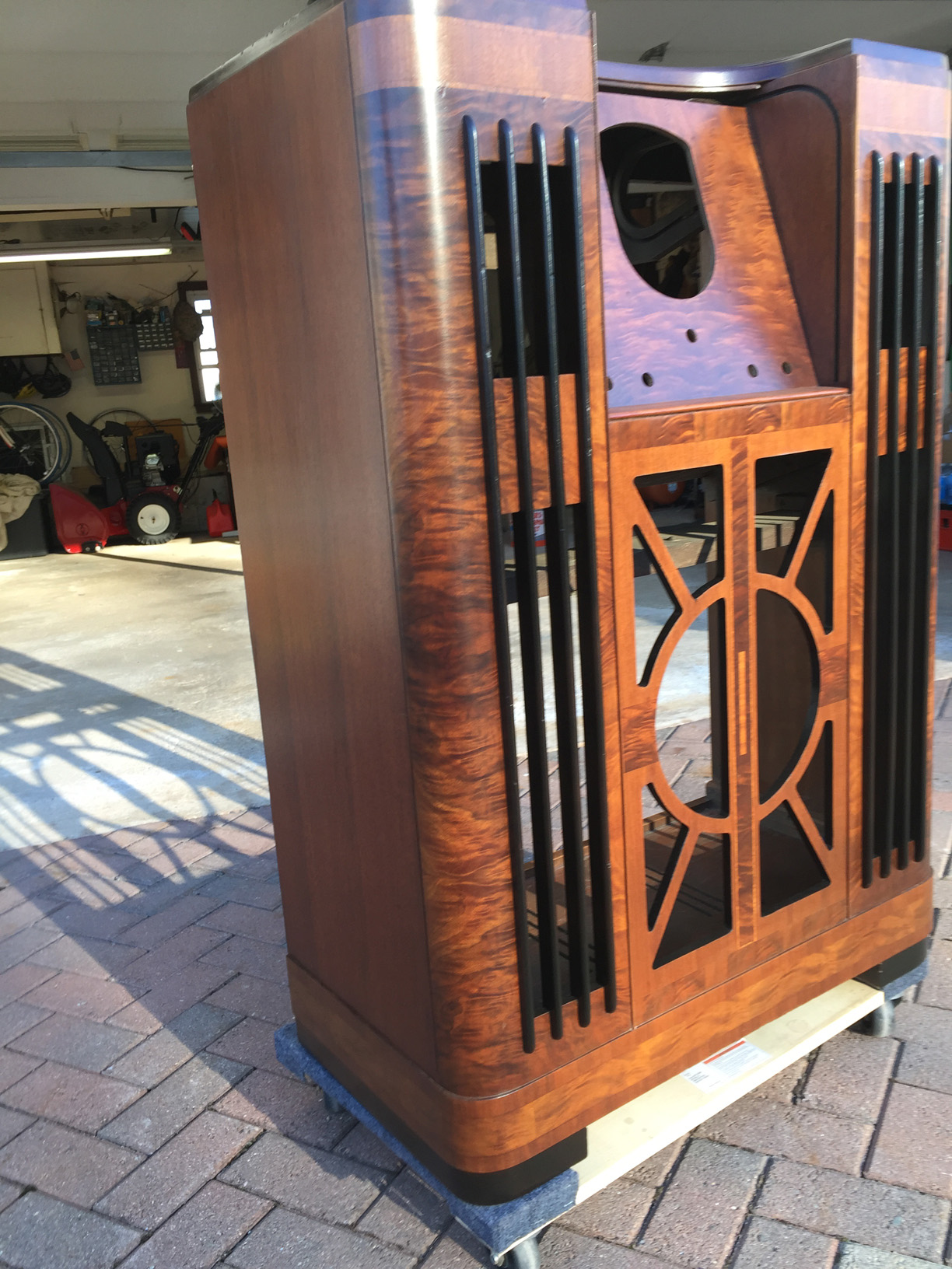

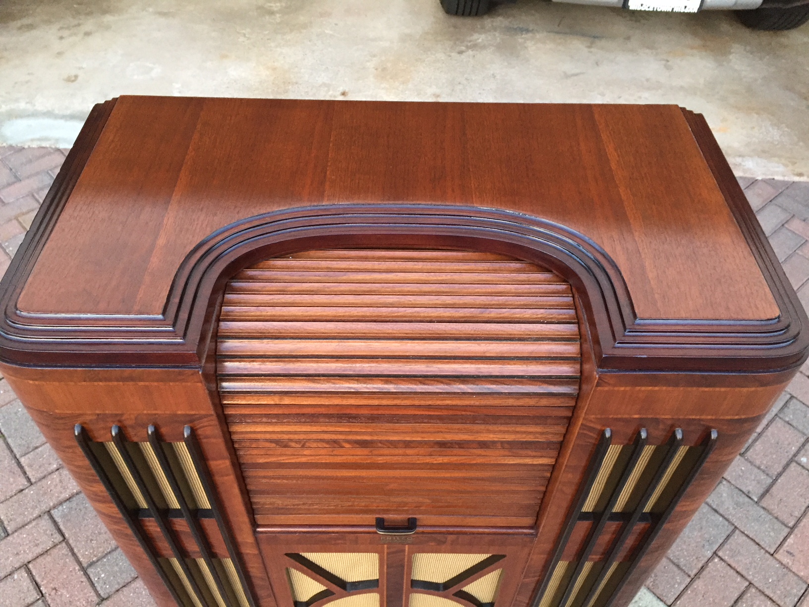

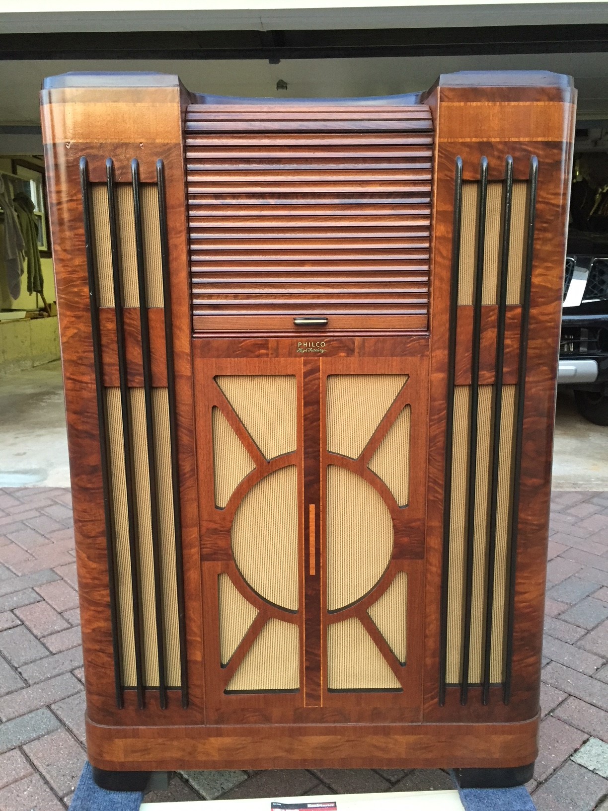

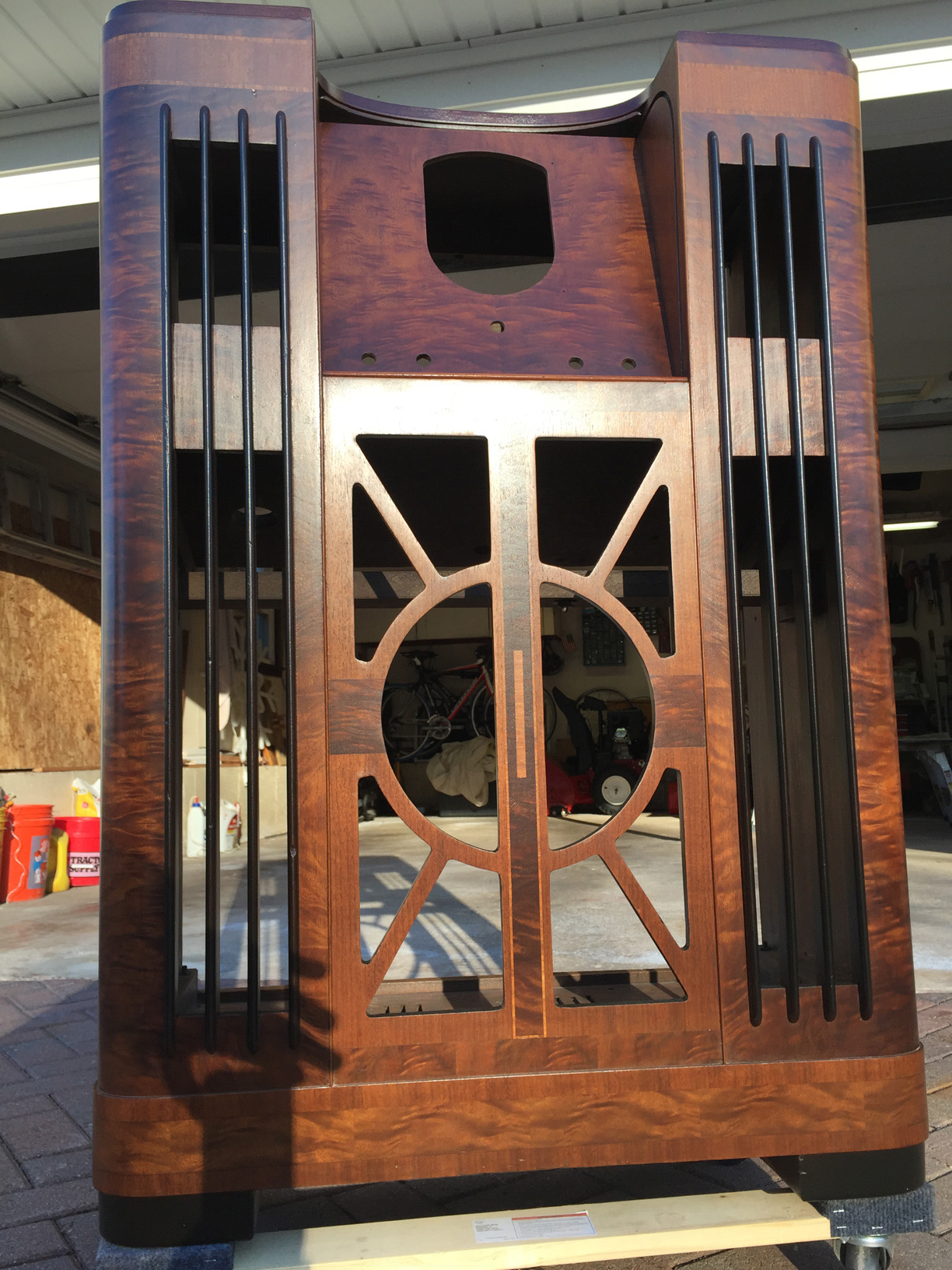

Well it's taken me a while, but I am at the point where I really like this radio, and I am done spraying. I had a big learning curve with my new HVLP sprayer. I practiced a lot on a scrap piece of Luan and did a lot of vertical spraying so I could feel confident about not getting runs with a good wet coat.
I made the decision not to strip the Grille Bars and re-tone. I fully understand this is not original, but I like it and I didn't want to strip and start over on the front.
I would like to know if this is too glossy, as I could knock it down a notch and rub it with 0000 wool and wax. I think a true rub-out, if done properly, would make it shine more, and might be beyond my skill level. Especially with the tight spaces and rounded corners. Right now I am two weeks into the curing process, so there is time to decide.
Here are the pictures. The lighting in some of the pictures don't really show the true gloss, especially the top and side views.
Tony
Well,
I can't say that I blame you re: not redoing the grille bars. They may be darker than original, but overall, that cabinet sure is purty. Icon_thumbup Great job!
Wait 2 weeks then buff it out.
(05-05-2018, 10:38 AM)Phlogiston Wrote:  Wait 2 weeks then buff it out.
Could you explain your method of buffing it out? If I’m thinking right, you mean buffing it with the wax. True rubbing out requires pumice and rotten stone, the way I understand it. This part of finishing is new to me, so I want to learn what I can.
Thanks,
Tony
