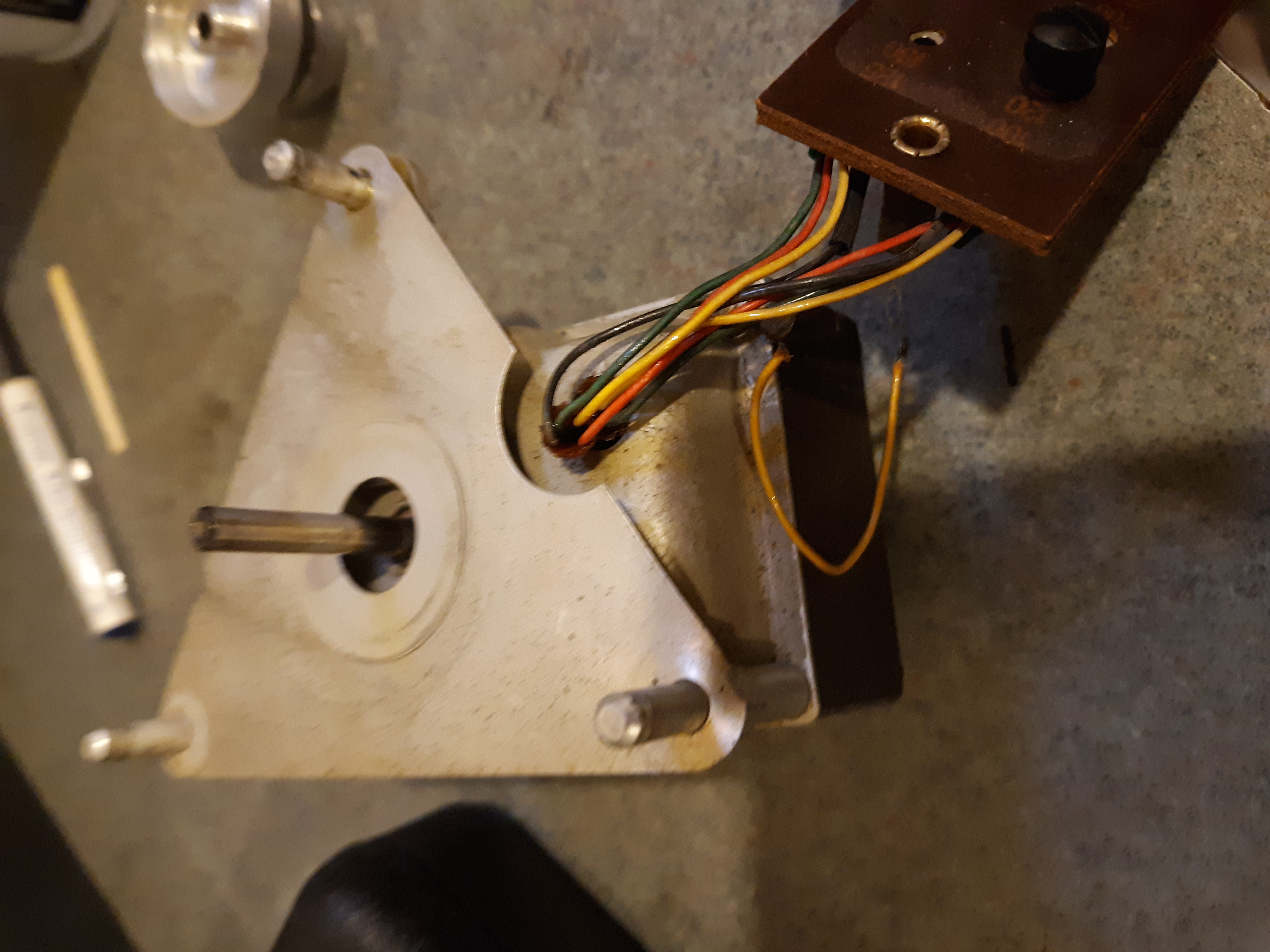

Took the motor off. Only had to desolder two things: resistor and a wire from the cable.
Better than all 6 colored wires, same colours times two, so photo wouldn't be enough, would have to label.

The pulley is not coming off.
I certainly do not want to pry it off, let alone there is nothing to pry it against: thin metal plate, already bent...
So I am administering penetraiting oil drip. Hoping it'll come off, same way the idler did.

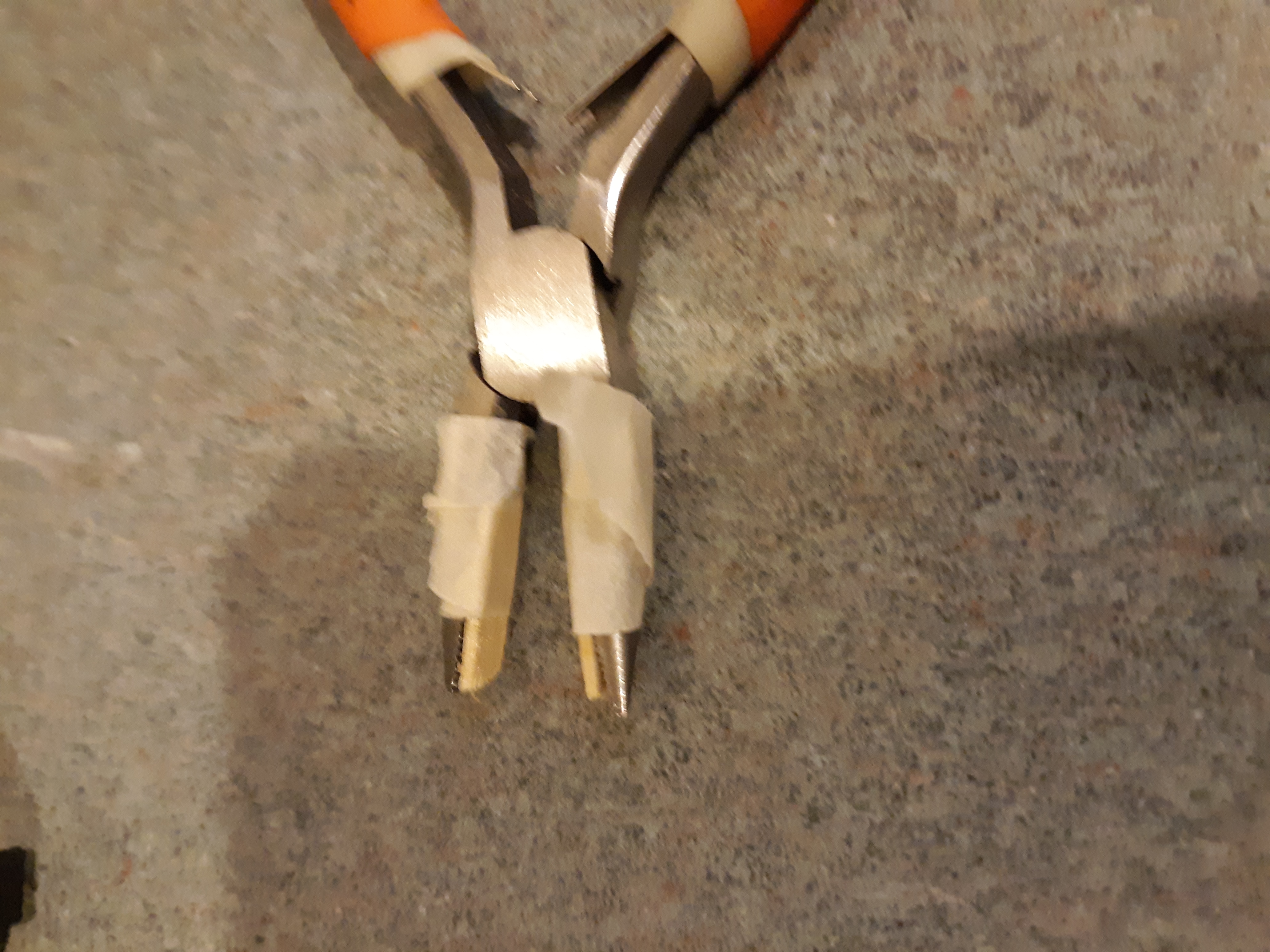

So..I took stubby needlnose pliers that could get to the shaft (space between the triangular plate and the motor cover is narrow). To not scratch the shaft I took two thin wood chips, taped them to the tips of the needlenose (just to hold them in place 'till I reach the shaft),
then inserted them between the plate and cover, squeezed,  twisted the pulley and it came off.

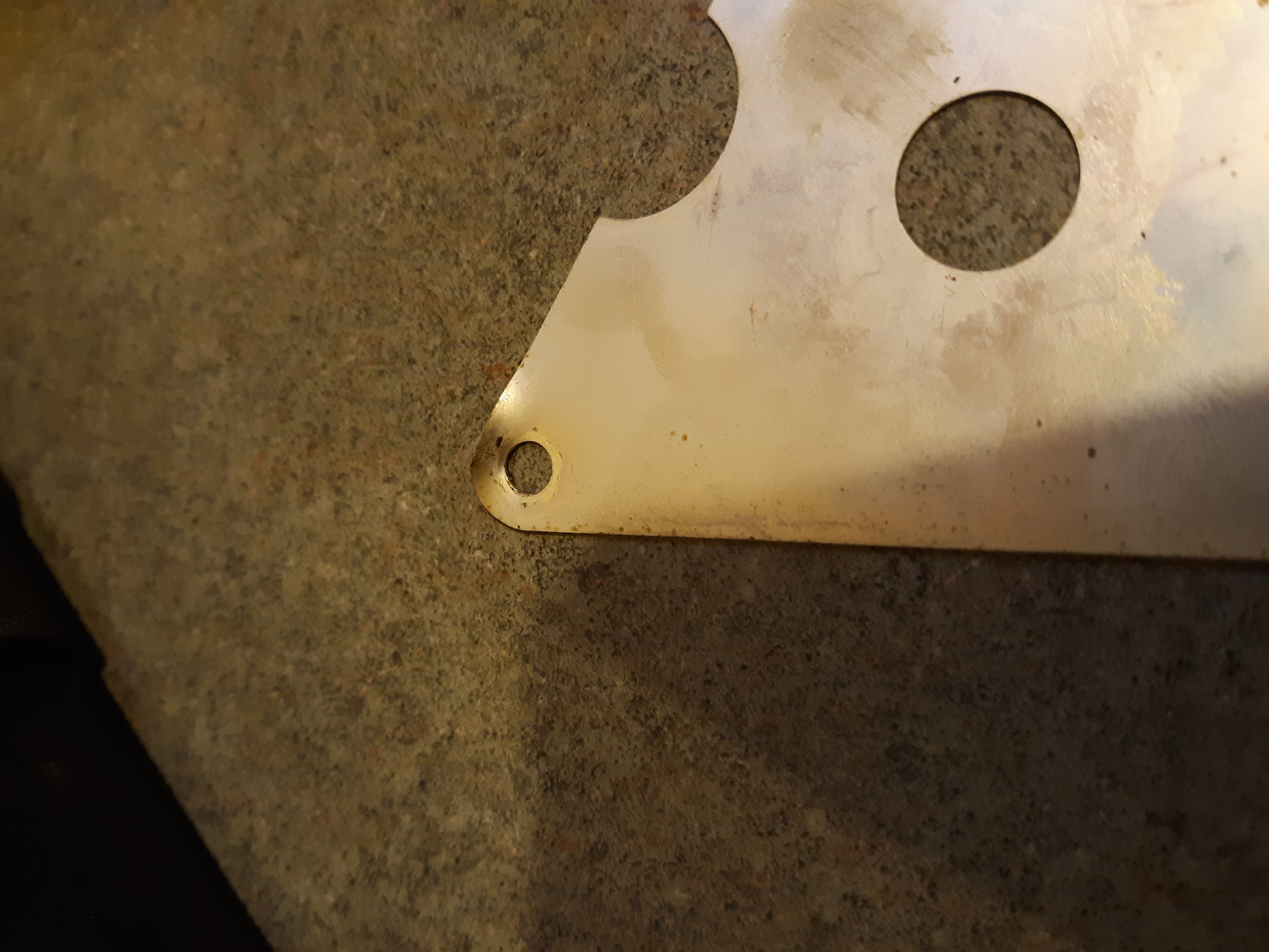

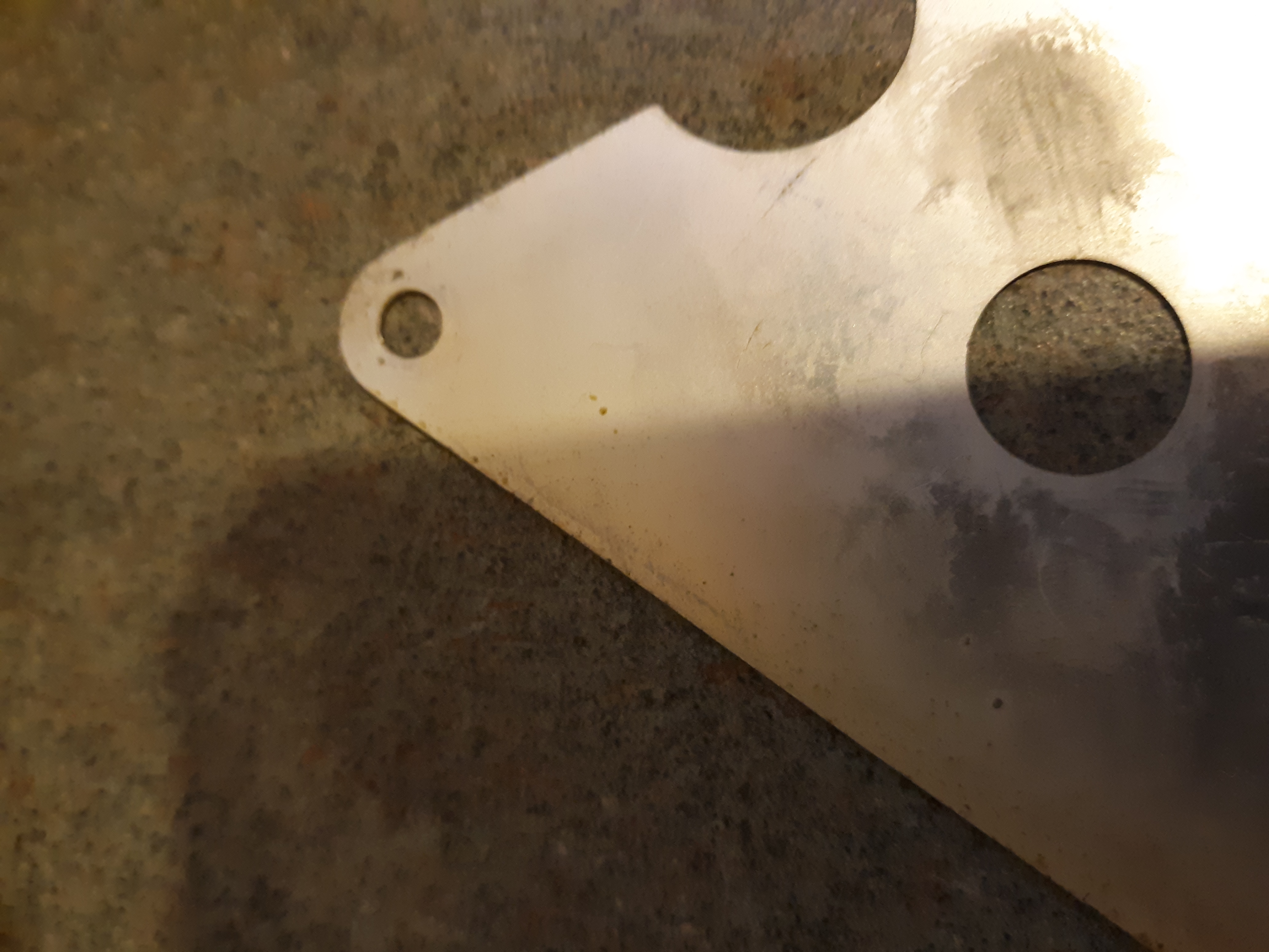

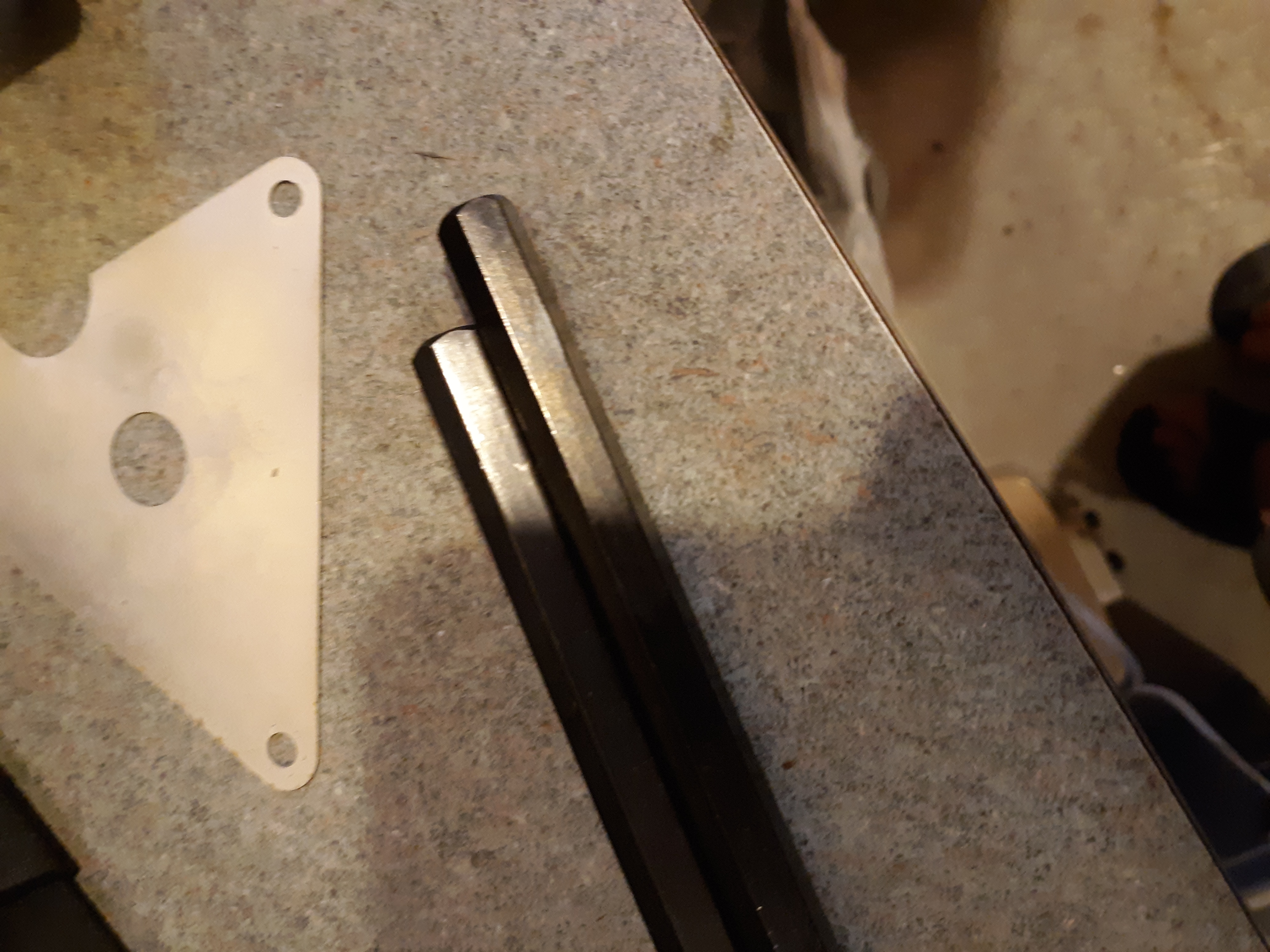

Then I straightened up the bent plate using two pieces of wood and a vise, and finished flattening between two large allen wrenches as anvils inside the vise. It is as straight as it has ever been.

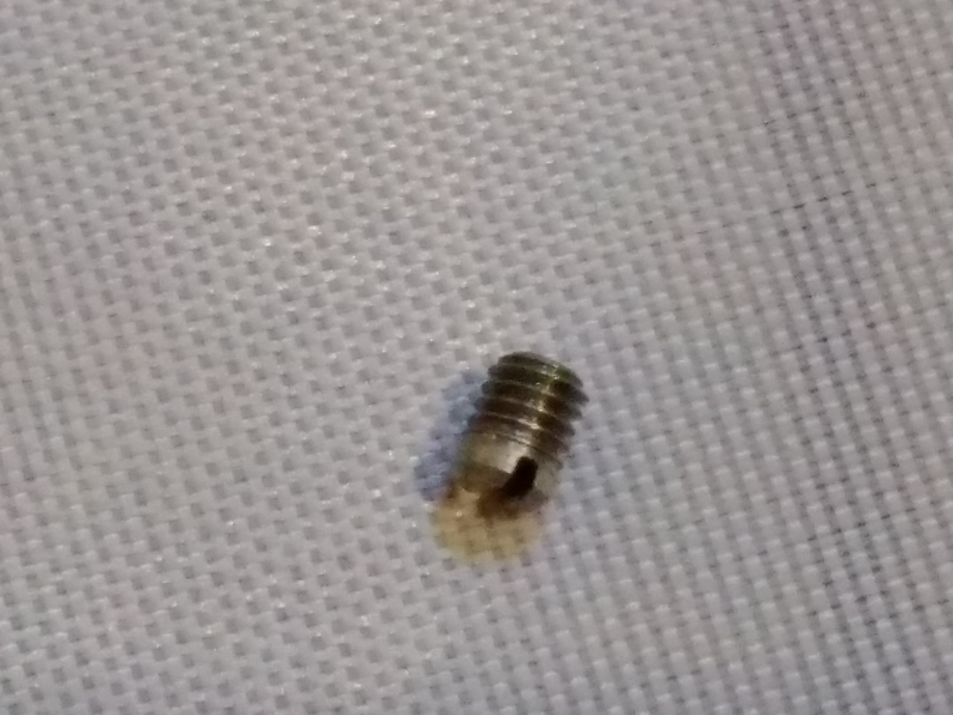

I have just found out why it is that one screw was loose and the other overtightened: the loose s rew is not in tact a set screw, or at least not an original type; it has a non-threaded head and the threaded part length is shorter than the hub's thickness, so it simply doesn't go through and grab onto the axis.
So they overtightened the remaining screw. Which is now a bit mangled, so I will have to get a new pair of M3 set screws.

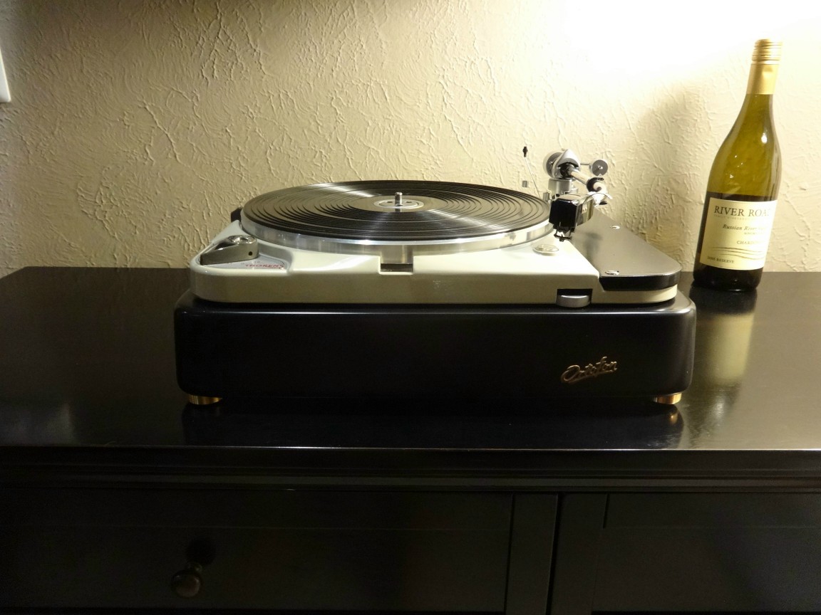

I've been using one I restored for a couple years now. I did a full rebuild and installed a new main bearing. Also completely disassembled every part including the motor. I have a Garrard 301 as well.
Here's a photo of my TD124 when first rebuilt. I now use an Ortofon RMG212 arm instead of the SME. I do use an early 12" SME arm on the Garrard.
