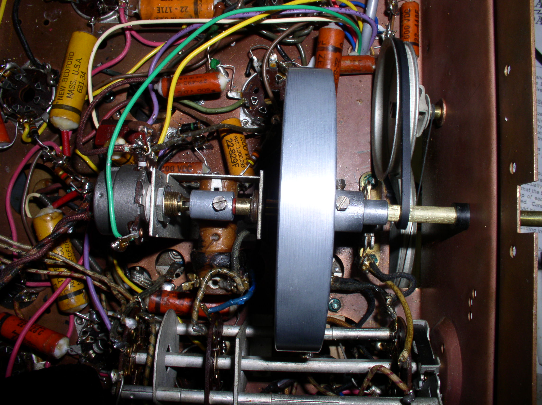

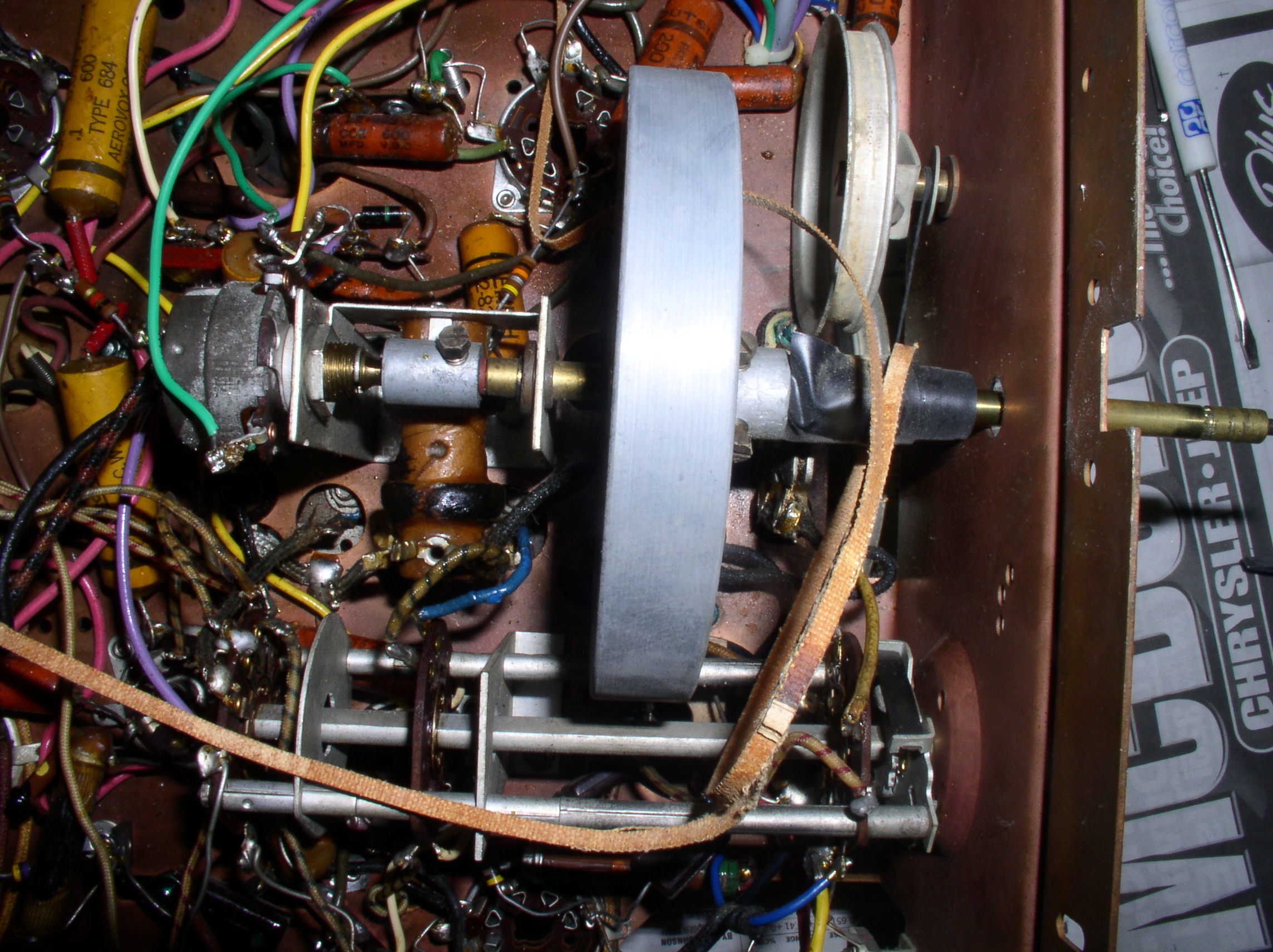

I have a 10S669 which uses the same chassis as the 10S690 and while someone added electrical tape to try to get more friction when the belt got brittle, the factory design used a flat leather belt that was driven by the knurled portion of the brass shaft.
I replaced the leather belt with a flat rubber belt that came as a kit which you cut to size and super glue together. It took a couple of tries to get the length optimized but it has been working for over 10 years without slipping.

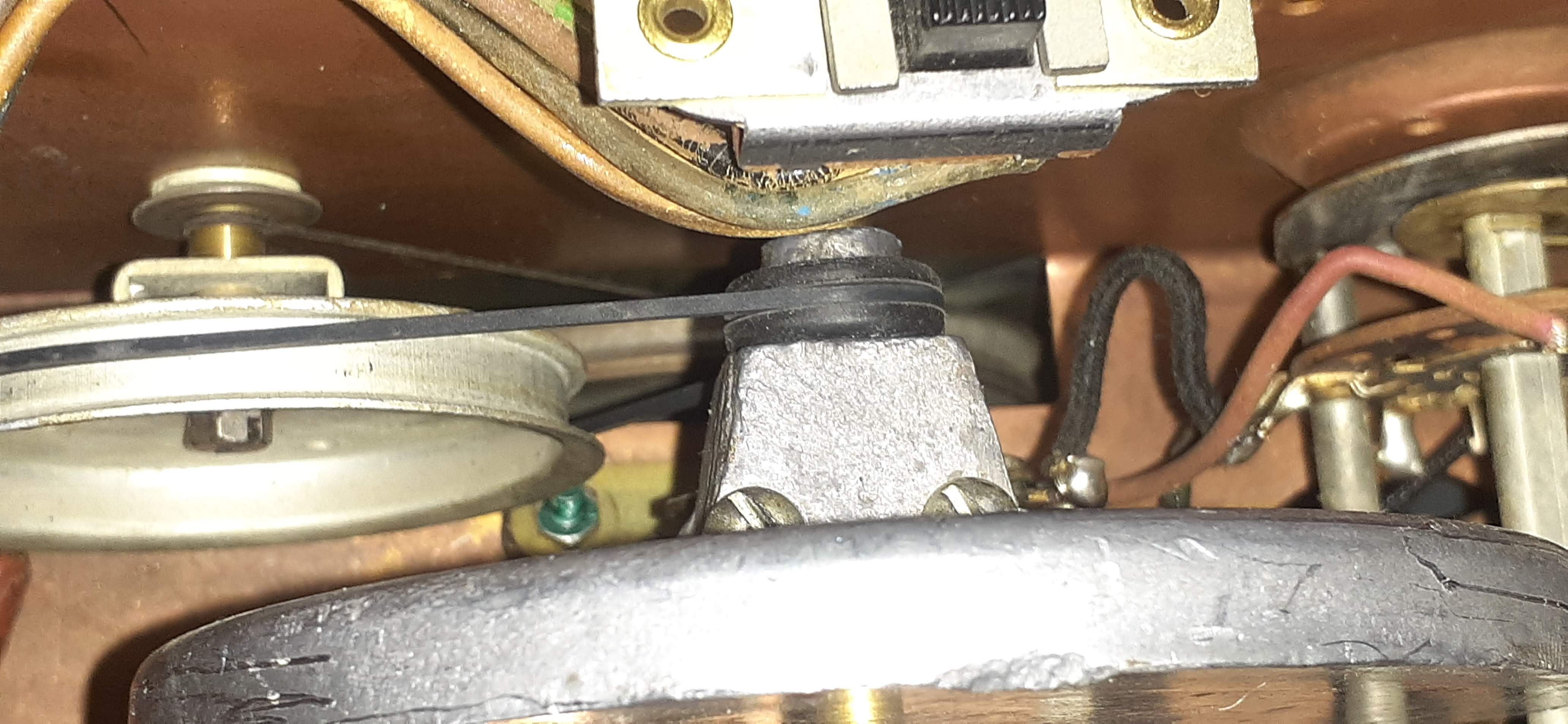

UPDATE: I finally fixed the tuner belt problem, I ended up using a rubber grommit with the correct inner diameter that was from a rubber grommit assortment kit I picked up at Harbor Freight and just stuck that onto the flywheel shaft where that knurled piece of rubber used to be and then just used an appropriately sized square belt that I had left over from an old VCR I junked out and the groove on the outside of the rubber grommit acted like a track for the belt to ride on and so now it works as it should!  Icon_biggrin  Icon_cool Icon_mrgreen
See picture below for a view of the repair.
Nice fit, plenty of traction there.
Yes, I agree, its more or less a miniature rubberized pulley, where you have your groove track for your belt to ride in just like you do on the bigger pulley that drives the tuning capacitor.  Icon_thumbup  Icon_biggrin
