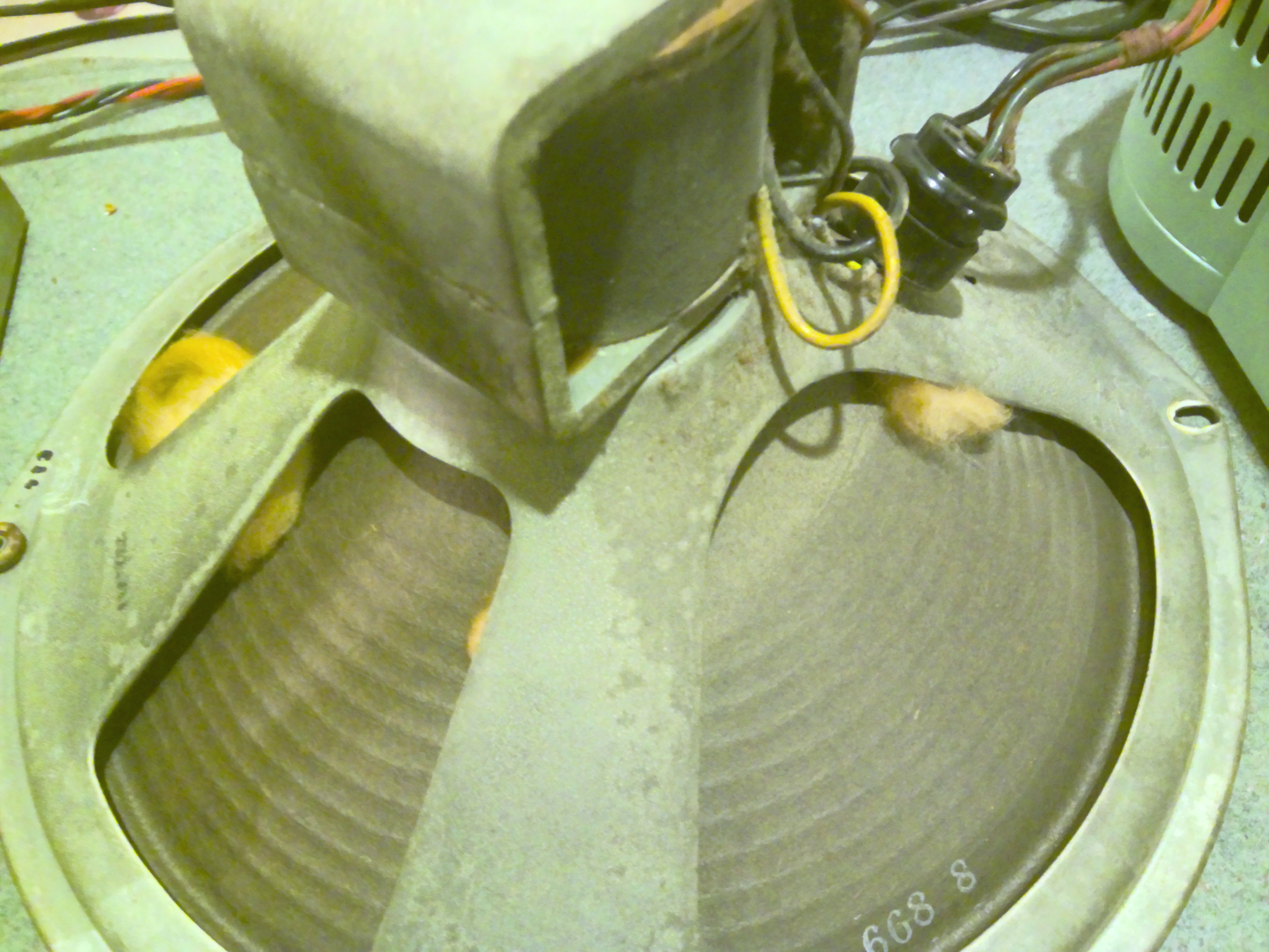

1. Here is the pic of the speaker.
What do those patches of thermal insulation doing there between the cone and the basket? Are those by design or did someone try to remedy something?

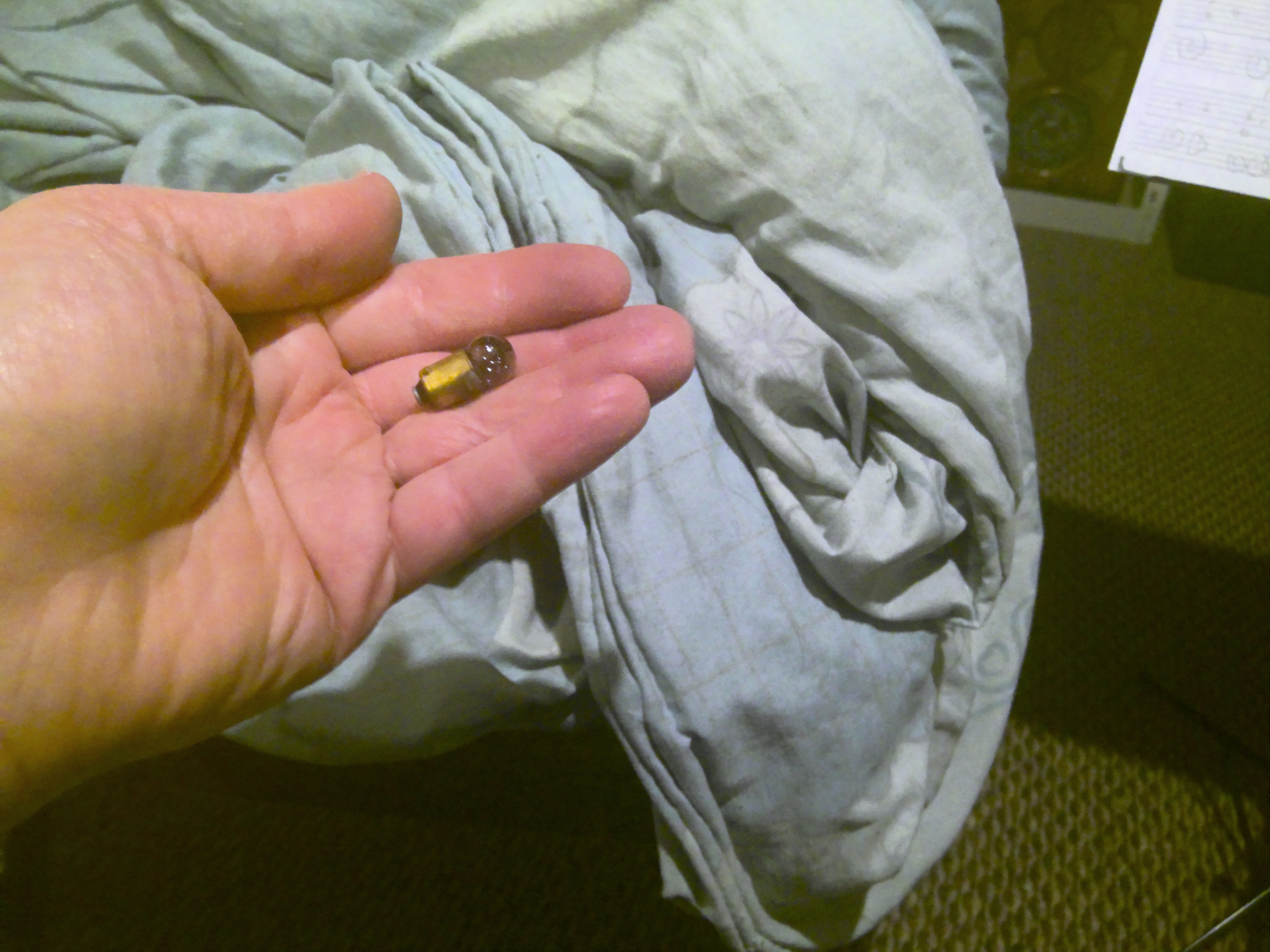

2. One pilot light bulb is burnt. It says GE 54 (if here is anything else I cannot tell). The other bulb is OK and it says GE 1445.
I put in type 47 (I think) - it has the same bayonet base, and it works fine; I am sure these supposed to be 6.3V. The 1445 is very dim. I suspect it is not 6.3V. It looks exactly as the burnt one.
Does anyone know what bulbs were there originally? Cannot find in the BOM.

I have been known to stuff a bit of cloth between the cone and basket of a speaker whose voice coil was rubbing (warped cone). A temporary measure until a replacement could be obtained.
I use that bulb in Allen Organs. 12-14 volt.

Yes, it is 14.4V bulb. I wonder if this what is supposed to be here. It obviously is pretty dim, working at 1/4 intended power.
I have not heard any rubbing so far but then I have not been trying to see if it rubs. The music seems to be fine.
If I find out it does, I guess I could either send it to be re-coned, or leave it be.

Hey, it has the same base, right? Must be the correct lamp!
Posts: 16,577
Threads: 574
Same base. But 47 also has the same base and fits well, and shines as it should as it is 6.3V. The glass is elongated instead of round but if it fits that's fine.
My question is, was there a 14.4V lamp in the first place, so to make it dimmer and cooler, or was there 6.3V lamp?

"Same base. But 47 also has the same base and fits well, and shines as it should as it is 6.3V."
Yes mike. I was being facetious. So many people thing that if it looks right, it must be right. Wrong!!!

Obviously it is a 6.3 volt filament circuit which the dial lamps are connected to.
Here is the bulb I am using these days:
https://www.pinballlife.com/ablaze-premi...-dome.html
LED lamps with miniature bayonet bases, in your choice of colors. Most will prefer Warm White which produces the same color temperature of an incandescent bulb. I prefer Cool White...just because.
The Pinball Life LEDs will illuminate your dial much better than those old incandescents ever did. As an extra bonus, they use less current and will probably last as long as you do.
