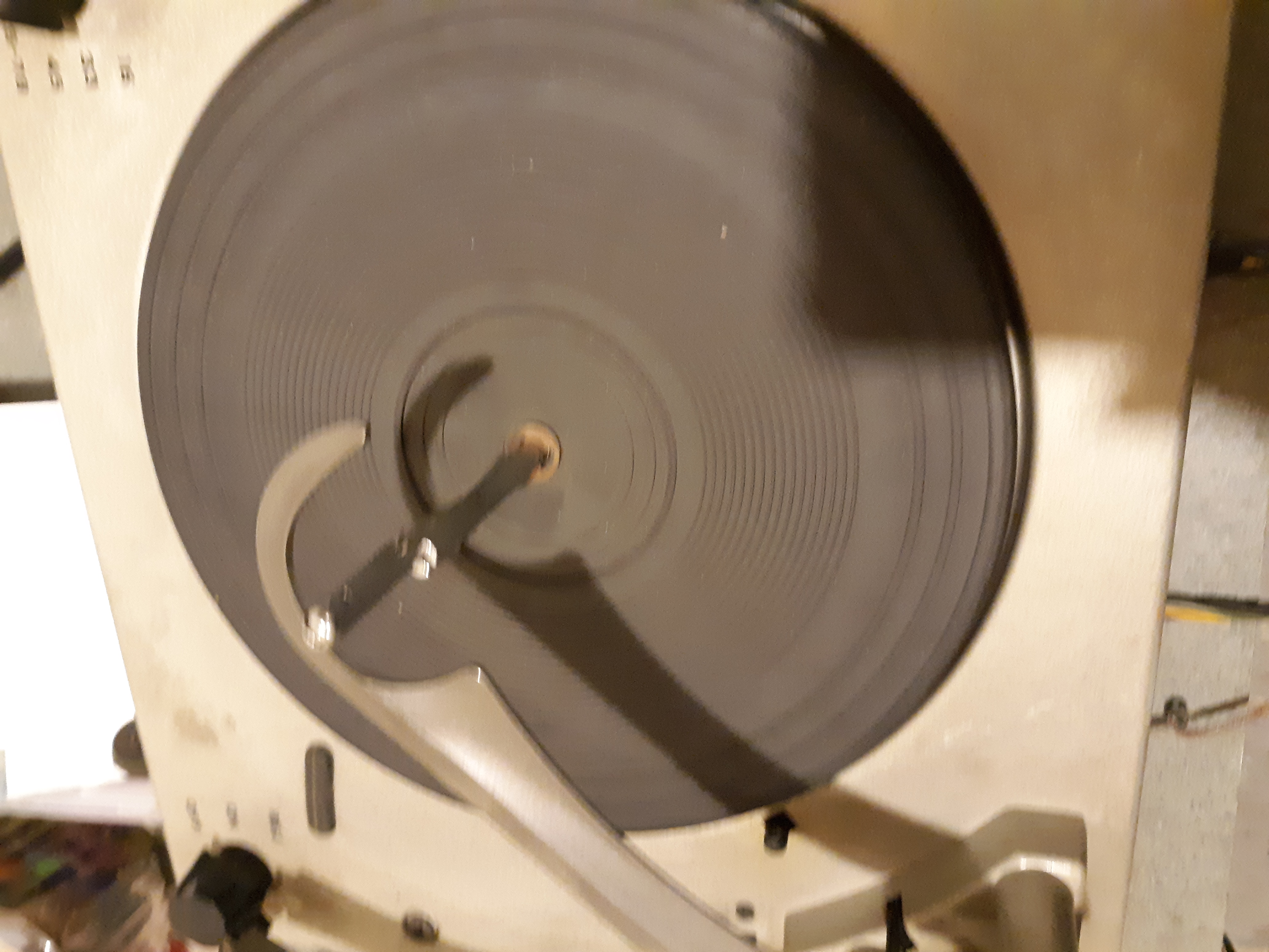

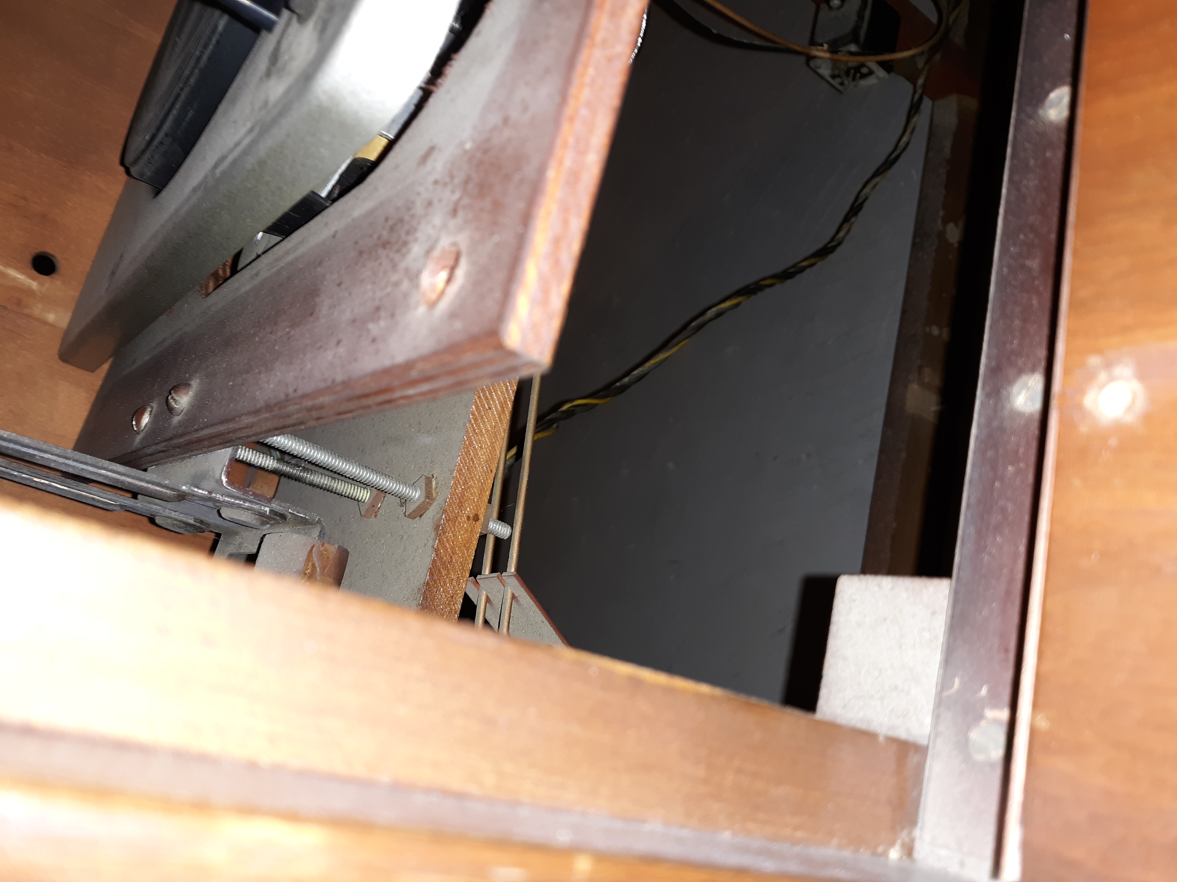

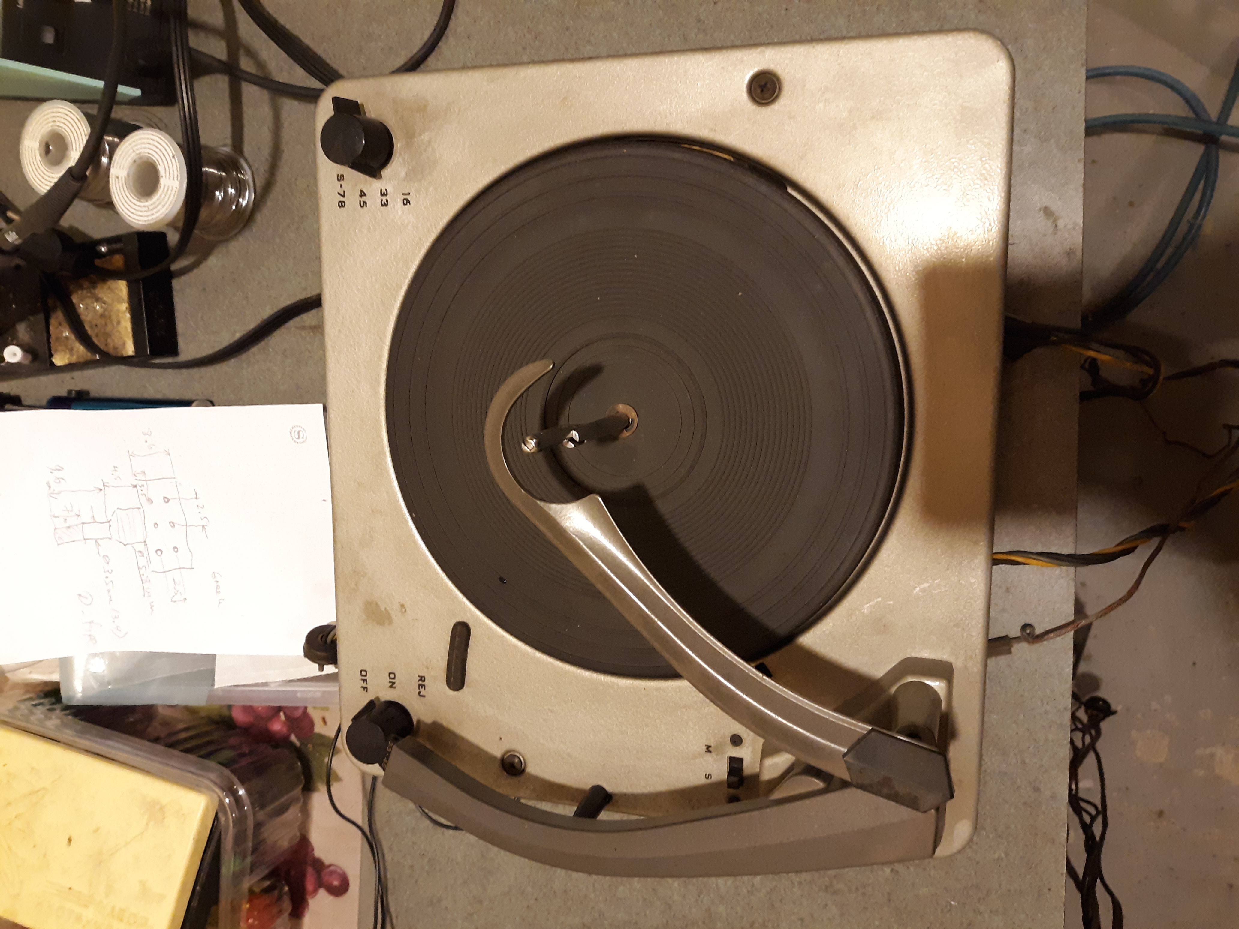

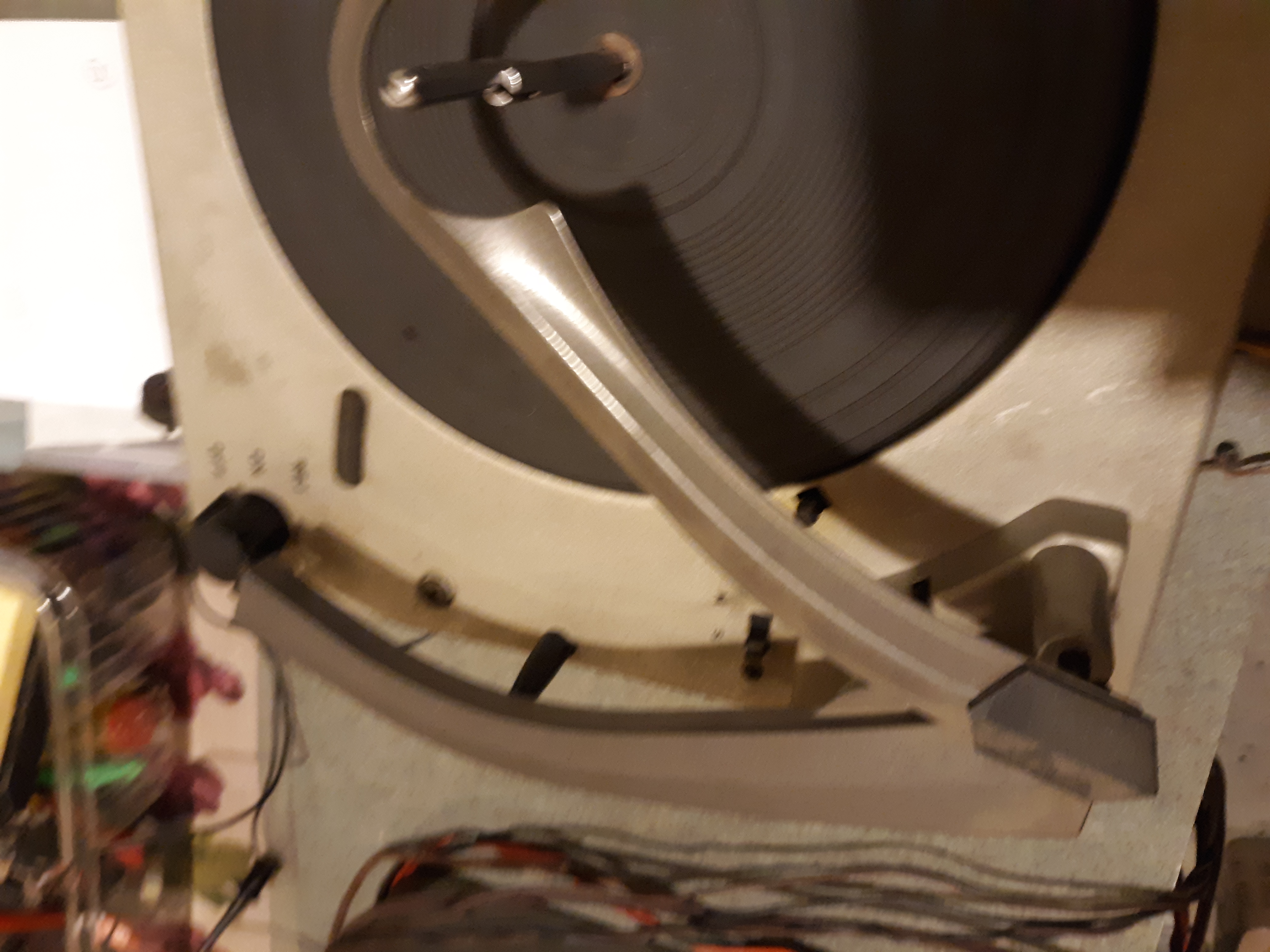

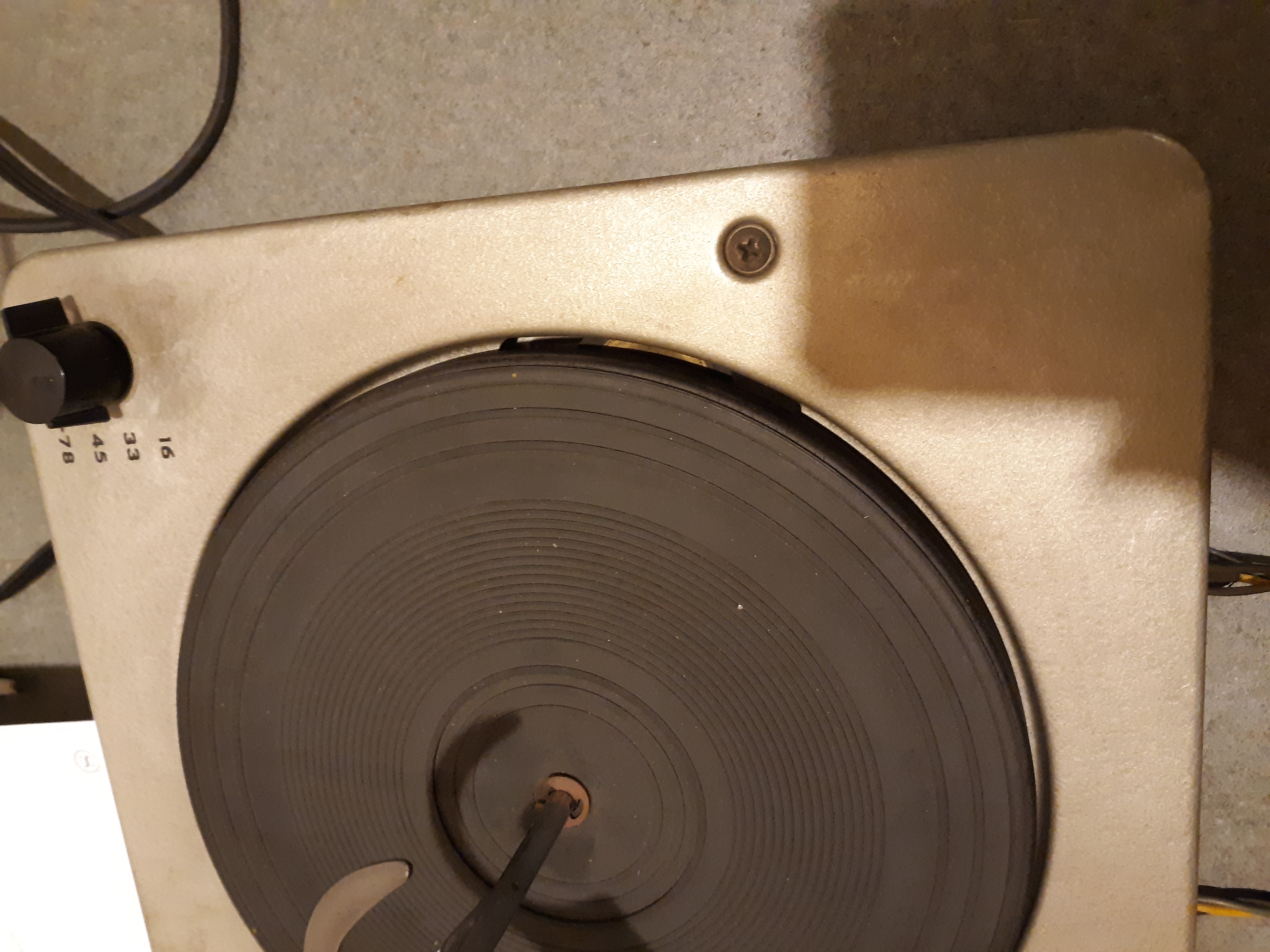

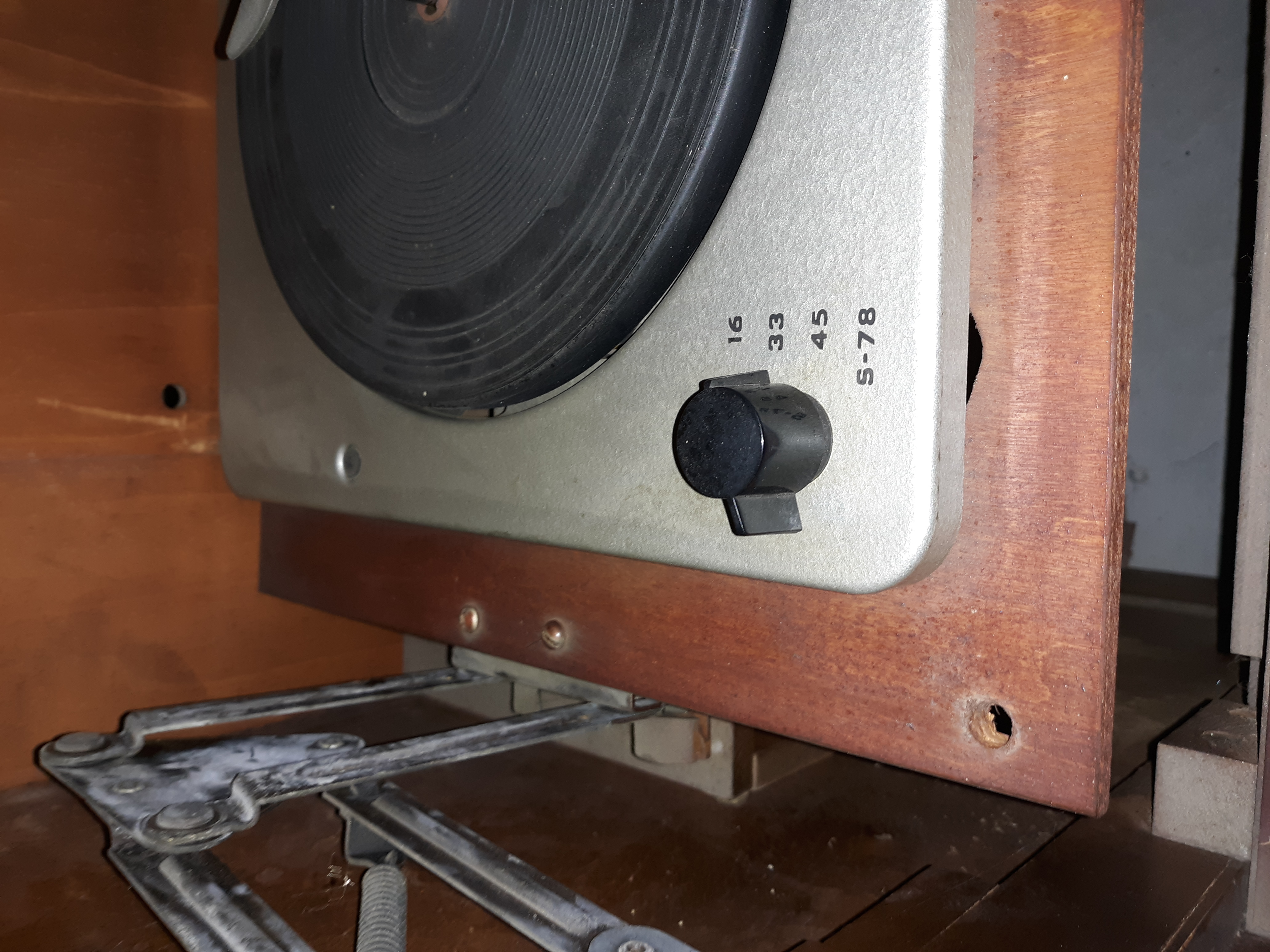

I am trying to understand the turntable.
Here are the pictures:
Questions
What are these long screws going through? I think they do not let the tray to slide out.
Should the tray slide out? Without the screws the tray will be separated from the metal tray.
But if it is not supposed to slide out, what are the joints that seem to be there to allow to pull it out?
#42
Could they be leveling screws?
#43
Could be. But they go through that wooden shelf and I think it is attached to the cabinet.

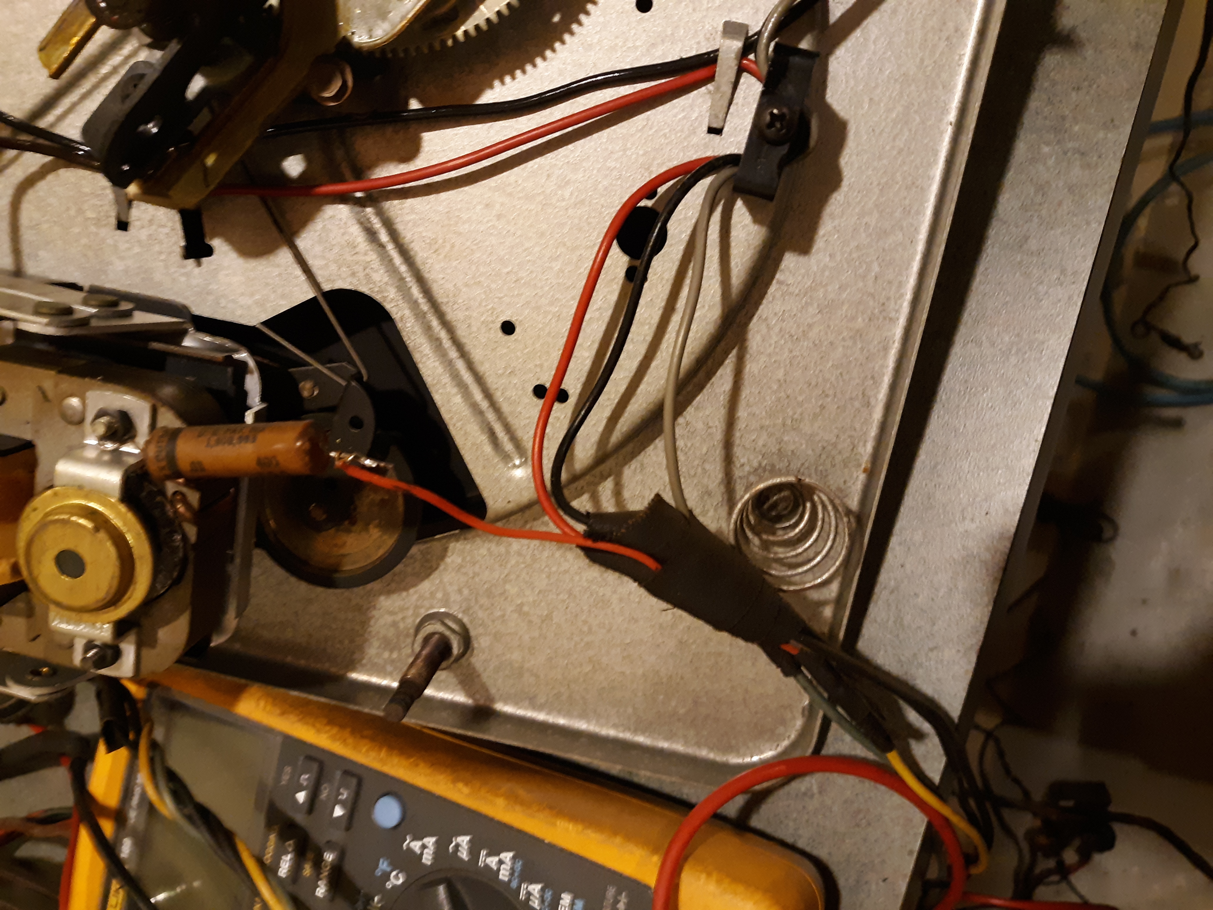

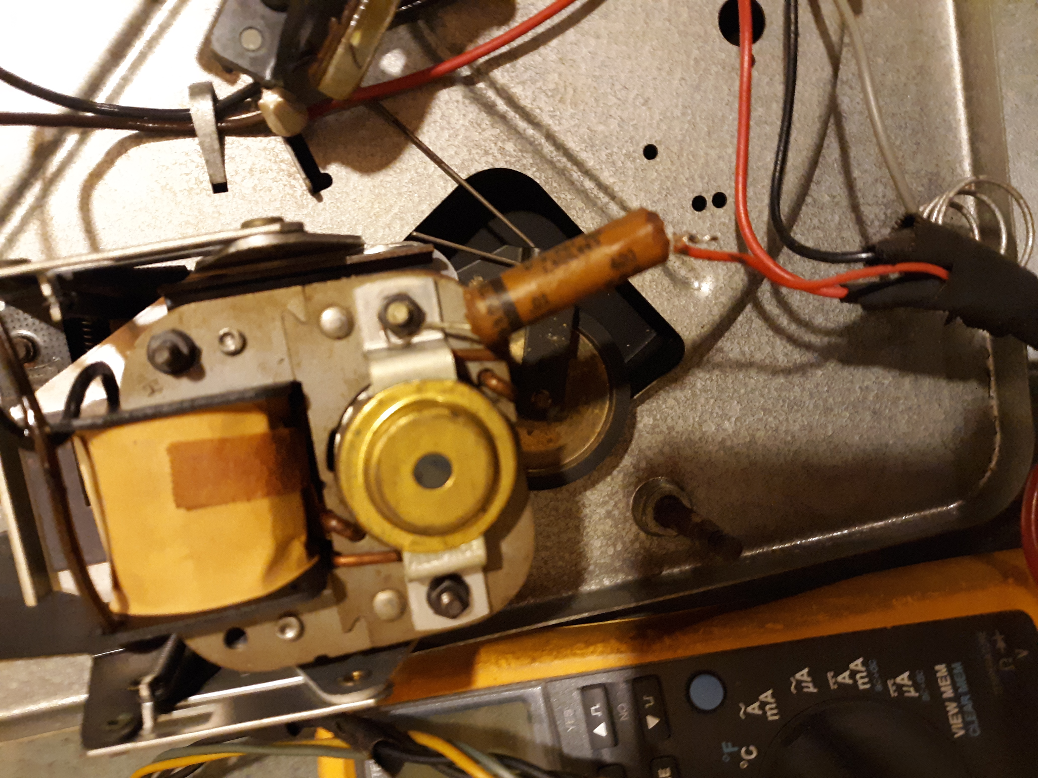

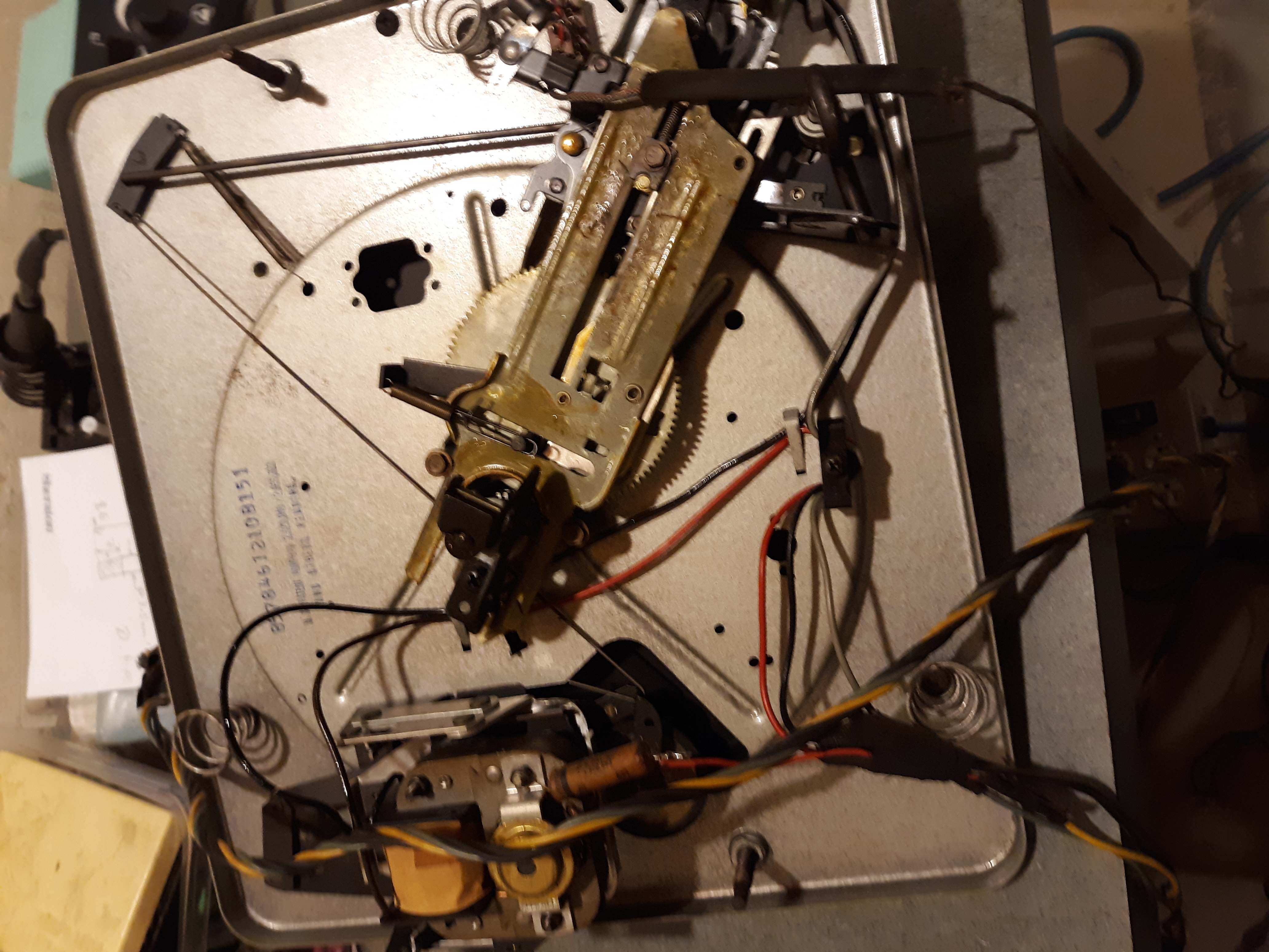

This changer is in the radio. I am not sure it is the original one. You could see how it is twist-wired to the cable.
Also the capacitor of 0.01uF is wired between the Chassis wire and the motor's screw instead of going there direct;y. The cap is Sprague and
not a Philco.
Does anyone know this changer and if this is the one that was used in this radio originally?
