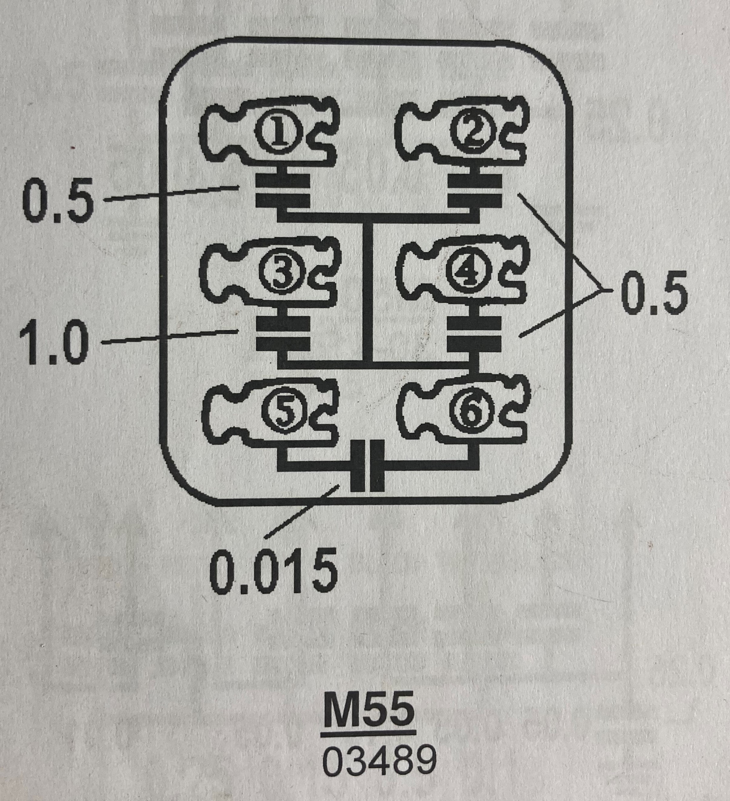

ok I am working on my model 112-A with two 47's and i have a question it may seem dumb, but the condenser can part number 3489 from what i have read terminal 6 is grounded to the chassis and not to the can itself. what difference would it make if I chose not to rebuild the can and relocate the capacitors it looks to me that all the caps are grounded anyway as it looks in the drawing. it looks to me the better way is to rebuild the can this is just a question

Don't know if this will help answer your cap block question but its an annotated schematic that Ron Ramirez prepared and is found in our library: See Model 112 (late) https://philcoradio.com/library/index.ph...chematics/

yes, thank you now dose anyone what terminal the 0.01 and the 0.15 caps go on the tone control
