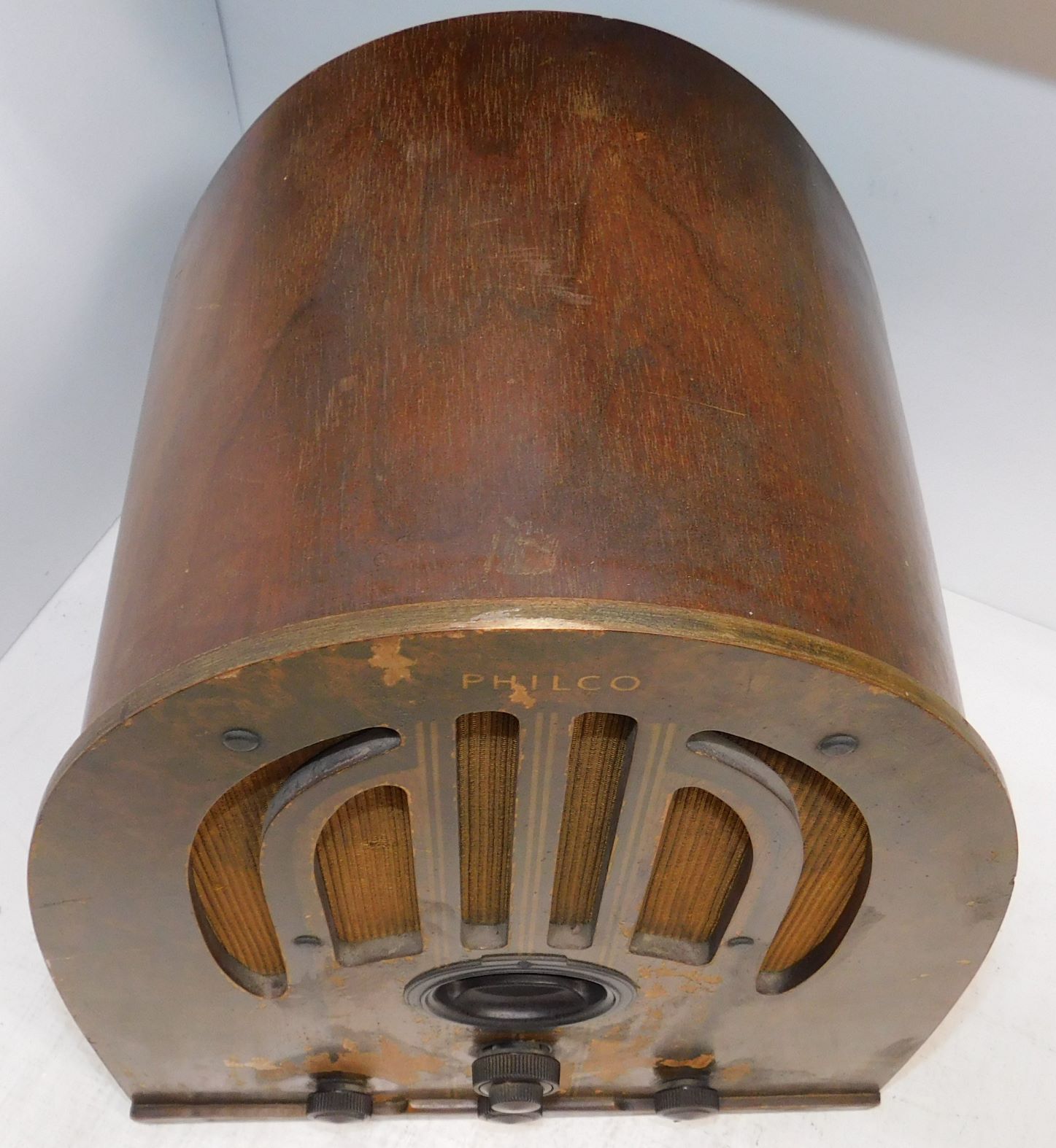

On the Bakelite block caps as time progressed Philco used less and less of them. Early sets may have ten or more. I'm working on a model 90 from '31, it has 8 in it. By the late '30s Philco was just using them for the ac line bypass which is the case in your set. Mostly your set has tubular caps which probably don't have the value marked but a part number. You'll have to check it against the schematic and parts list.

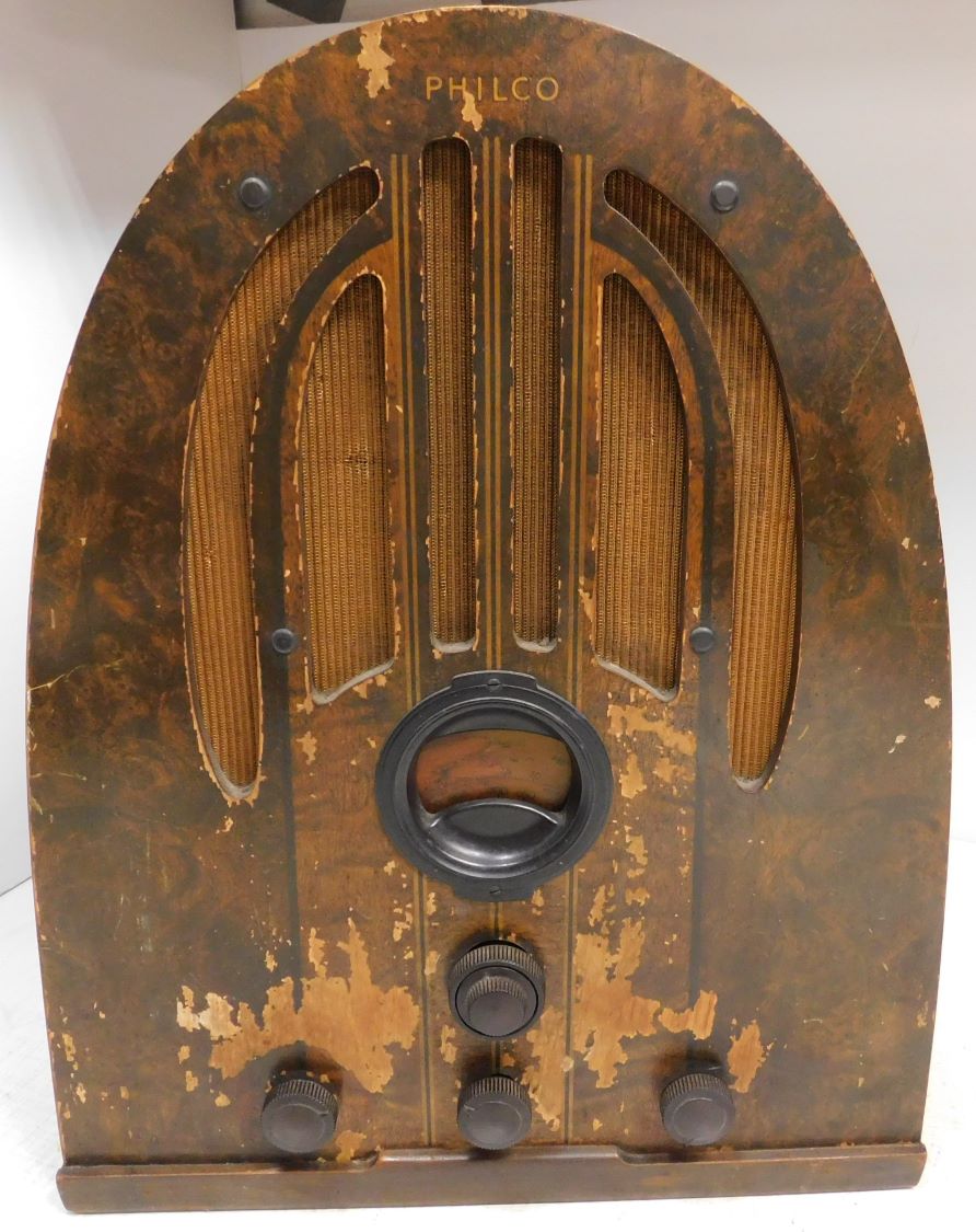

Looks like someone tried to clean the dial... You'll be needing a dial https://www.radiodaze.com/philco-37-61-27-5205/ Another quick check you can do is measure the resistance between pins 2 and 3 on the 42 tube. Should see a several hundred ohms, if not the opt is suspect. Or if you have a 6F6 instead of the 42 it would be pins 3 and 4.
If you are good w/color there's hope for the front panel. The good new is that the black/gold lines are pretty much in tacked. The other black lines and browns take a good eye to recreate but it could be made to look a whole lot better than what it is now.

Terry, thank you for the comeback. my wife is an artist and she feels she may be able to make it look pretty good (at least better than it is.) One thing I did notice is someone put a 5y3 rectifier in the radio and it should be a 5y4, the plate pins for 5y4 are 3 and 5, the 5y3 are 4 and 6, the 5y3 has no pins 3 and 5. So maybe someone changed the wiring, I will have to check that. You mentioned tube 42, but the 37-61 has all 8 pin octal tubes.

Welcome to the Phorum, Chip! I've seen much worse cabinets turn into showpieces. In looking at the photos I would seriously consider making a new wiring harness for the speaker. I cringe any time I see frayed wires and electrical tape! Take care and BE HEALTHY! Gary
