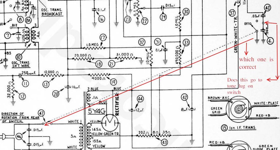

In the attached schematic, the ac switch wiring is a little confusing , I do not think one side of switch puts one side of ac cord to ground. Also am I correct by putting the tone lug on the switch in between the two caps 40 and 41?

Two unrelated things. The dashed line indicates that the two controls are mechanically linked. When you turn on the power switch you are also moving the tone switch from off to bass. Move the switch once again you short out cap 41, giving less bass. Since you brought up the power switch, it's usually better to have the line filter on the other side of the switch and connect the hot side of the line cord to the switch. This way the power is truly off until the switch is activated on. Sometimes doing the rewire is not practical, then you must make a decision about whether or not you want power on the line filter whenever the set is plugged in. I have a couple chassis in my workroom with black corners from the sad result of exploded line caps.

I had been boggle minded about that switch for days now, but after reading what you just posted got me thinking, so I investigated what you said a bit with a meter, and by golly you are indeed right, by switching the switch 2 times, it shorts the .03 to ground, by switching once it turns on the radio and uses the .03 cap filter for bass. Its been years back to my day of wiring complex switches. Reminds me of the 3 way light switch, if you don't know how it seems impossible but once you know how, its actually very simple.

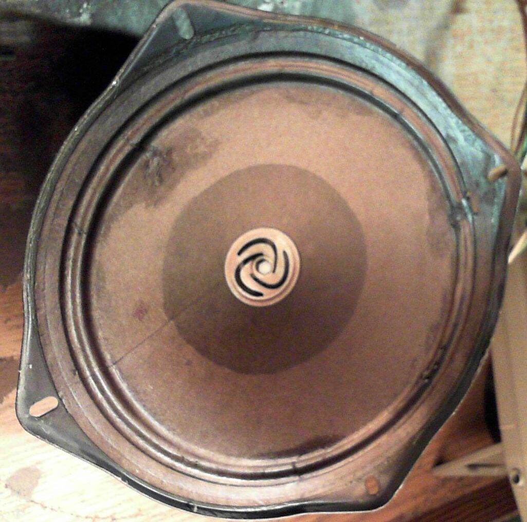

I managed to get the power supply and the Amp wiring done, I replaced all the resistors in that section as well as all the caps. I double checked all the wiring and hooked the org speaker up and decided to do a quick smoke test, I was amazed when I herd radio signals come in on both shortwave band as well as the AM band. With just a short 1 foot antenna I picked up stations loud and clear and the bass filter worked like a dream.  The voltages seemed all normal and there was no hum from the power line. The speaker has 2 very small hole in it and I will repair them (I read from the library about speaker repair. I have a gallon of Thompson Water seal, so I may use that to renew the very fragile cone.  I am so happy that the field coil is OK.

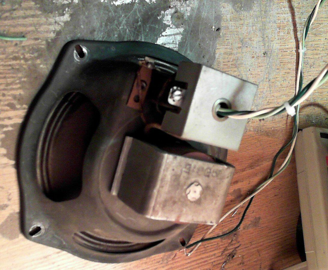

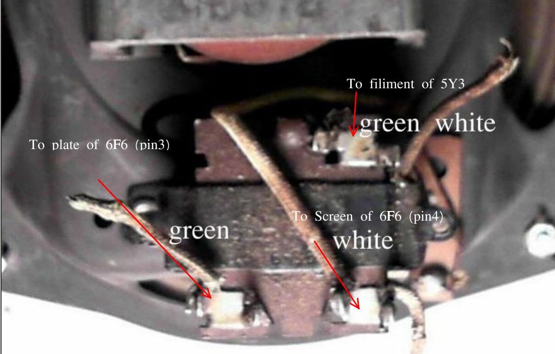

I have been working on the speaker from my 37-61. There were a few very small cuts and I repaired using Elmer's white glue, and also coated around the rim with the glue. Seemed to work well. I replaced the 3 wires with new. The field coil is good and so is the rest of the speaker. I put it to the test with the radio and worked like a dream. Se attached photos.
