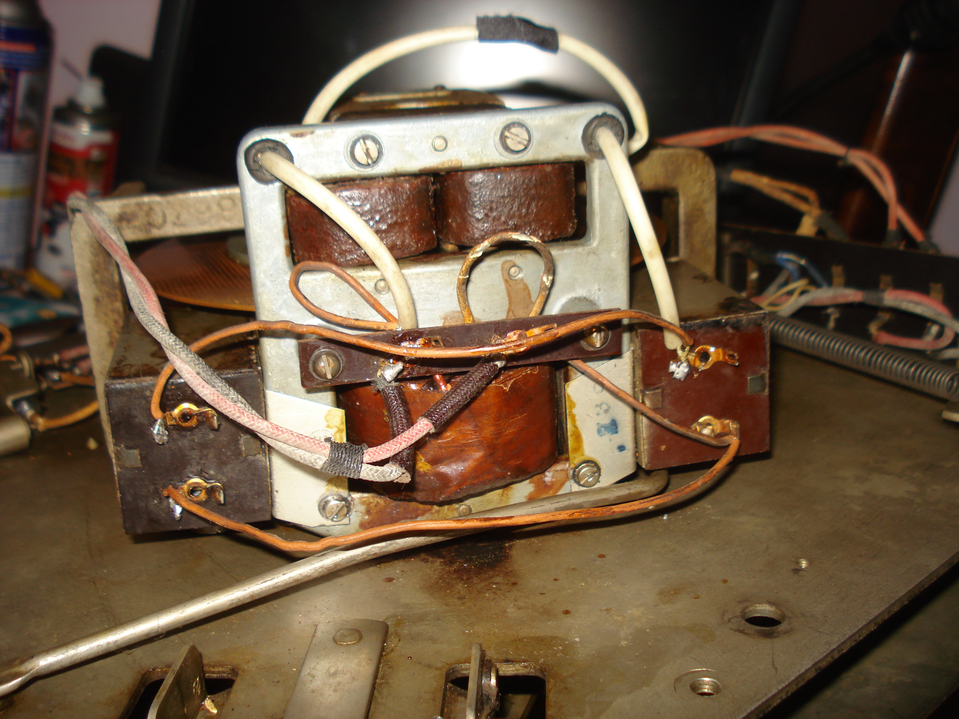

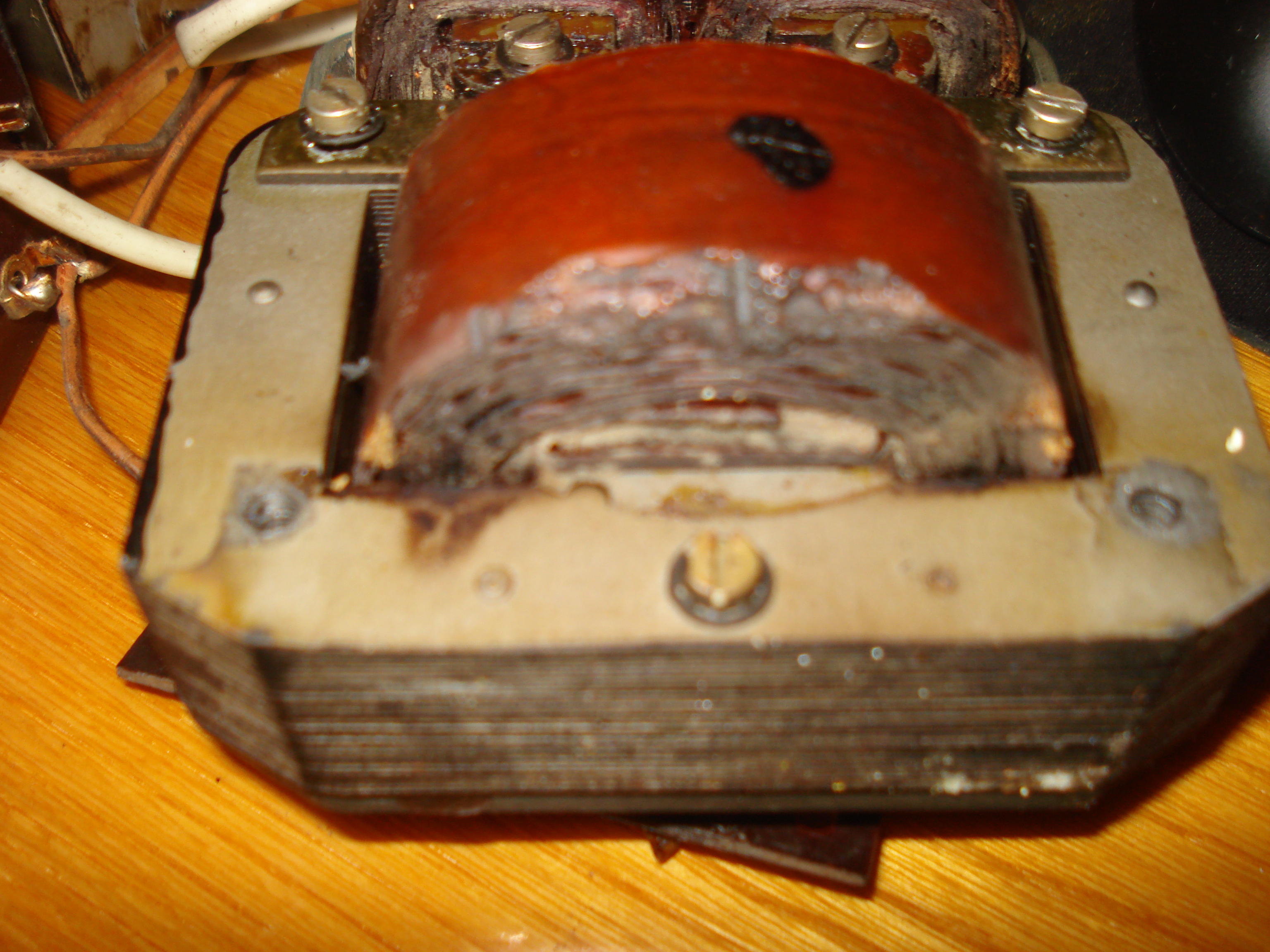

Despite the constant security problems due to the war and the constant shelling of the entire territory of Ukraine with Russian missiles, I cannot deny myself the small joy of distracting myself from anxious thoughts and sometimes doing my collection. Some explanations for the previous video.
I miraculously managed to buy this amazing radio console, which I showed in the previous video, right before the war - in January 2022. And I bought it in a city near Kyiv, in which terrible battles were fought a month later - it is possible that this sale and relocation saved this radio from destruction. The radio is now up and running, but the automatic record player is not working due to the engine not working. You will have to look for and buy a new one or try to rewind one of the three windings, in which I think there are shorted turns because this winding heats up.

Yeah, it'd be cool to rewind that motor and see the record player work.
Is there a way to fit another motor in there? (like the old Soviet ДАП-хх, not sute whether it was ДАП-4 or some other number).

Replacing the engine with a Soviet one or another one will be a big problem, because the engine used here is a very rare type - a hysteresis engine. They have a very quiet and stable course, but I have never dealt with them, so I have no experience. Replacing the paper capacitors with new ones did not give a positive result, but I was surprised by the very low resistance of the working motor winding - only 20 ohms. The appearance also did not add optimism - it seems that the winding got very hot and has inter-turn closure.

Does this phonograph use a platter that is directly driven by the motor? I have an old Canadian Victor 78 rpm player that is an accessory for a radio, and the platter is connected directly to the armature, you can even reverse the rotation of it if you wanted to play records backwards.

No, Arran. This is an asynchronous hysteresis motor, it cannot change its direction of movement and it does not need a starting impulse to start movement. Unfortunately, I have not yet found all the capacitors in order to replace them with the old capacitors. There are a lot of mysteries and I think that there used to be manipulations with capacitor capacities, as well as with engine power supply voltages. I am already almost convinced that there are short-circuited turns in the main winding due to the wrong connection by the previous repairman to the 220 volt network
