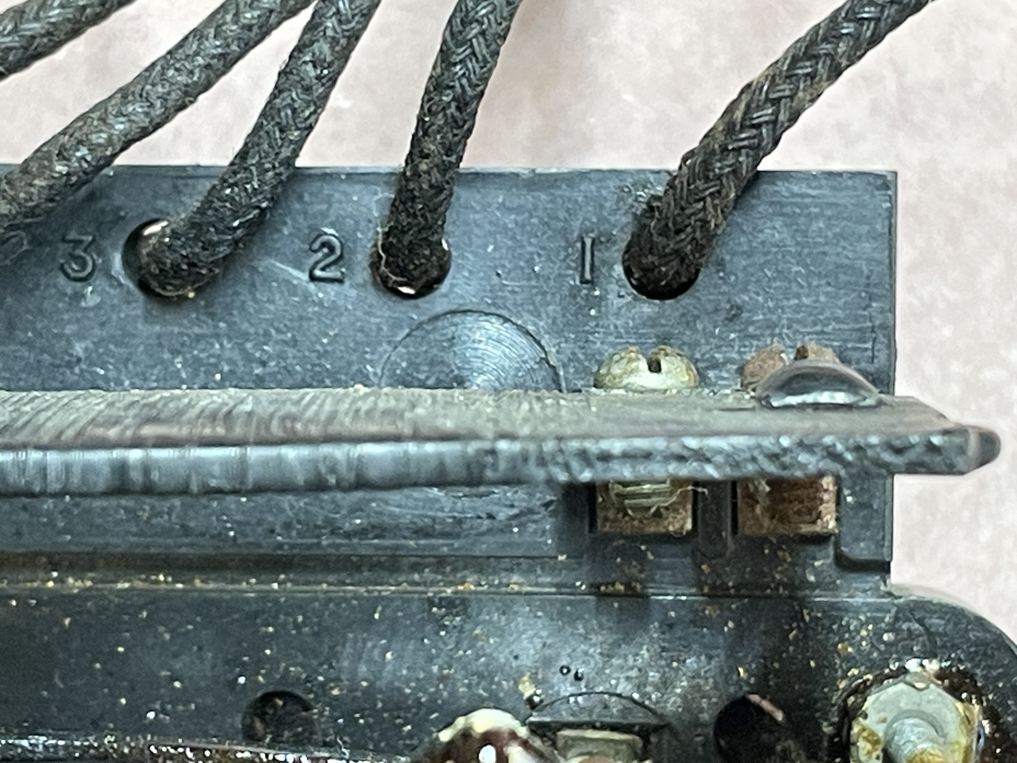

Note that two caps pass over the internal steel support beam, it they are too close they can short to the beam which is at B-. Should have had a cambric covering, may have shorted when re-filled...

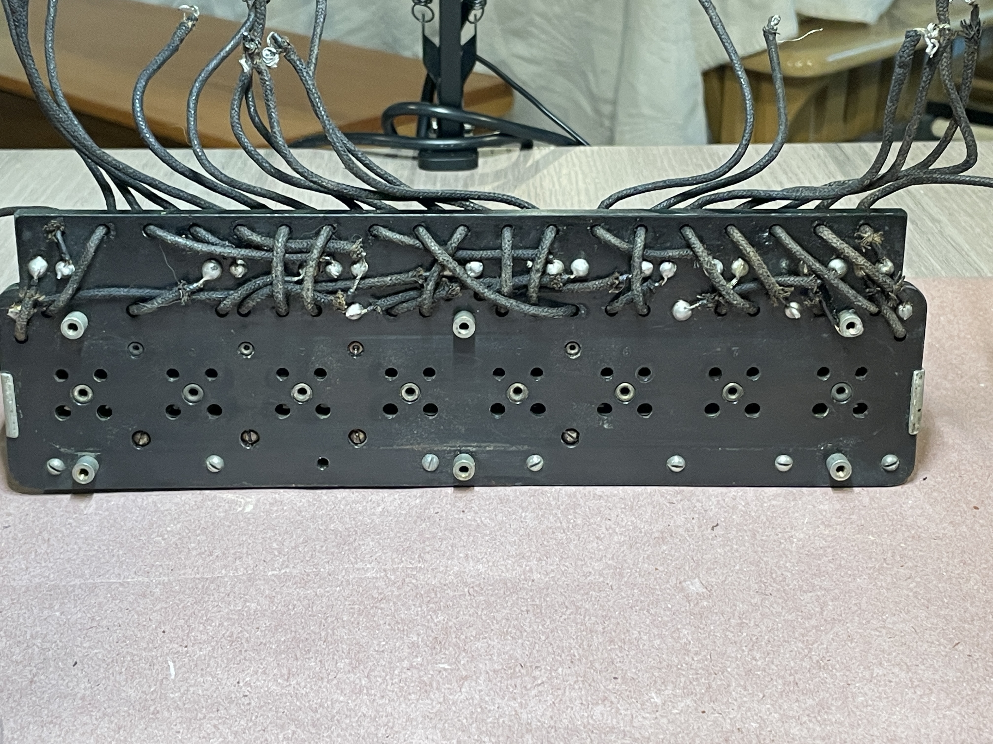

BTW the 'short" could be in the criss/cross of whisker wires under the cover. See the photo...
I have seen these wires pop off their soldered connections to the brass #4 screws.

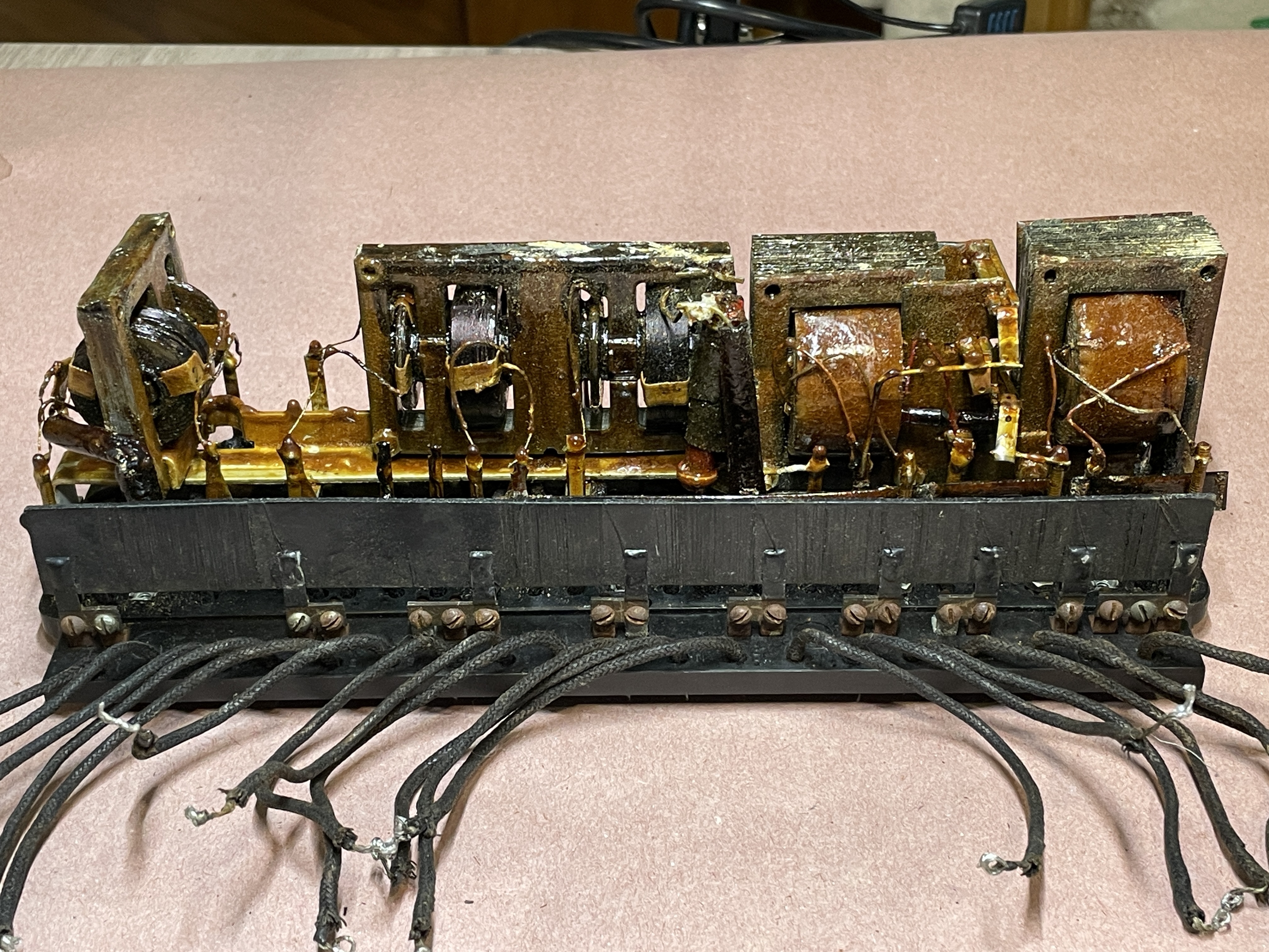

Actually, look at pix that has cat showing audio transformers on the right. The only way I could identify components other than memory is to refer to the RCA notes or to Gernsback for the Radiola 30 as Gernsback did not do a simplified drawing of the 28 (same as 30) with last audio blocked. You have access to both via World Radio History.
Someone may have done a re-draw of the 28 in modern times, however, I would not be comfortable with any of their work.

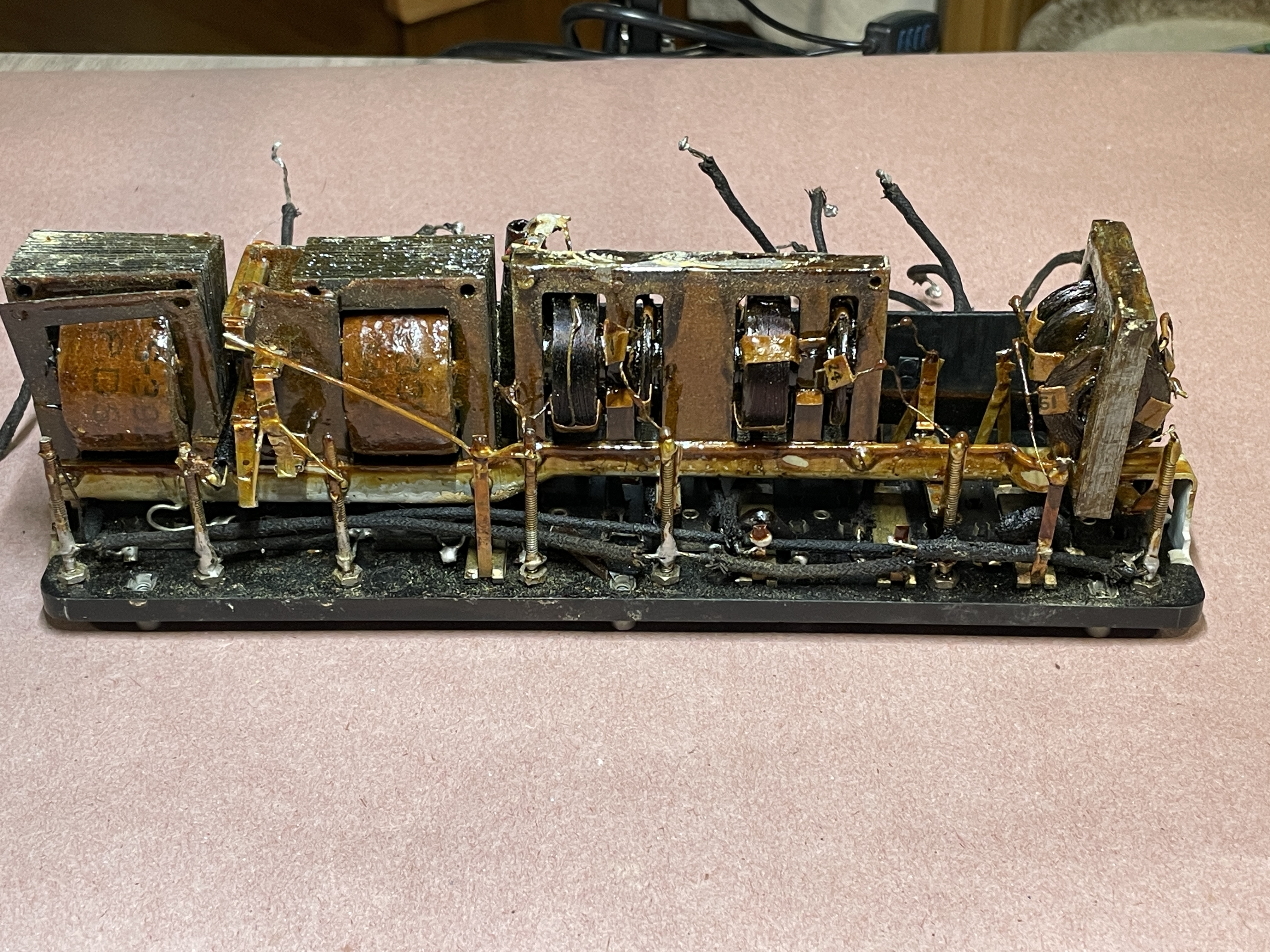

Left to right are the RF input and mixer coils on their core with associated caps. Next are the IF group with a couple of caps on their core, next in a narrow space vertical are the grid leak and the grid cap both in cambric sleeves and electricians friction tape. I did not check the leak but if it is at or about 8.2 meg it is fine. Then the AF transformers 1st audio on the left and last audio on the far right. In between the sides is a pair of fiber board slotted panels holding an array of 4 bypass caps. All the rest is criss/crosses of jumper wires. Soldered to the #4 screws. Note that some of the fine coil wires are soldered to a larger cambric covered bare bus that is soldered to a #4 screw.
Pay strict attention to the wires connecting the external oscillator coils, if they get mixed it will be a number of tries before it works right.

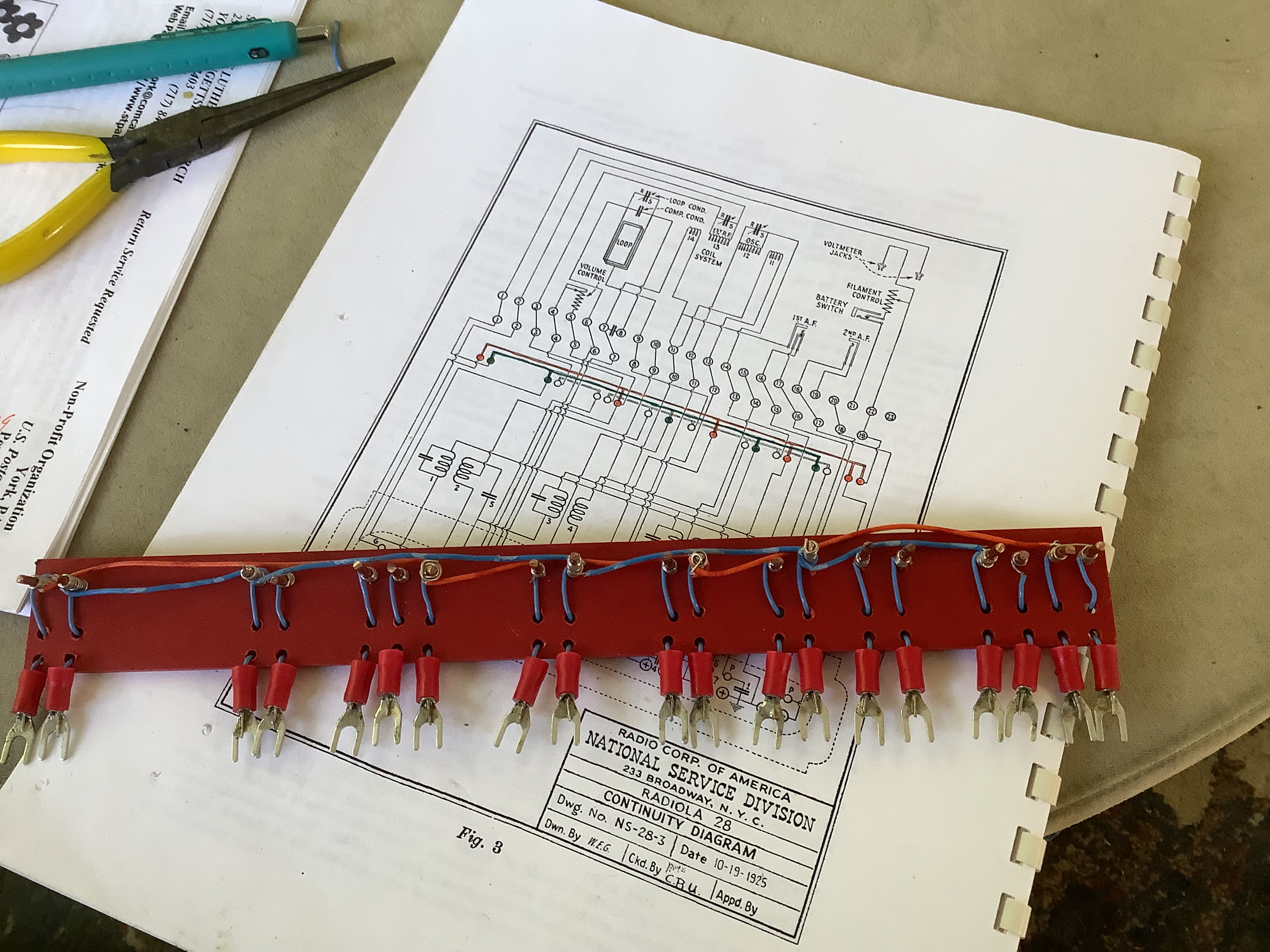

This is my attempt to replace the wire resistor strip. It’s not finished yet but the main idea is there. If this works I plan to move on to replacing the open transformer.
Nice, I had considered forked lugs. What would plague me is the potential for shorts...

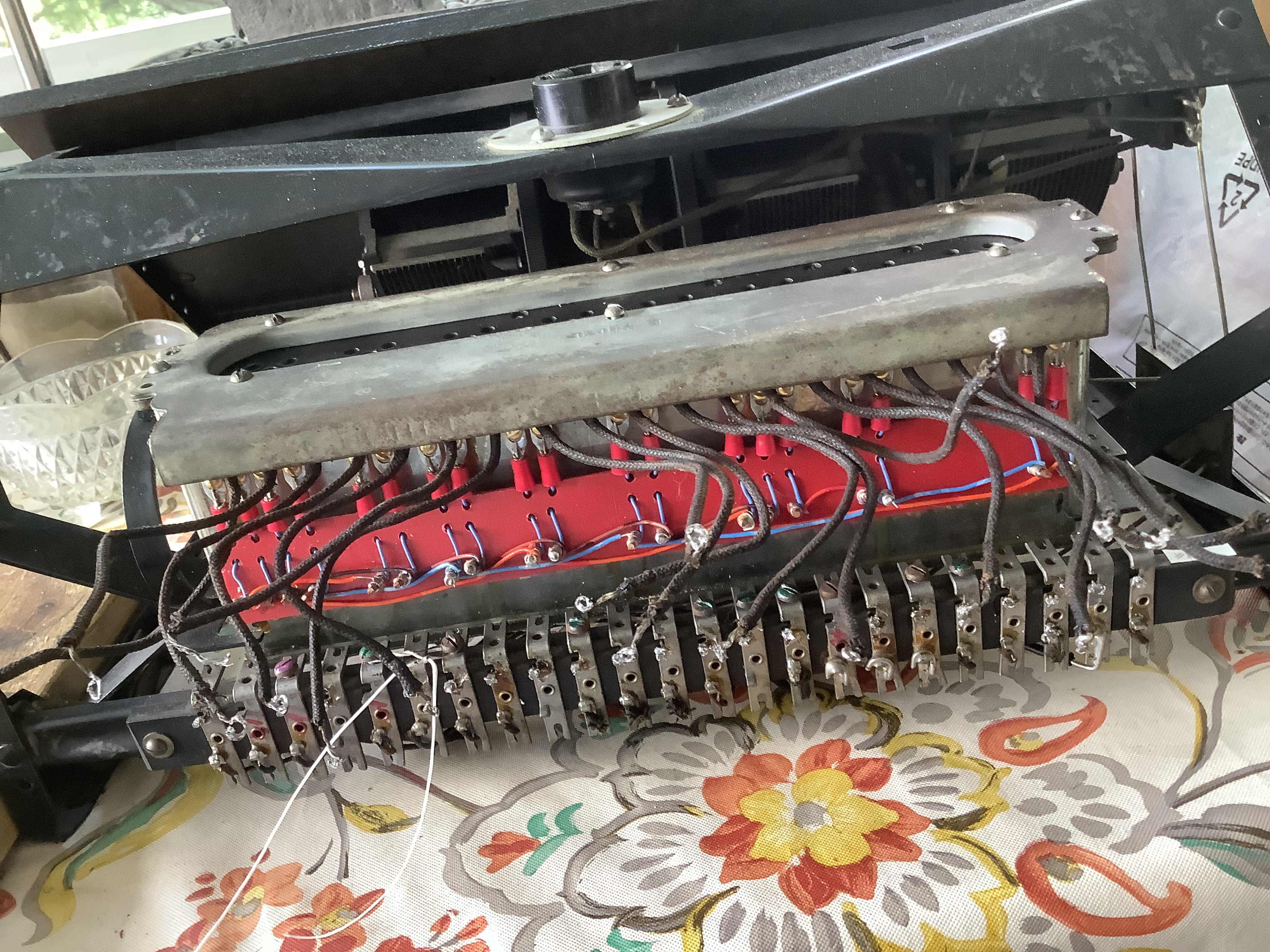

Sending a photo with the strip installed. I used #6 spade terminals and they are narrow enough to keep from shorting.
The transformerectomy and subsequent installation wasn’t bad.The most delicate part was getting the cloth insulation off the transformer leads. I ended up touching the wire with the soldering iron and then carefully cleaning the bare wire. If the bolts attaching the transformers to the frame are stuck just touch them with a soldering iron for a few seconds.

#6 O.K. but the screws were #4, so long as there are no shorts...
That's a great technique, a little heat and the rosin gives way...
