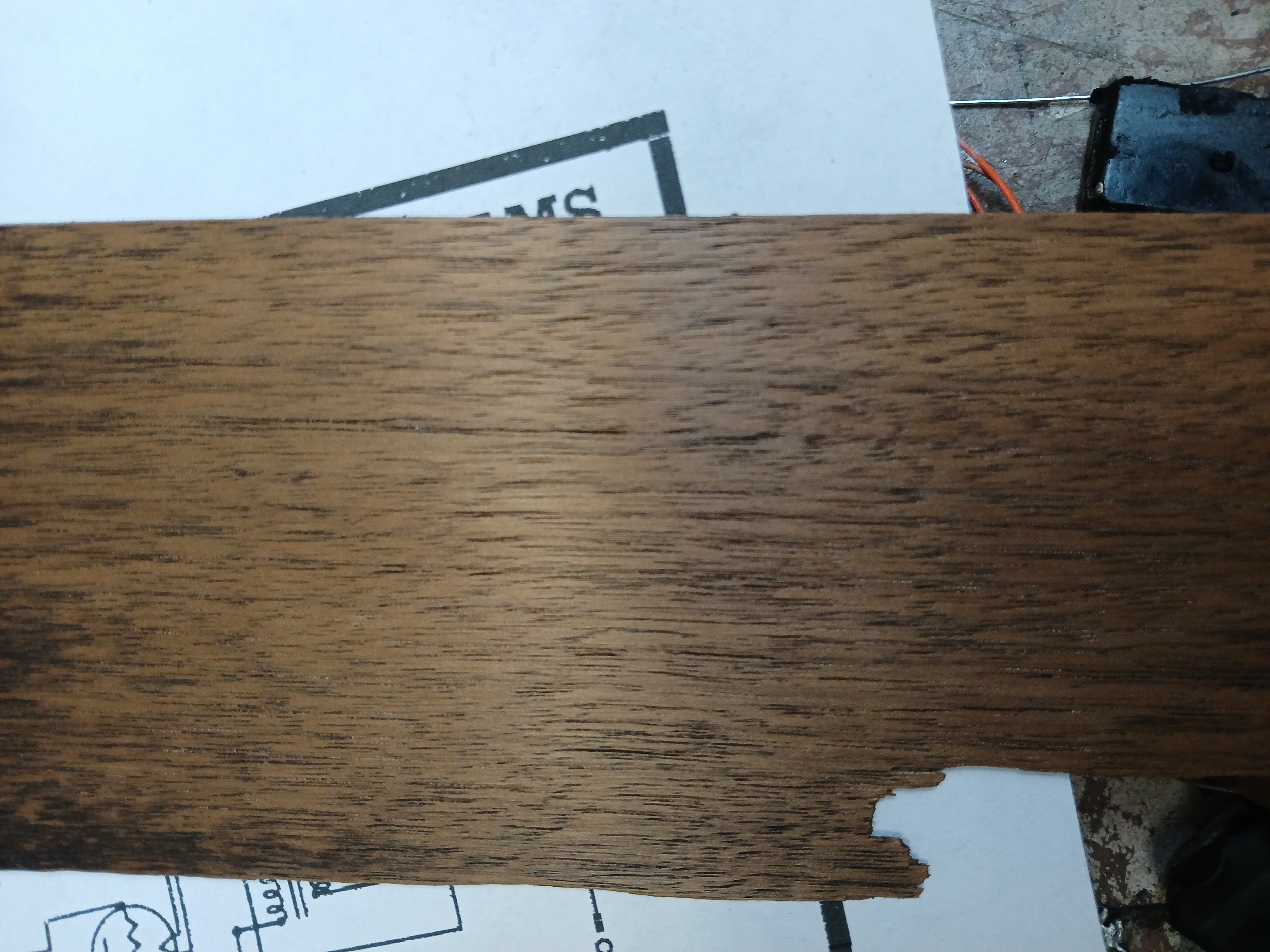

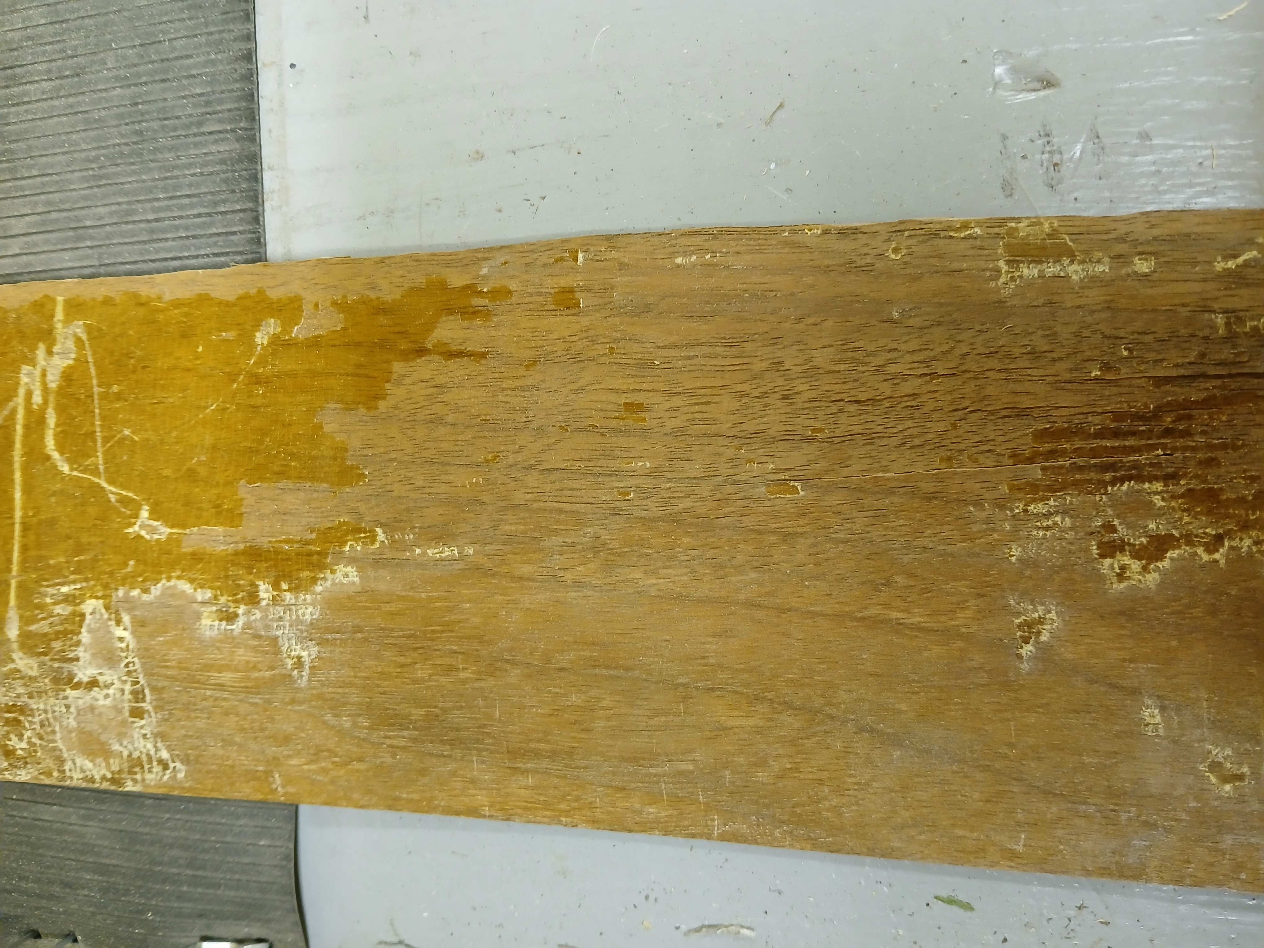

Here are some photos of the veneer.  The lighter shaded one  has had the lacquer scraped off.  The darker shaded one had the lacquer removed with thinner.
If anyone can identify the species of wood it would be a great help.  Thanks.

I am almost positive it is white or light walnut. Then stained or toned to the proper color.

I thought it looks most like the quarter sawn flexible veneer that Constantine's sells, but I wanted another opinion.  Thanks
The veneer in question looks like French walnut, but I think that the first piece looks light because of sun exposure. If these are off the sides of the cabinet, if it was like mine they are plywood panels that were slid into channels between the front and rear stiles or legs of the cabinet, and can slid out of the channels once the cabinet top is taken off. My model 96 was stored in a damp basement so the side panels were coming apart, so I just used some 1/4' plywood, they were also shaded dark so the species of veneer didn't matter, one side had walnut veneer originally, but I think the other may have been maple or poplar.
