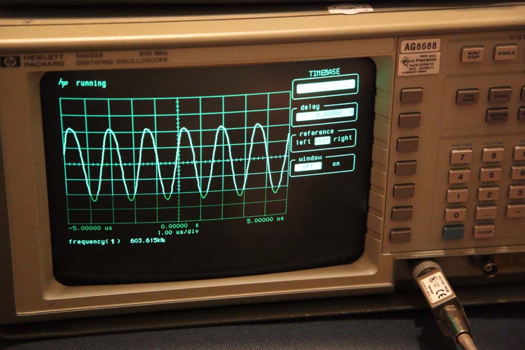

S'more:
100kHz
300kHz
600kHz. This is where distortion starts creeping in (who cares, It is RF)
And the frequency is pretty much accurate, what you set is more or less is what you get.

Is it just me, or do ALL the digitizing scopes have that 'grass' on the trace? A scope shouldn't have that. I just got in a Tektronix TDS 540B and it has that as well, along with a bunch of other problems. I'm very disappointed in it.. was hoping for a good scope to use on UHF ham gear. Now I'll have to go back to my 200 MHz analog scope.

Its the nature of the beast. All digital scopes store the trace as sequence of discrete voltage levels so you get the steps in the trace. If the A/D converter uses more bits for the conversion, the steps get smaller but are always there (quantization error). The raster scan display also contributes as there are a fixed number of pixels available horizontally so you have to display points on the screen in discrete steps. I guess the "bumpy" traces don't bother younger users as they are used to the digital type of display.
Personally, I love the clean waveform display of a good analog scope. I will continue using my older Tek scopes. The ones from the 60's and 70's are my favorites for trace image quality.

This is, first of all, a crappy scope. Its sampling rate is 20Ms at claimed bandwidth of 500MHZ. Which means that even if amp bandwidth should be adequate A/D converter is not.
At work while in Telecom I had a 16GHz 4 channel Tek with full software (eye analysis, all hystograms etc) - you should see the waveform, it is beautiful.
I also have a 1GHz GP Tek scope at work now, bought it 2 years ago, also a great scope. But then this HP is from 80s - it is about 30 years old.
I do not see todays good digital scopes being any worse the analog. If anything they are better. Their brightness is no longer dependent on the time base as it was the case with all analogs, and of course triggering is vastly superior so this hideous memory phosphorus that was in analog memory scopes is no longer needed. I grew up with analog scopes but once I tried a good digital one, I switched in a jiffy, no nostalgia at all.
