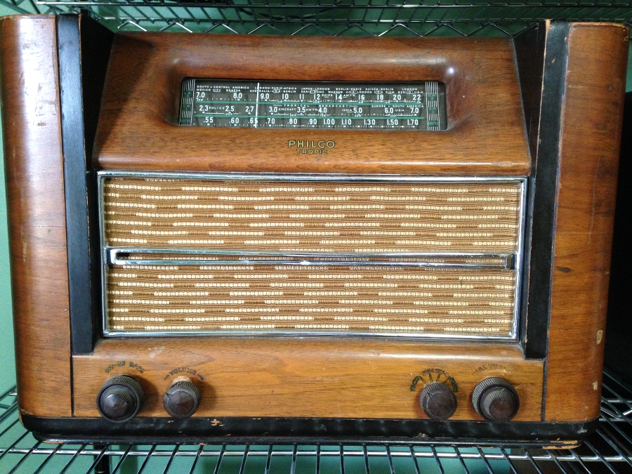

The end result - best that I could do.

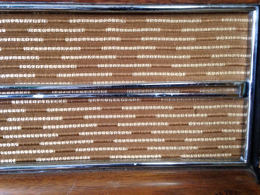

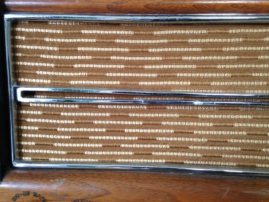

Close-up of the grille, left side:

Close-up of the grille, right side:

The Loctite Metal & Concrete Epoxy, in conjunction with the pieces of a small drill bit used as splints, is holding well. I guess it's OK for an amateur job. At least it's all back together.
How many Philcos have you seen with a chrome grille? This is the only one I have ever seen.

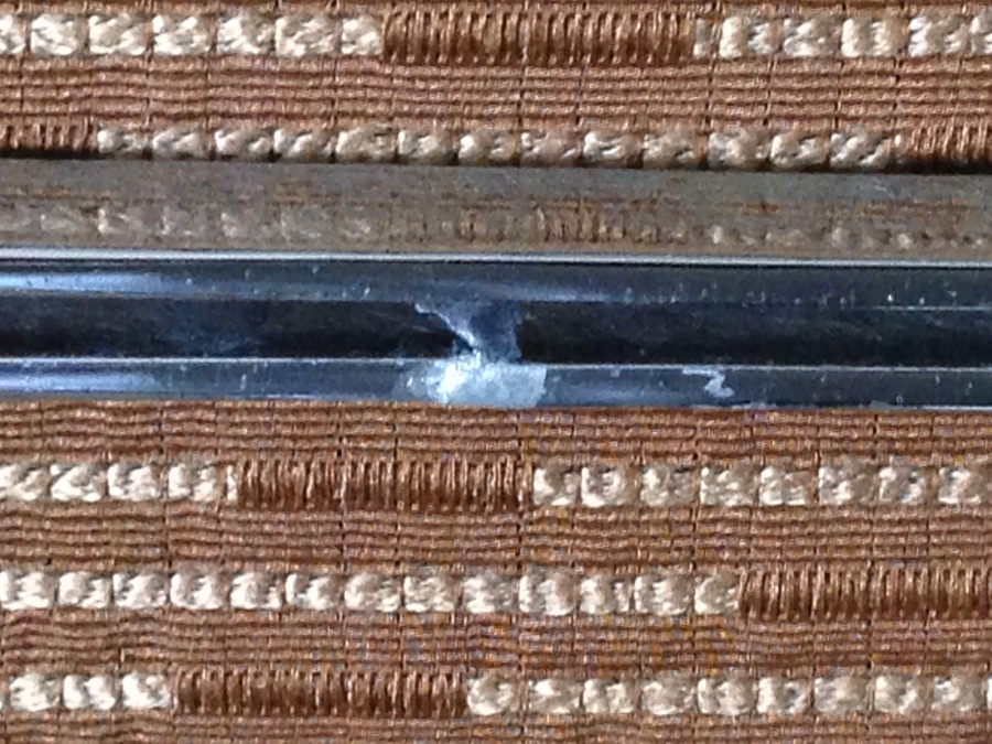

One more close-up, the center of the lower grillebar where I didn't get the two pieces aligned just right when gluing:
[Image: http://www.philcoradio.com/images/phorum...e00023.jpg]
Not knowing what else to do with the glue residue there, I touched it up with Krylon silver paint. Yes, it shows, but I think that is better than not having a grillebar.

Looks great Ron! Excellent work. I would've done the same thing with touching up with Krylon paint. If you would've tried to have it chrome plated, you'd run the risk of it breaking further or worse than before. It's obviously a very fragile piece to start.

Maybe if you tried some of that Chrome paint they sell now it would look a bit closer than silver... just a thought.
I thought about that. But I just wanted to get it back together and back on the shelf before anything else happened to it. I had Krylon Silver on hand, so that's what I used. It shows but it looks better than light gray glue residue.
Words of wisdom: On the off chance that one of you should find one of these sets someday, never, ever attempt to straighten out a grillebar if it is warped like some dummy did with this one (me).  The cast aluminum is very brittle and does not take kindly to attempts to straighten it.
You will notice that the top grillebar (unbroken) is warped a bit. And it can stay like that.
