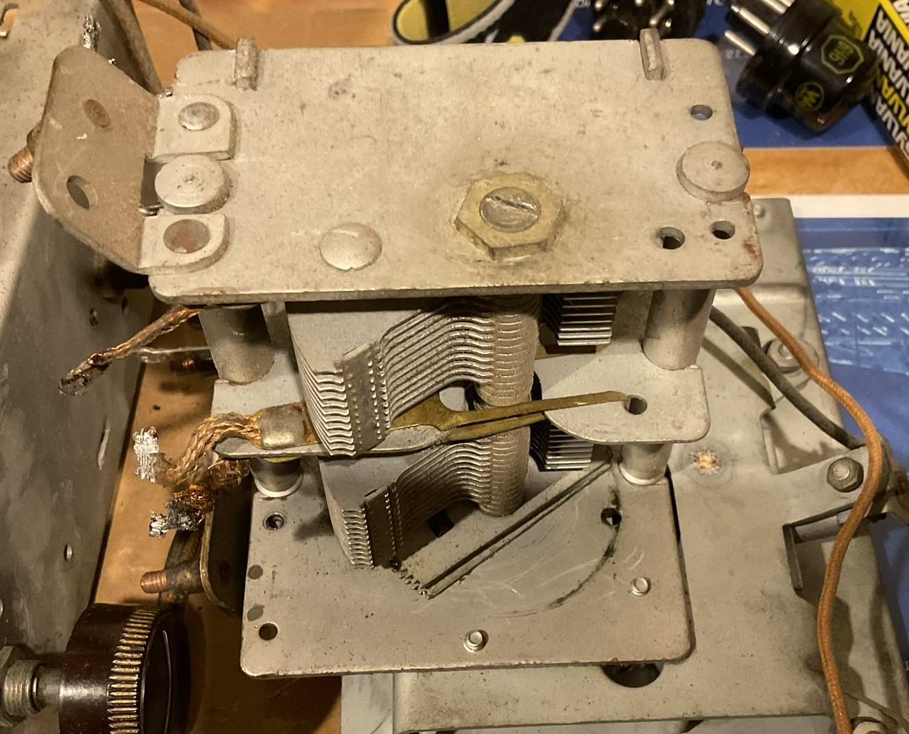

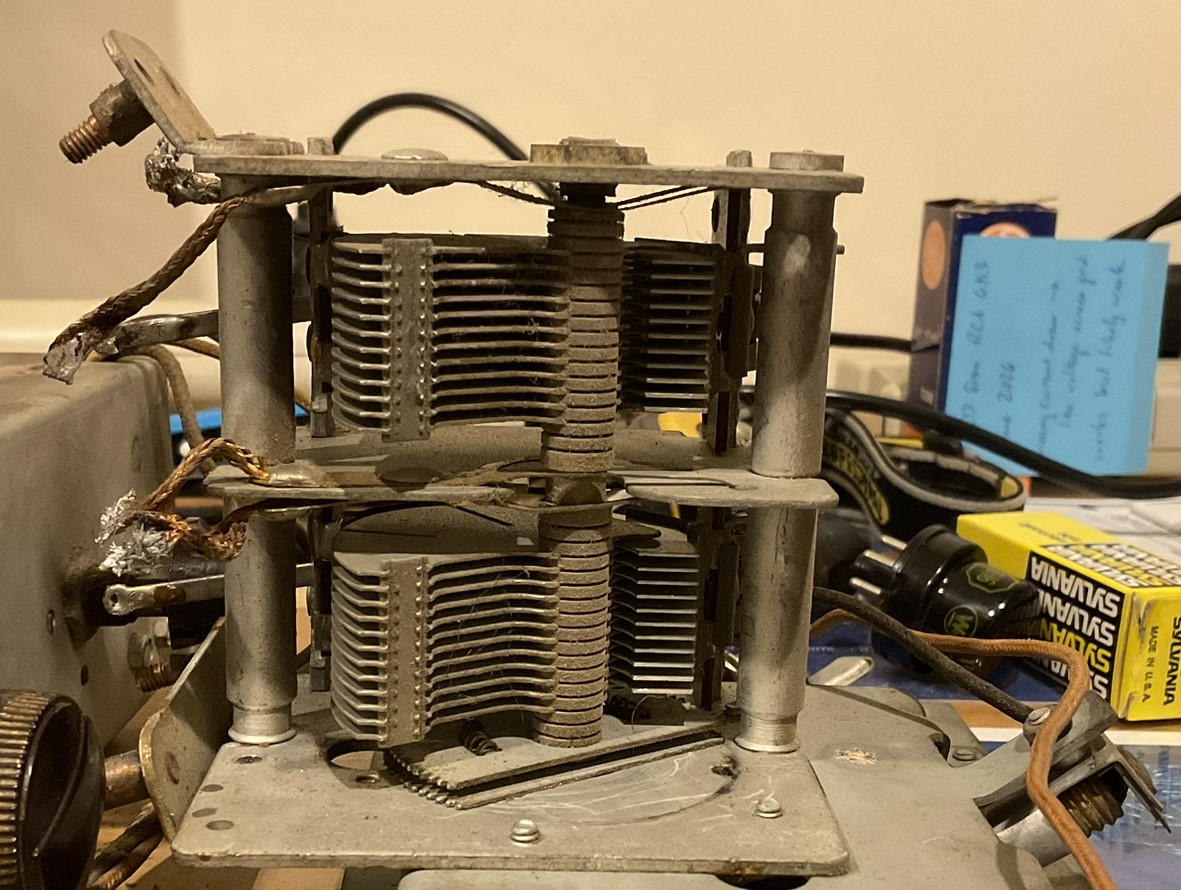

This is the tuning condenser from the side and back-ish. I don't think it has any ball bearings and that slot on the back is pretty darn stiff - doesn't feel like it wants adjusting. I'll pick up some lithium grease tomorrow and see where that gets me.
Best wishes,
Roy
Well, it is plain and simple dirty.
Personally I take these apart and give them dish soap bath in the first place. That plus the follow-up lube usually take care of all the moving problems.

Okay, getting into the more esoteric aspects now. I think, as Arran has suggested in another thread, this radio may have fallen over forward at some point in its past. Not only is there weird damage to the middle of some veneer, but Saturday I observed a crack in a piece of trim that would probably have inflicted the force that did it.
I've noticed three things in the chassis that make me think there was some serious trauma:
1 - one of the rivets that holds the tuning condenser to the part that mounts to chassis had popped and was loose - I managed to secure it a little bit with a judicious amount of force from some pliers, but not sure how that will do long-term
2 - the rotor blades are perfectly straight to my eye, BUT they seem to be off-center between the stator blades, as if the entire rotor assembly was jammed a fraction of a millimeter toward the back of the chassis; this was observable when I used some heavier stock paper to brush between them - one side very tight, the other loose by comparison
3 - especially on shortwave, reception on a detectable station is tremendously improved with the application of very slight pressure upward from beneath the tuning knob
Number 1 (loose rivet) doesn't concern me too much here, but Numbers 2 and 3 make me think there's more to be gained if I can straighten the issues out.

Roy, you may have hit in something (Sorry about the pun). The giveaway is the static that you receive as you rotate the cap. Go back and forth tuning. If you can reproduce the "scratch" at the same dial indication on all bands, there is your smoking gun.
Generally, the spacing between rotor and stator plates of a tuning cap should be consistent except for the end plates which have notches, that allowed sections of these plates to be bent for better tracking. Look at the cap carefully. There may be adjustments for centering the rotor and stator. Some sets have an adjustable bearing on the rear of the cap. Adjusting this may stiffen the cap but may push the rotor plates to a correct position.
Try to flex the tuner itself to see if this changes things. Flex the chassis in an area where the cap is not affected These techniques may help find intermittent operation caused by mechanical issues. You may be looking at multiple issues.
Many times, connections to the chassis are through rivets that may get loose and connect poorly. Good HiFi amps and even one radio in my collection have "Ground Busses", a thick wire where all "returns" are made. This bus connects to the chassis at only one point. Unfortunately, most mass-produced transformer powered sets don't work that way ("Warm chassis" transformer sets do have a "ground Mecca" centered around the 1st Audio tube.

Thanks for the tips. I did manage to adjust the centering with the rear set screw and this cleared up the sound across the band marvelously. But then it was back to being so stiff that the fine tuning knob on the vernier was just slipping like before. So today the dial came apart again to be able to squirt a little bit more lithium grease in the front bearing area, and then did the same by the set screw at the back. Got it back to a place where it could turn with ease and have the rotor blades centered nicely.
In the process, I damaged the shortwave band lamp. So looks like I'll need to pick up a #46 bulb.
I'm sure it goes without saying that adjusting the axial centering of the rotor did a number on the alignment and it's only receiving the local AM station at a very low level. I have a (hopefully) working tube tester on the way, so I'm going to try testing the remaining tubes (just to be have tested them all), calibrate the signal generator, and only then run one more alignment and this should mark the end of the electronic tweaking of this particular chassis.
