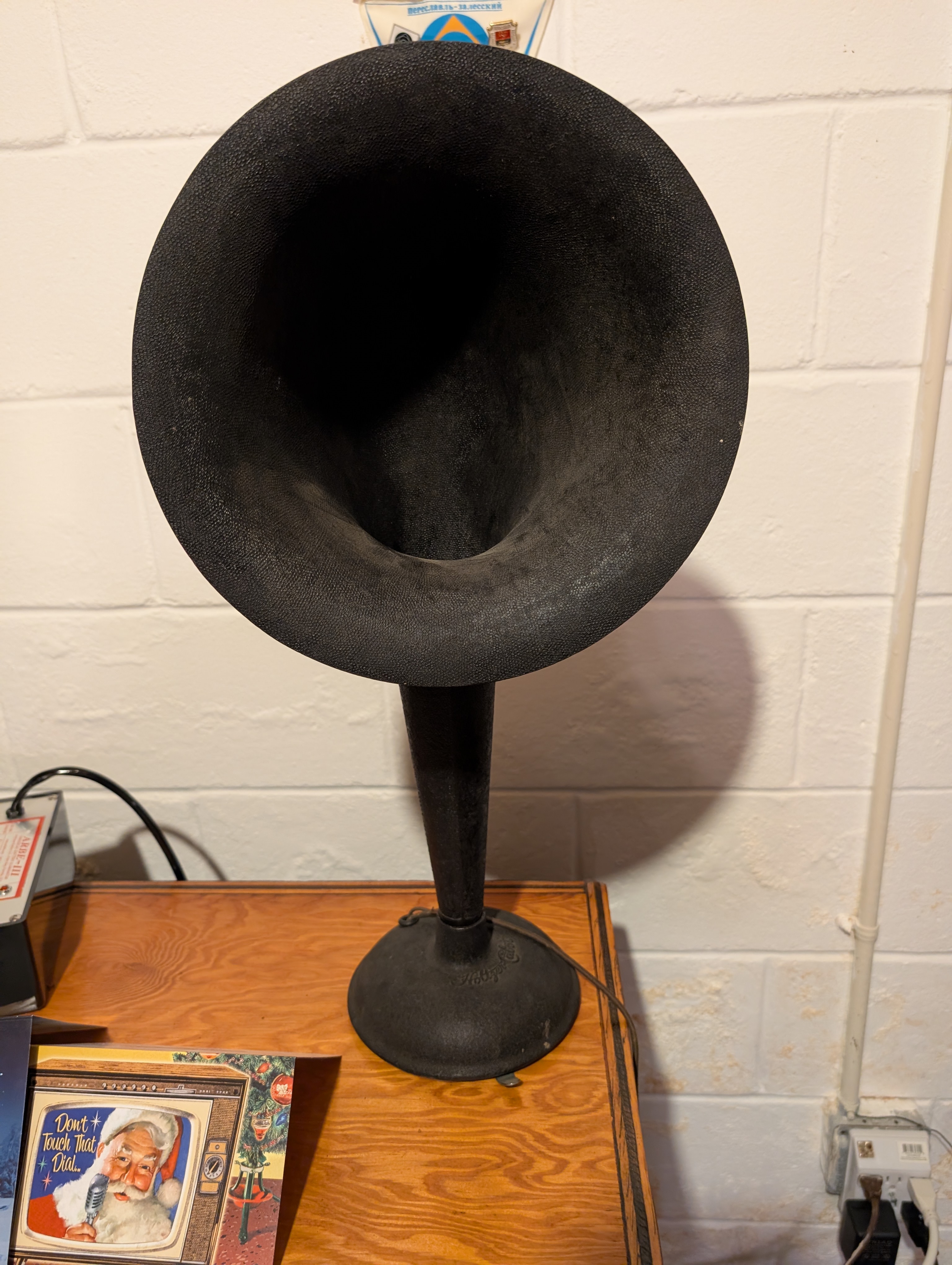

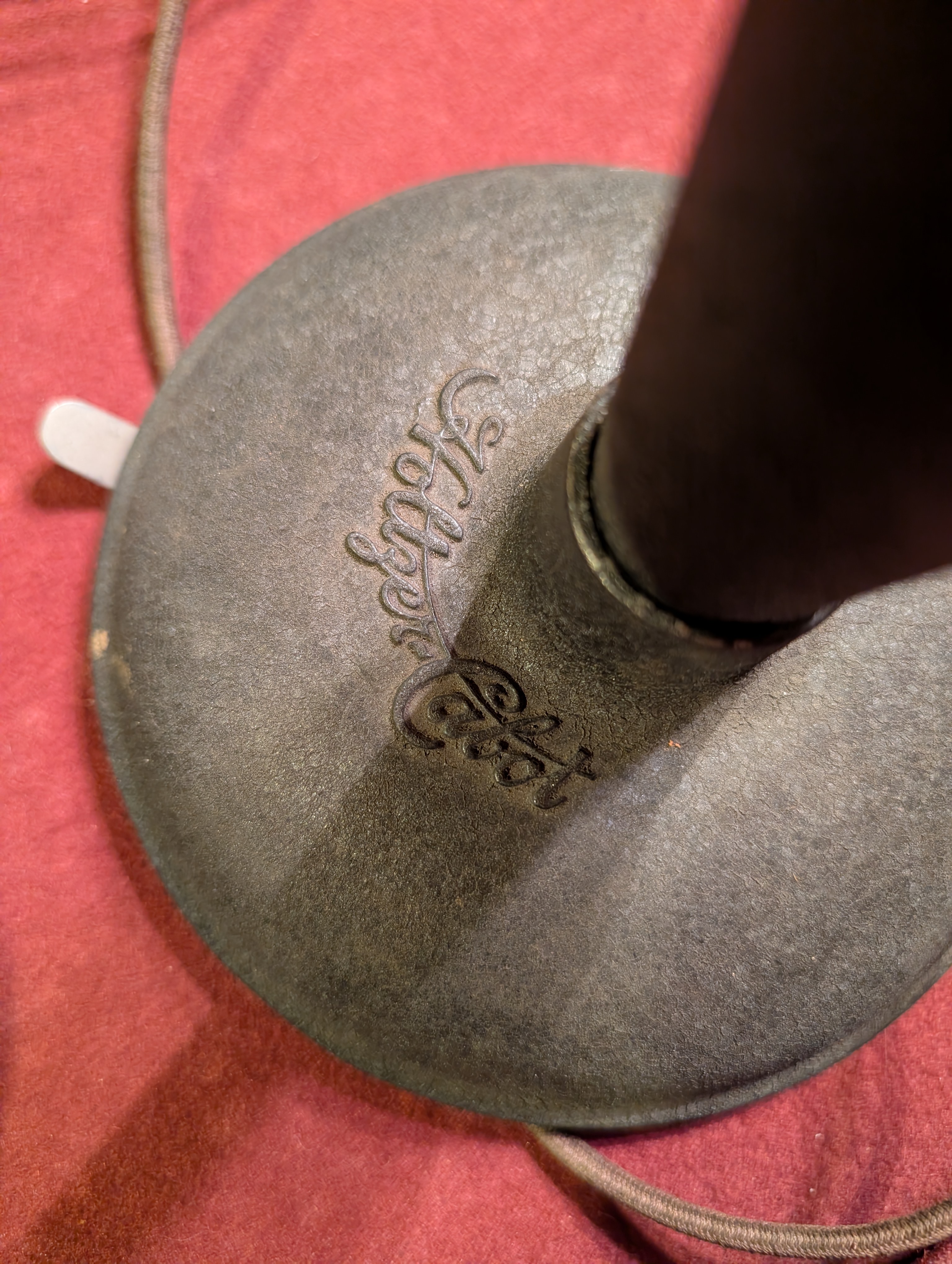

So, this here is the video of me playing the radio through the Holtzer-Cabot horn I bought.
Well, "E" is the clear winner of this competition, but then again, this is probably not the best horn and at some point, if i find AK's "M" or a classier horn with acceptable price (they were $350-750 from what I saw), I might get it then.

One thing to look out for on horn speakers are weak magnets in the driver, there is a process for "recharging" them, but I have also heard of some people simply placing rare earth magnets in strategic spots on the old magnets to strengthen them.
Thanks, good idea to try. I have tons of REMs.

I haven't bought a horn in years. Did get clobbered at a country auction maybe 30 years ago for a Burns black celluloid petal horn. But most have been either free or cheap, less than 25$. May look at some variation of Magnavox, but mine all suffer from wither open transformers or open voice coils. I have an ACME drum cone and two cast-iron cones one of the Galleon and the other a Castle. Mica diaphragm balanced drivers for horns are rather good sounding, such as Thorola. Beware of pot-metal failure if buying online. Insist on seeing all of the driver and that the diaphragm clearance adjustment is free working.

Quote:Are there any of the horn speakers that would sound at least comparable to the paper cone ones of "E" type
For tone quality probably not, but a good horn with a strong driver should have plenty enough volume for listening. Even a very cheap horn using a headphone driver had plenty of volume when I was messing with old three dialers. The key is a good strong driver. Play around with adding magnets to your new horn like Arron suggested.
