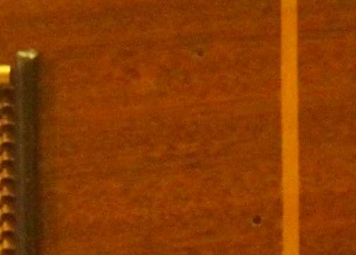

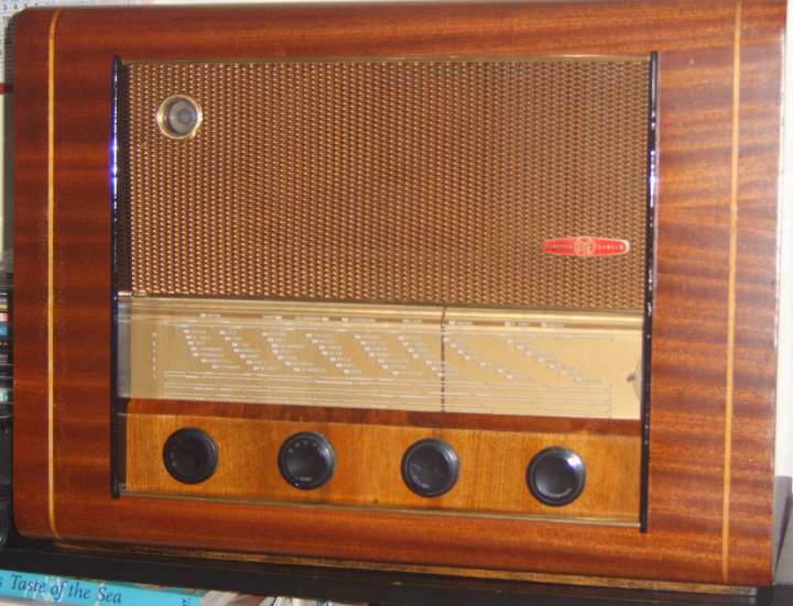

        Attached a Pye P74 I restored about four years ago.   It is from the family to me so has particular sentimental value. It was a gift to my parents from my godmother on the occasion of my birth.
Image1. shows it restored. Image2 shows flight holes which appeared two and a half years later. It had been well treated with woodworm killer and stored for months in a sealed bag.  There was no indication of infestation prior to restoration but it had been stored in a shed before being passed on to me which did have a piece of furniture which was infested.   I am convinced it picked up eggs in that short time storage environment.   Point is, the eggs obviously survived the treatment to emerge two and a half years later. Maybe the treatment got some or a lot of them.   I don't know. But I do know it did not get em all.
