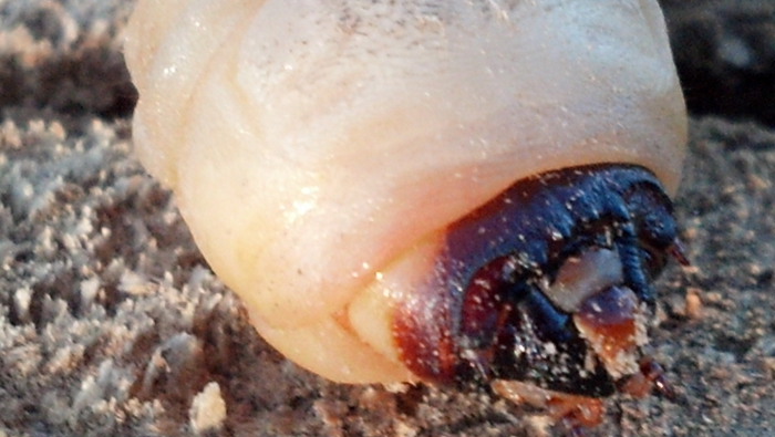

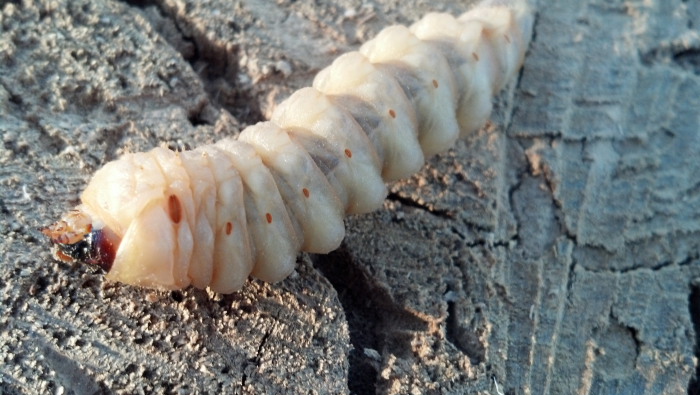

This one is about 2- 3 inches long, out of a Ponderosa Pine. Throw a little butter and garlic on the plank before you put it in the MW.

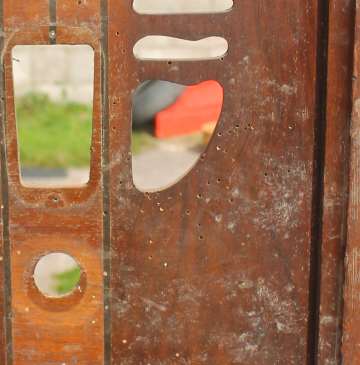

I have a Philco which I am very much excited about restoring. It is full of these things. I want totally rid of them and their offspring.
Help me out here guys. MICROWAV. ?
Icon_e_sad  Look at this.
Wow Icon_eek
