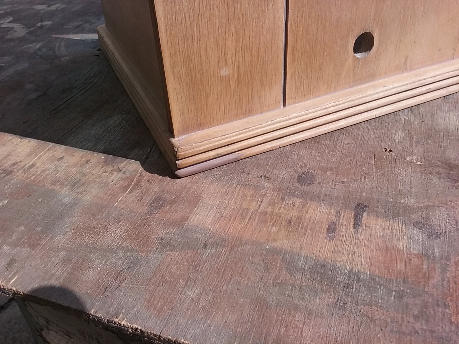

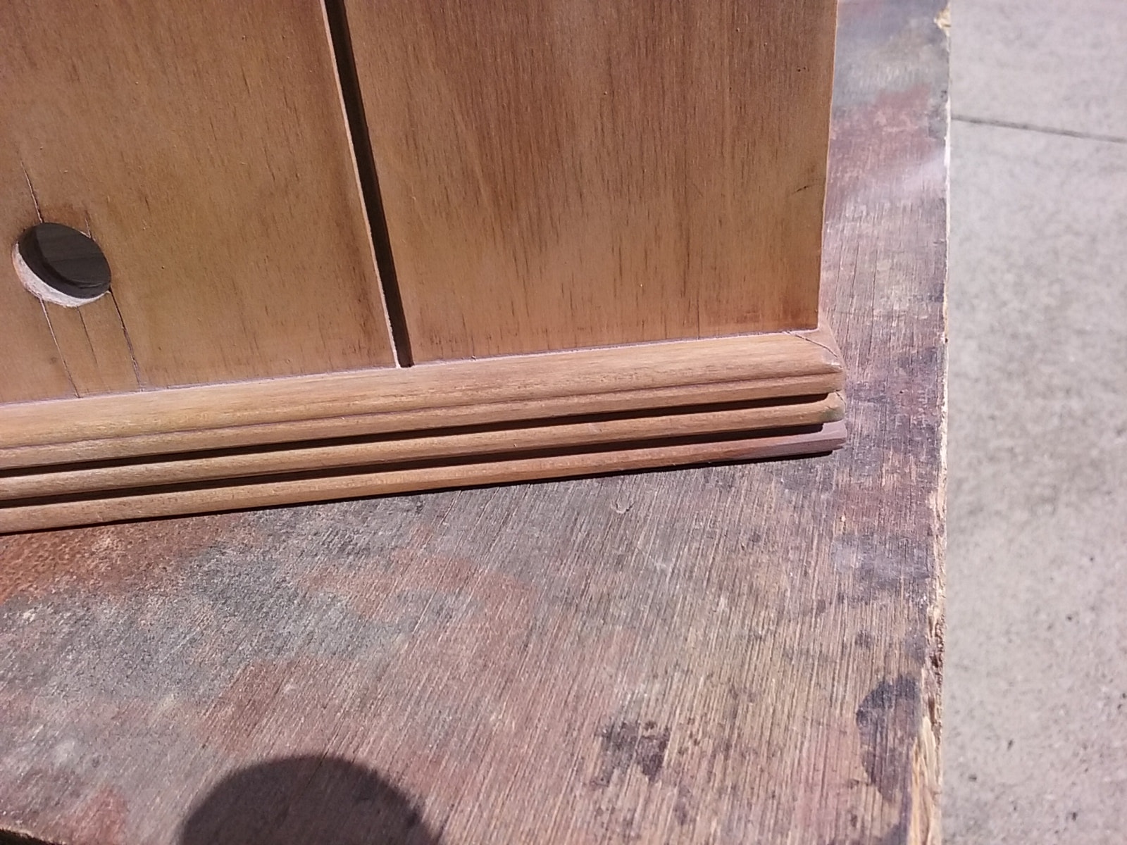

Terry, you indicated to "just fix it", did you mean repair or replace the messed up areas?
Thanks, Bill
Posts: 7,323
Threads: 270
City: Roslyn Pa
Sorry Bill,
I mostly hang up in the electronic side of things. Yes I meant to repair the missing layer of plywood (patch) and use some filler on the trim edges to remove the dings. Since you have it stripped and all it's a good time to do these repairs. How's the chassis, up and running??

I would replace the trim with new if you can get sme from Steve Davis.

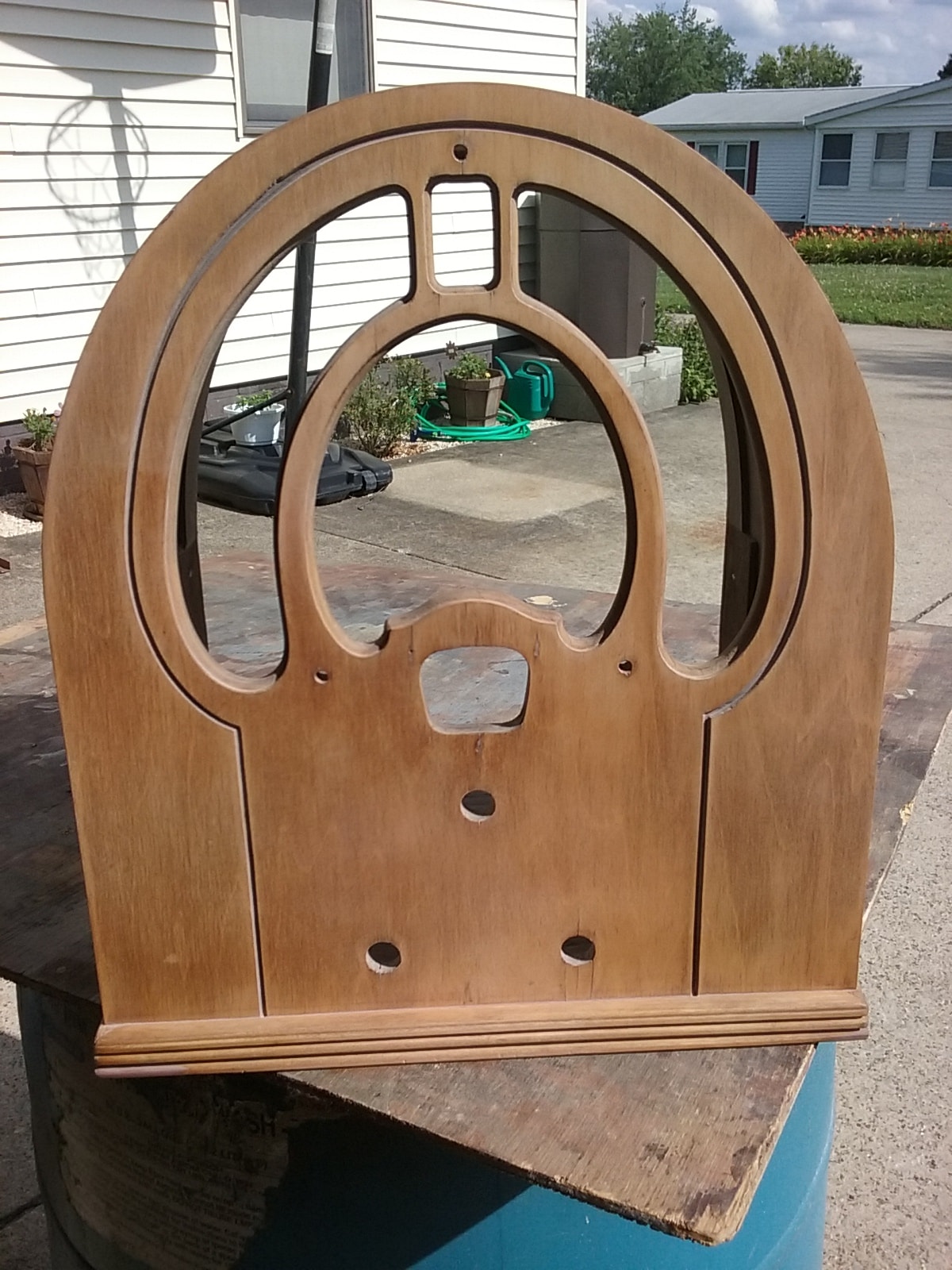

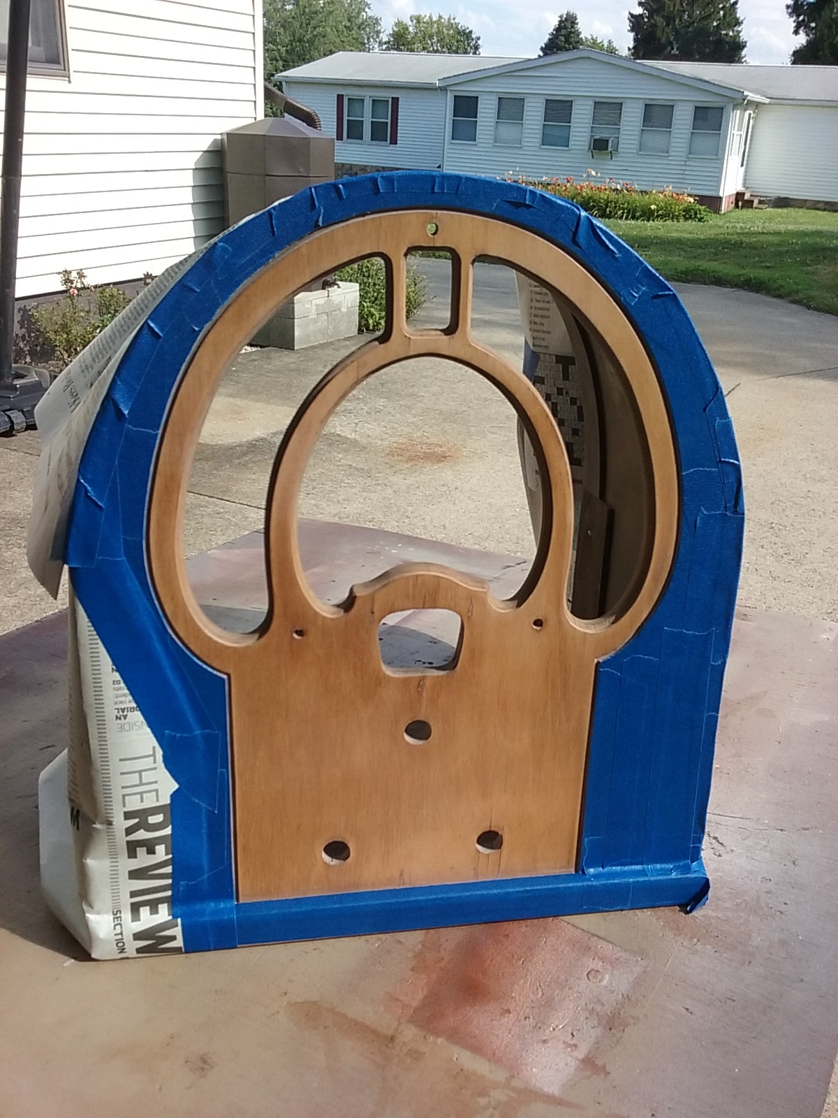

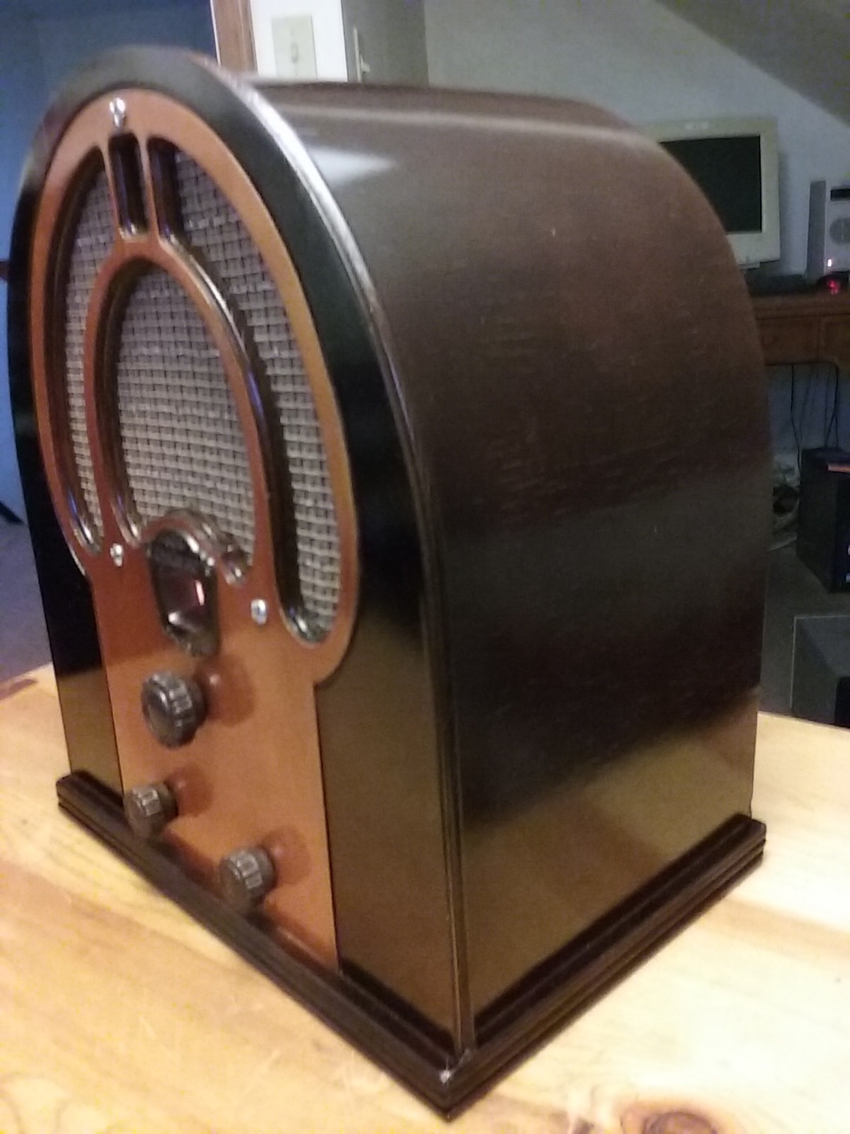

I have finally gotten all of the Cabinet repairs done and am at the point where I am able to apply the toner. I actually did the center part yesterday.
Does anyone have any tips on how to tone/color the small sculpted areas next to the grille cloth? In the pictures that I have seen, it appears to match the outer section (Perfect Brown Ultra Classic). I was thinking of trying to do it with a small brush and some of the Perfect Brown toner.
Any suggestions are appreciated.
Thanks, Bill

I've done them a couple of ways. I've taped them off and spray toned them the color I wanted after I had toned the face. I've painted them with Americana acrylic paint which dries flat but after you spray the clear gloss layers its gloss. And if I recall correctly...and that could be a stretch...I think Fred Taylor described spraying the edges the color you want before working on the face, then sanding the face which takes the tone off the face and leaving a clean edge. Then tone the front which will be lighter than the edge and the lighter tone doesn't affect the edge color. (I've not done that and can't locate the thread at the moment.)

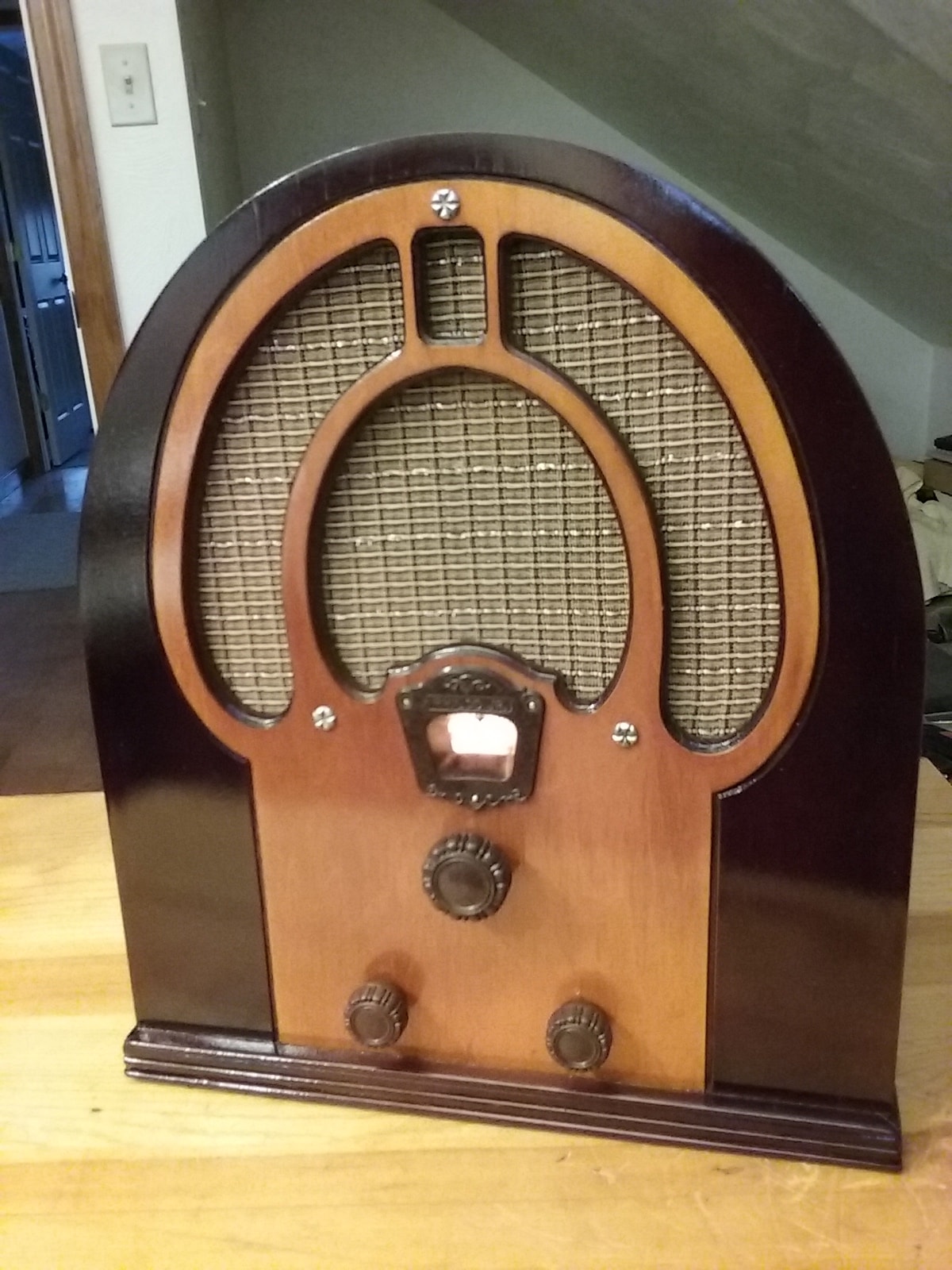

Nice job.  I've been unhappy with how the grain has turned out on some of my refinishes and usually just live with it. Again, nice job.

I think you did a very good job repairing the damage to the corners of the base. And the finish looks really good. Maybe you should work on the veneer lifting around the controls. But one thing stands out; where did you get that grill cloth?

Very nice!!
a reproduction of the original small herringbone style cloth is being sold by Kenneth Richmond

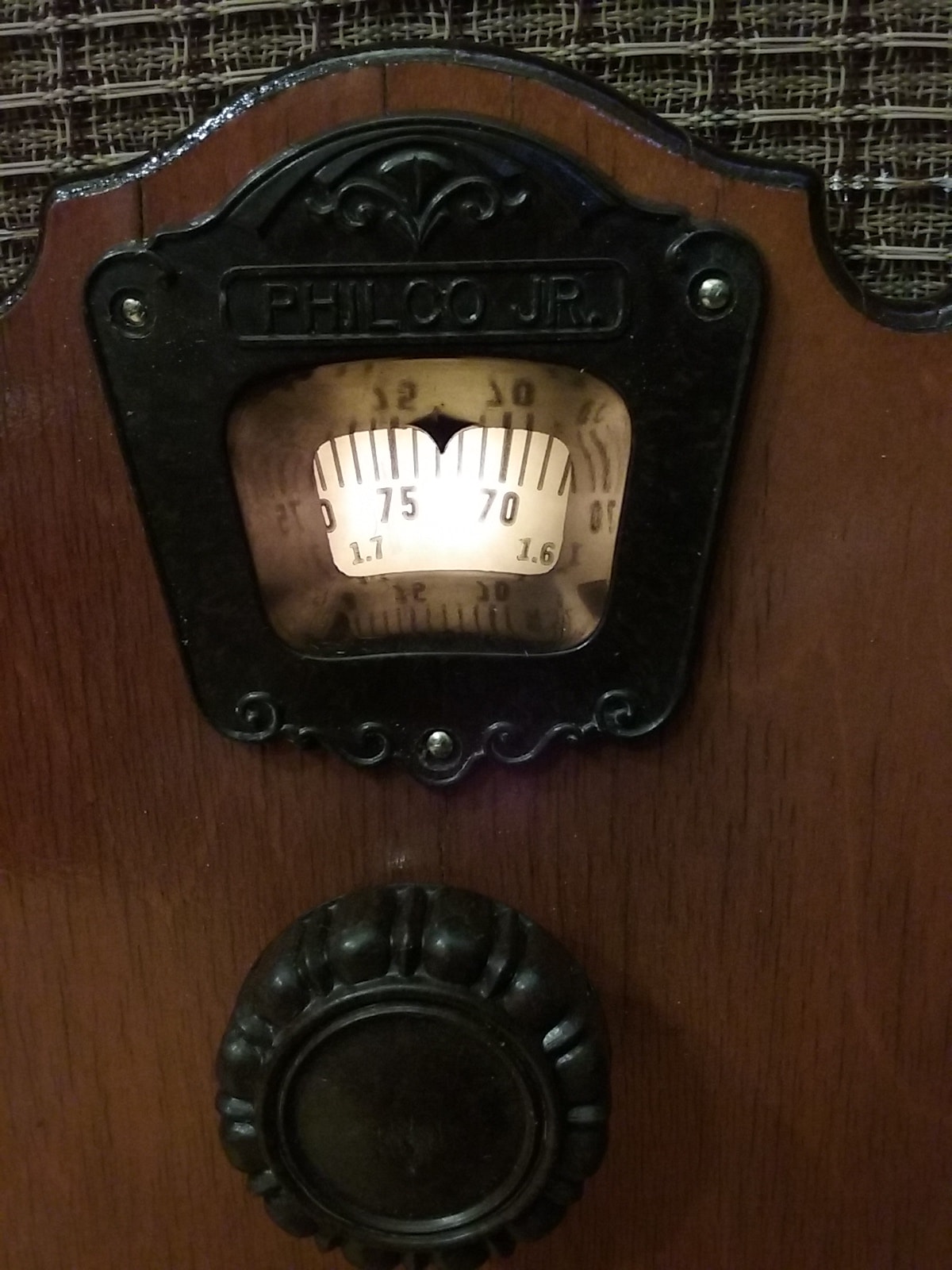

OK,,were did you get your NEW dial at,,,being it is Police band also…CHEERS

Both the grill cloth and dial are original. At least as I received it. Does the grill cloth not look correct? The dial does have some wear and a slight warp, but in general is in pretty good shape.

The 81 had a police band so I think that the dial might be correct. I don't know if its a reproduction or an original though...
The grill cloth is not original to the set. The original was a small herringbone pattern that can be seen (sort of) in this gallery photo: http://www.philcoradio.com/gallery/1933a.htm#h
Its now reproduced and sold by Kenneth Richmond as I mentioned earlier.
Bob is right. That cloth looks like it may have been original to a set of Bozak E-300 speakers (mid-late 1950s) or an old guitar amplifier, but is not correct for a Philco 81B.
Kenny's small herringbone pattern is a perfect replacement for the Philco 80B and 81B.
One more thing. You should remove those speaker screws and spray the heads with some Extra Dark Walnut. They were originally very dark brown.
