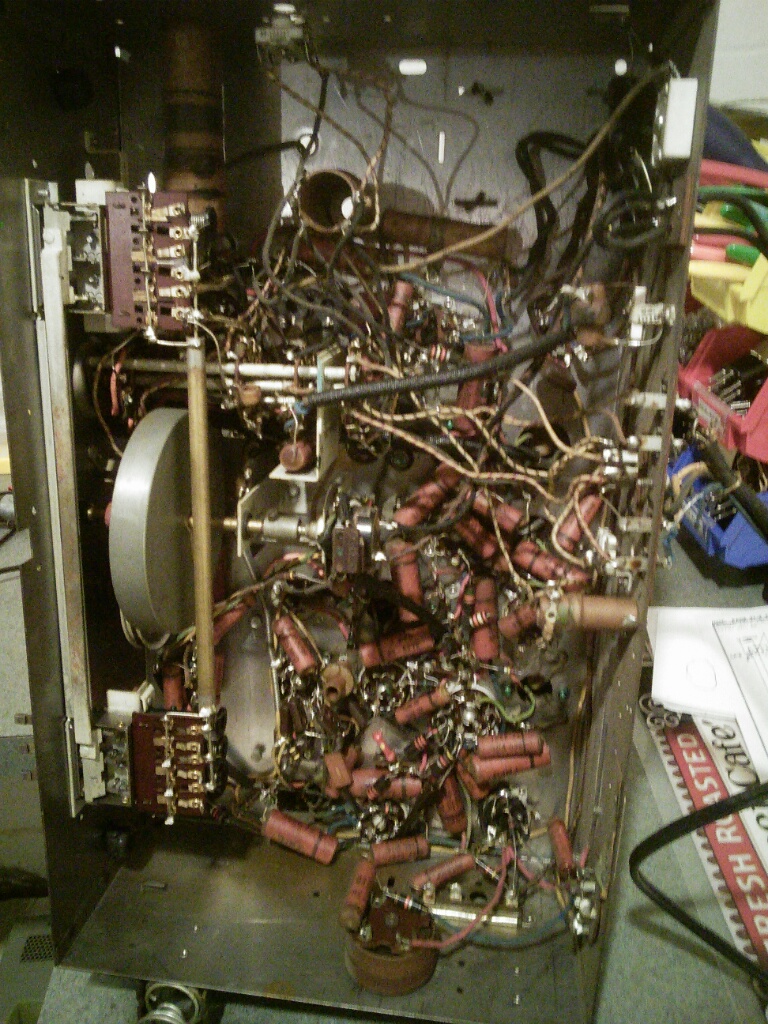

The photo with the FM shield removed. I can see how the recap is gonba be fuuuuuhnnnnnn ......
As for the initial check, well, as expected, the Candohm is bad. Not open, but 100 ohm (or close) section is 1K. The 12 ohm one is 25.
The 5Y4 tube is dead. The filament is open.
Most (all exept one) loctals tested dead first but I got suspicious with the black pins, scraped them with a scalpel and all tested good. So all tubes are good except the rectifier.
Nathan, you wouldn't by chance have the underchassis diagram?
Wow - that sure is a lot of capacitors! And nicely layered too.... Icon_eek
I'm afraid it's only those two pages in the service manual - Zenith doesn't seem to provide under-chassis diagrams for the models (at least of that era).
I checked Riders and Beitman's too - but those are just schematics too. That being said I think the schematic from Beitman's might be a bit clearer - attaching that too in case that's useful.
Yeah....looks like a tube caps lasagna. Or ramen noodles.
I think 37-116 has less caps.
Holy caps Batman! Icon_eek  That has to be the most un-Zenith like underside to a Zenith chassis that I have seen so far! One thing I have always sort of admired about Prewar Zenith radios is that they are usually pretty simple under the chassis. My late friend (who always complained about Philcos using too many caps) could rebuild an average Zenith in fairly short time, even with those belts needing replaced. The only issues he ever had was with the Robot Dials which he said was like taking apart a robot to clean things and replace the tuning belts. Maybe I don't want to find a Spinet after all... Icon_think
Yep, there comes that monent in every restorer's life when he stands there over a chassis from H**l and asking himself if be bit a bit more than he could chew. A 37-116 was that first one for me. This is the third. The AK808 was the 2nd.
Maybe I'll walk by mine another year after seeing that. Icon_lol  Looks like at least 25 paper caps.
I need to look under an unrestored 10 tube Zenith again, but I swear that looks like they just had a case of "Ah to h*** with it!" Just grabbed a wad of capacitors and jammed them in there. That just looks like a sloppy mess under there.
